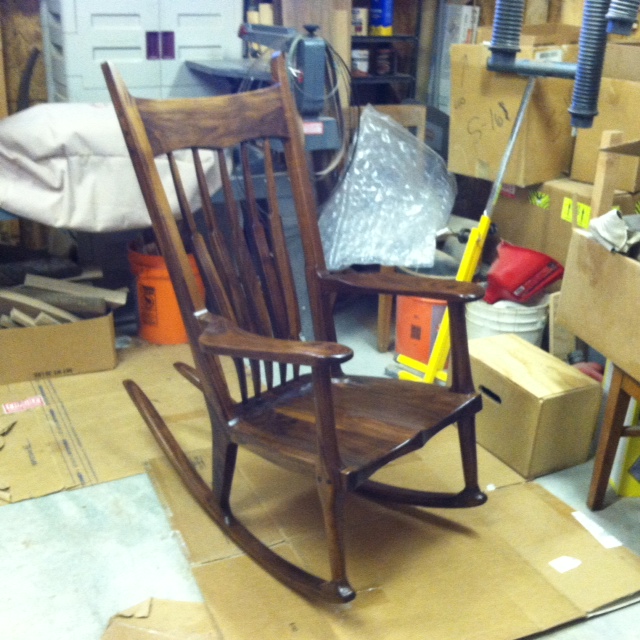

Here are the photos taken since the rocker is done. YEA! Done. In the finishing process, finally the time to quit has arrived, :D
Yes, after staining the first coat, I found some glue spots not discovered earlier :mad: . More sanding and more staining over the sanded areas.
This is the frontal look at a sitting chair
finished chair front.JPG (175.95 KiB) Viewed 2778 times

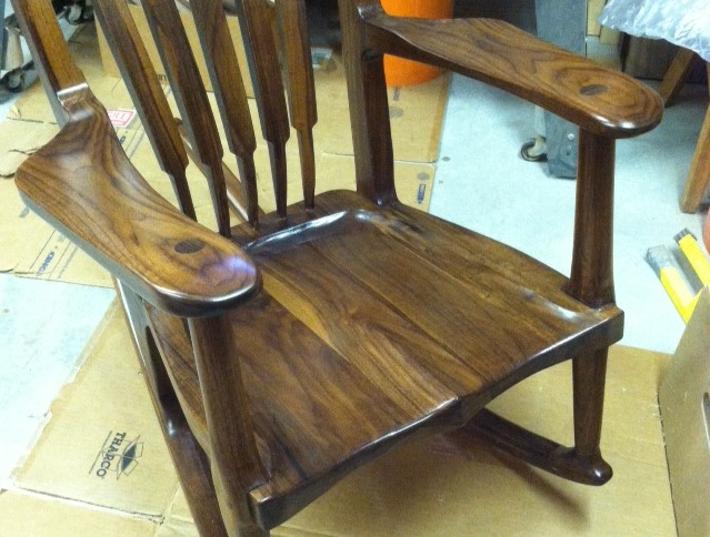

Closer look at arms and seat
finished view of seat & arms.JPG (109.75 KiB) Viewed 2778 times

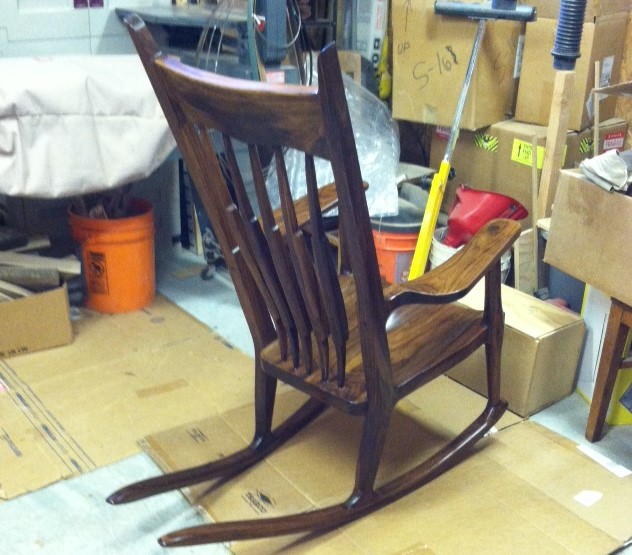

rear view of finished rocker
finished rocker back.JPG (114.8 KiB) Viewed 2778 times

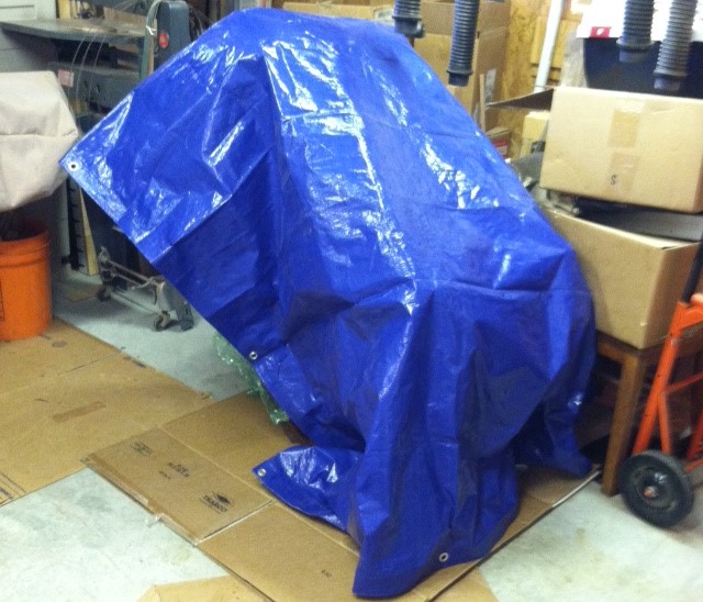

Rocker in Storage.JPG (117.57 KiB) Viewed 2778 times
Yes, it is a crowded shop - You should have seen it before I got rid of some stuff.

Wow, wow, wow, wow! Beautiful work!
EDIT: Showed this to my wife and she is very impressed, too!

Charlese you have just taken my breath away. That is perfection! You sir are a master craftsman, whether you acknowledge it or not ....
Very Very well done!

Chuck, that is one GORGEOUS chair.
I can only aspire to that level of craftsmanship.

Beautiful!
Were those arms sliced from the same piece of wood?

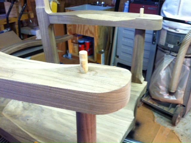

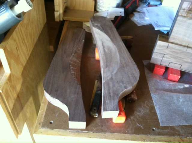

The arms were bandsawn from the same piece of wood. Black walnut, planed to 1 3/4" thick. The slopes of the arms were somewhat sliced off by bandsawing at an angle. After mounting, they were ground down with an angle grinder equipped with a "kutzall fine doughnut disk.
As you can see, I did a better"slicing job" on the right arm than the left.
Arms with bandsaw slices
arms with bandsawn shape.JPG (118.32 KiB) Viewed 2711 times
P.S. The blank for the seat can be seen to the right of the arms. The squared marking for the right front leg cutout is at the bottom of the blank. The short mark between the bottom two boards shows the location of a biscuit joint.
attaching arms.JPG (123.43 KiB) Viewed 2711 times
