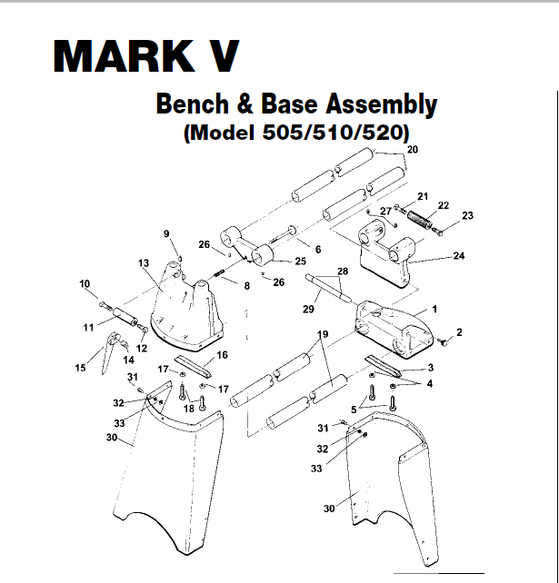

I dont know used the term legs, I would call them aprons.
Re: spray paint match for repainting a "greenie"
"Legs" are the steel parts. They set on the floor and the casters are attached to them. Apparently they are 'dark' green originally. I think the carriage was originally lighter. Is that what you referred to as a rest?
Shopsmith parts breakdown calls them "Legs."ERLover wrote:I dont know used the term legs, I would call them aprons.

Could that be because 10Es don't have legs. Notice Item 30. They really are "legs".ERLover wrote:I dont know used the term legs, I would call them aprons.
- Capture Mark V Legs.PNG (38.08 KiB) Viewed 3468 times
- Capture Mark V Legs Detail.PNG (93.16 KiB) Viewed 3468 times
