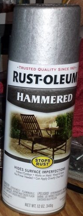

How about the grey paint?
Re: spray paint match for repainting a "greenie"
Rust-Oleum 12-oz Silver Spray Paint
- Silver.PNG (200.89 KiB) Viewed 12232 times

Realize the original paint was indeed very close to the hammered appearance although the colors are not 'exact'.
