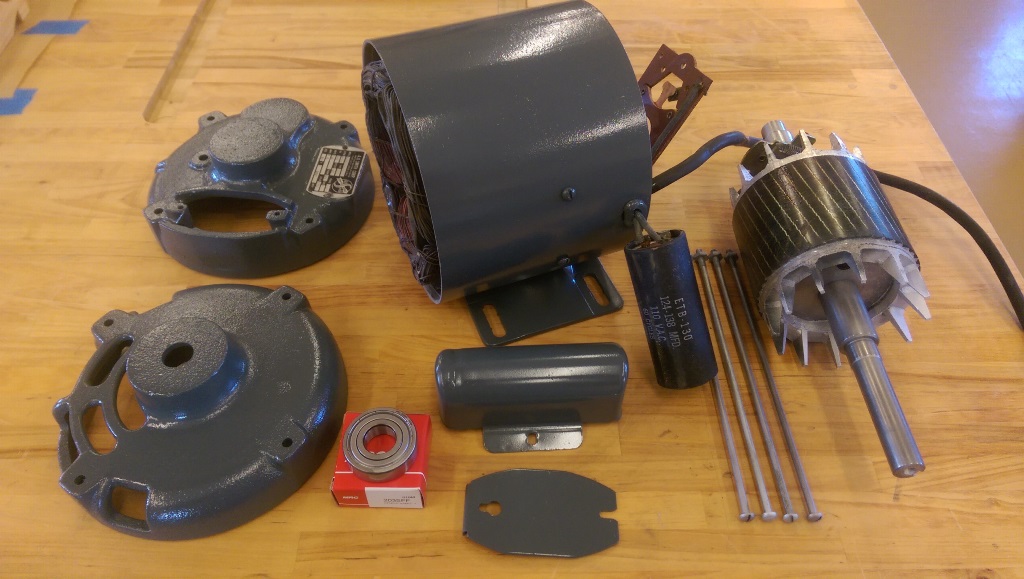

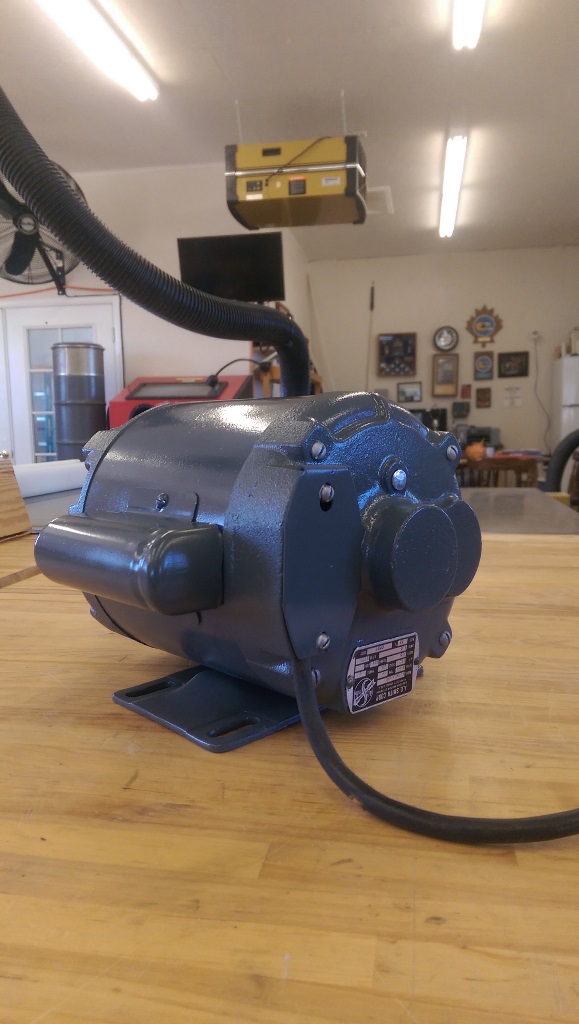

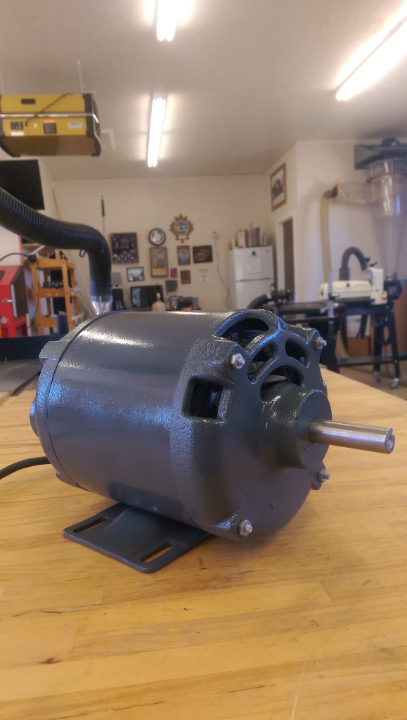

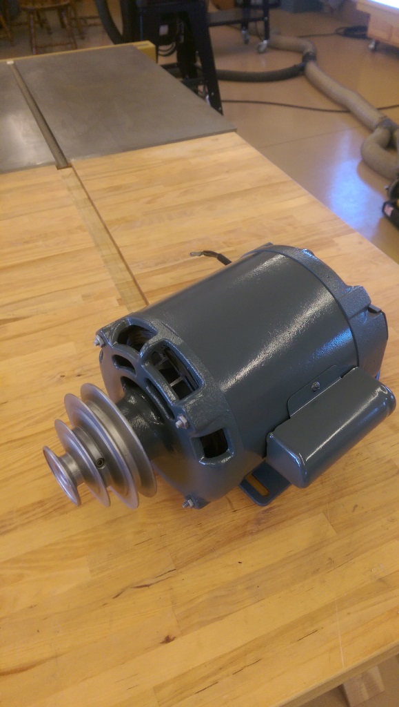

The motor stator housing is painted and the motor is back together with new OEM bearings. I also burnished the start winding switch contacts.

Re: Restoring 10ER S/N 83974
That looks better than new. Enjoying this thread even though I don't have an 10ER.

Geez! Now I have to go paint a motor etc.!
Well done!
Well done!
Thanks guys it has been a lot of fun. More fun on the way. I have 4 more here.

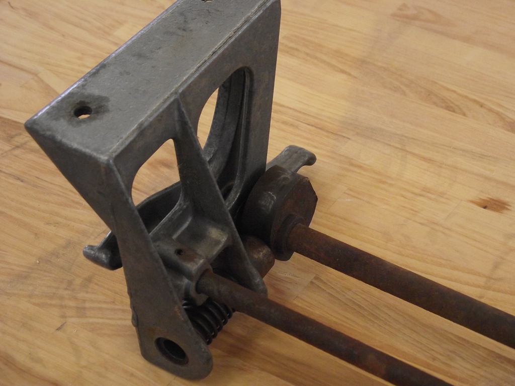

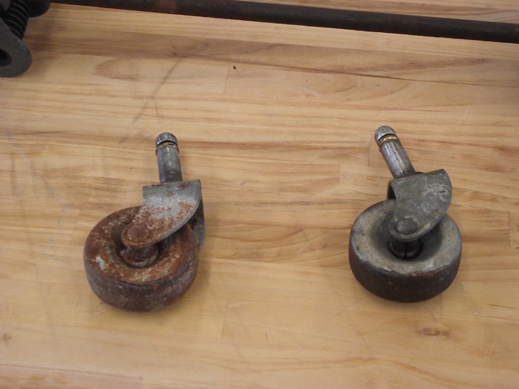

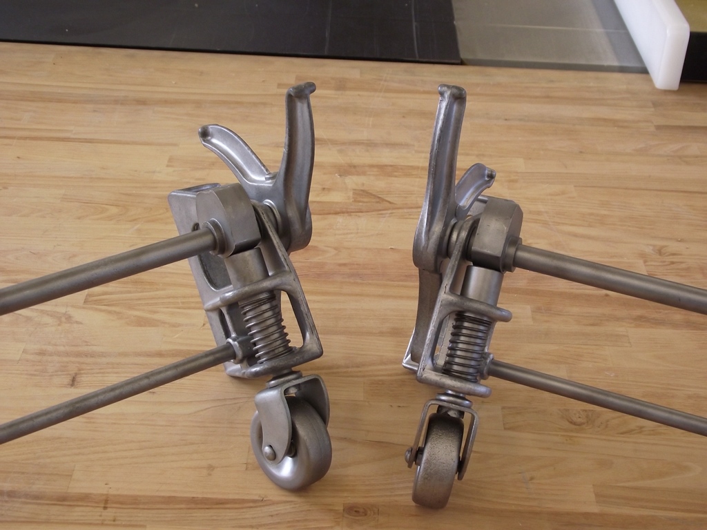

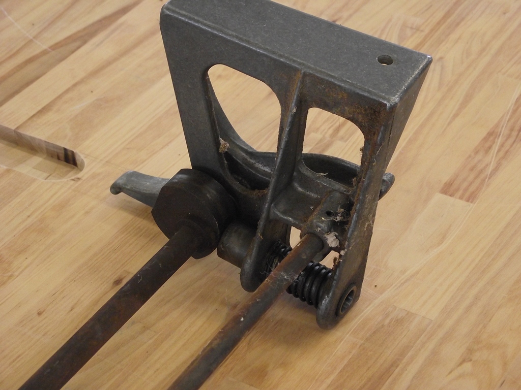

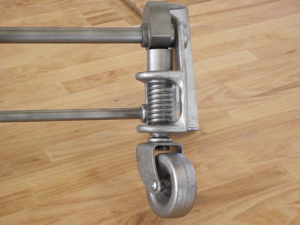

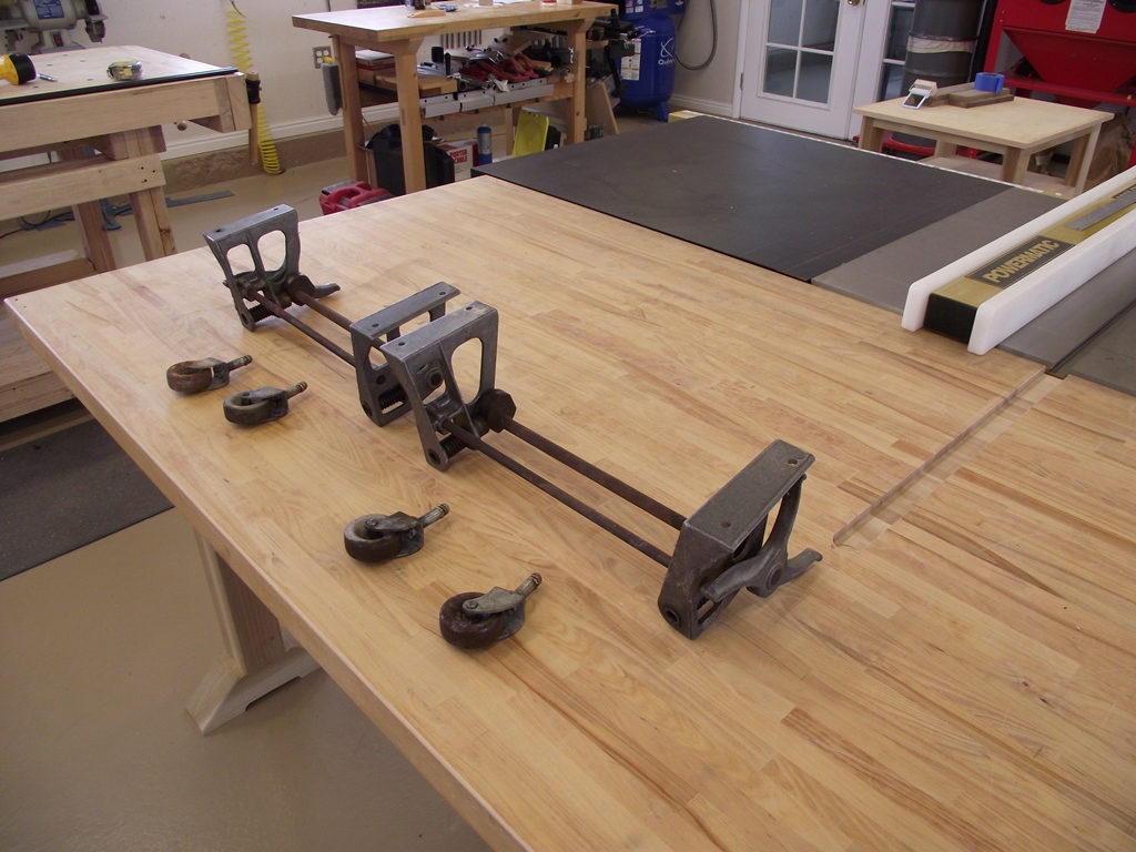

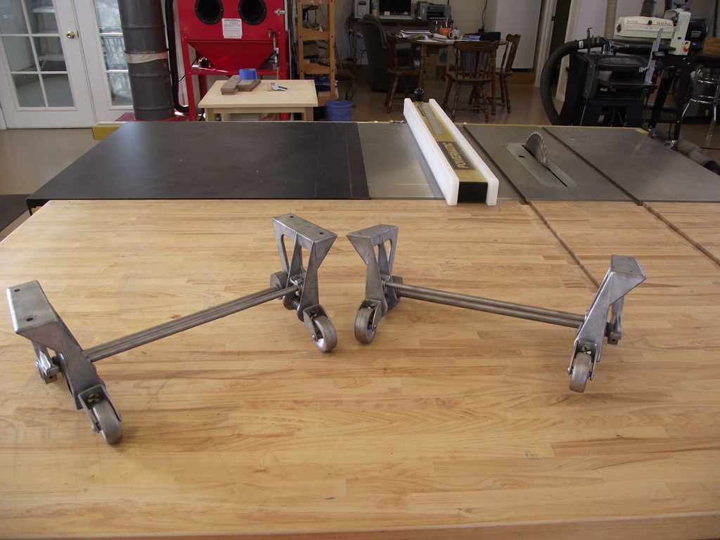

Here are the castors. They were completely taken apart, sorry no pics of that. One thing to know, when you remove the roll pins mark all parts to go back together exactly as original. Including the 180 degree orientation of the two rods. They are NOT drilled all the same. Don't ask me how I know.
I do not need to ask!
BTW, did the foot pedal retaining pins have 'through' holes? Mine were in a blind hole.
JPG wrote:I do not need to ask!![]()
- Posts: 35598
I drilled through the center of the tension pin a small hole all the way through. Used that hole as a pilot/alignment and drilled from the opposite side up to the inside end of the pin. Then drove the pin through.
Documented somewhere here(way back when).
