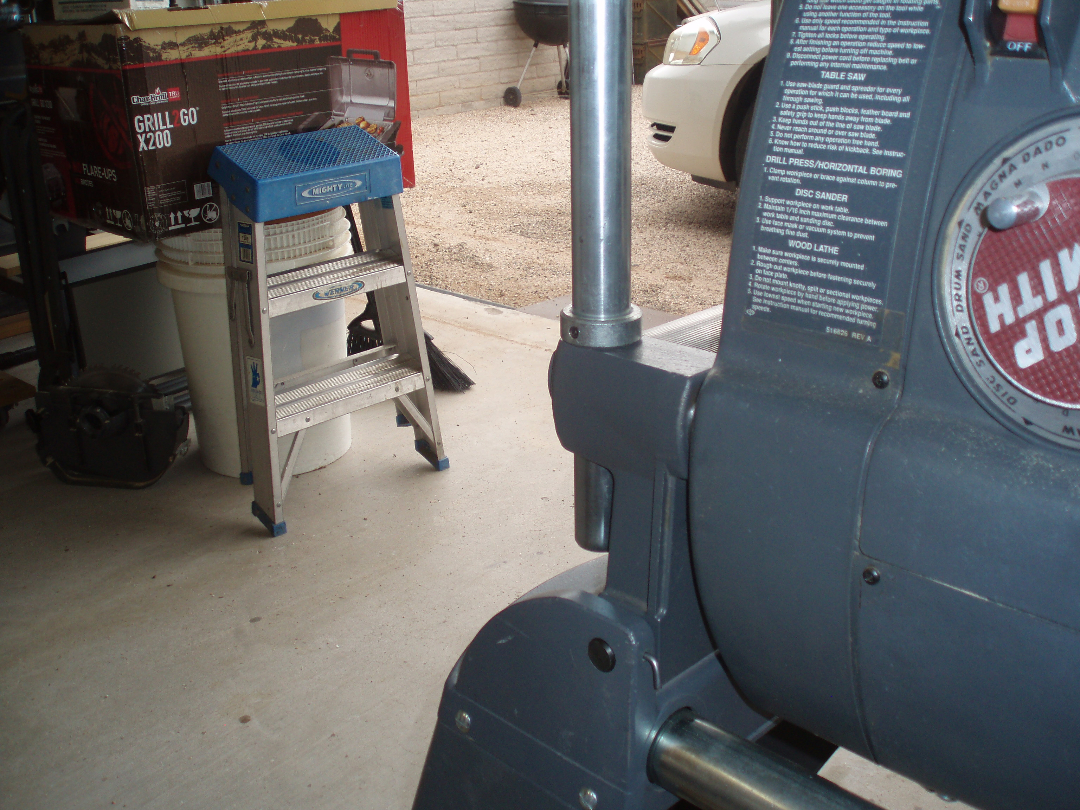

Somewhere in this discussion, it was asked if the face of the end castings were square to the Way Tubes. They ARE NOT. The face of the castings lean inward a very slight amount.
This image is of the Base Arm Assembly that I installed in place of a Headrest. If I must tilt the Way Tubes (to remove the Headstock as an example), I can pull the pin and lift.
- No Tilt Headrest.JPG (1.19 MiB) Viewed 1858 times

Thank you, but I was not clear!dusty wrote:I could tilt right if I was to drive the roll pin out so that I could pull the pin but I don't plan to do that.JPG wrote:IMHO the 'weak link' is the ignoring of the proper function of that set screw and incorrect headrest clamp adjustment.
No question in my mind the Double tilt base castings can provide left-right more consistency. Add the relocation of the way tube set screws to the top(where they are on the '10' BTW) and twisted way tubes becomes less likely.
Since you now have both versions on a machine, could you verify the bench tube to way tube vertical spacing is the same? I assume it would be, but that is not necessary!
BTW tilting right should still be possible with no modifications.

Re: Truing, As Best You Can, Shopsmith Table Tops
dusty wrote:Somewhere in this discussion, it was asked if the face of the end castings were square to the Way Tubes. They ARE NOT. The face of the castings lean inward a very slight amount.
This image is of the Headrest that I installed in place of a Base Arm Assembly. If I must tilt the Way Tubes (to remove the Headstock as an example), I can pull the pin and lift.
Looks to me like you replaced the headrest with a base casting.

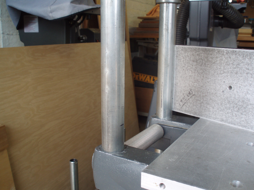

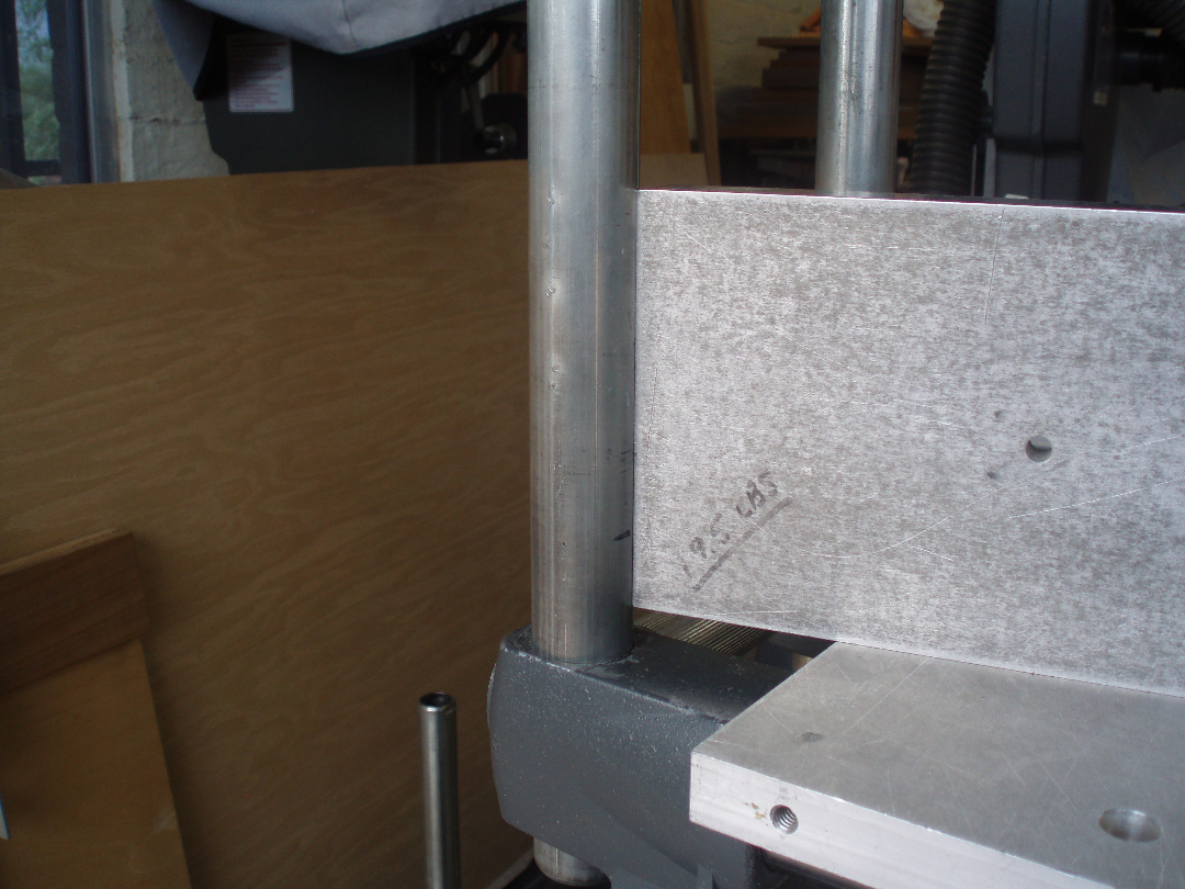

These images are of the Extension Table Legs on the operators right end.
Notice that they are not perfectly perpendicular to the Way Tubes (very slight amount of light toward the bottoms).
The aluminum blocks that I am using were milled special for a test project many years ago. They prove to be very useful for projects like this. I trust, without checking, that they are within a couple thousandths of being square.
I could post similar images of the left end but that seems redundant. On my machine, the left side as right on (no light gaps).
PS: It turns out that these two aluminum blocks are NOT perfectly square. The small gaps that were shown here are the result of that. The Extension Table Legs are dead on (90°s to the Way Tubes)..

Corrected Text!! I installed a Base Arm Assembly (504145 & 5041453) where there had been a Headrest (514530).dusty wrote:Somewhere in this discussion, it was asked if the face of the end castings were square to the Way Tubes. They ARE NOT. The face of the castings lean inward a very slight amount.
Thank you, JPG.
