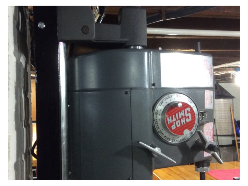

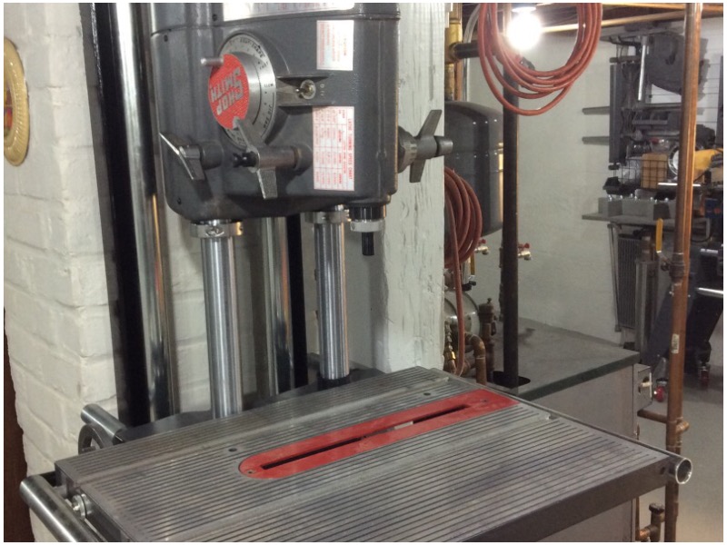

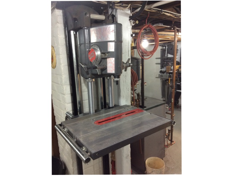

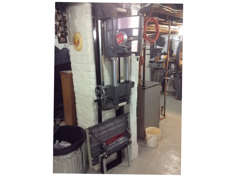

I am guilty.robinson46176 wrote:There are thousands of us on this forum and no two of us have the same shop, working habits, goals, what we enjoy, wallets and on and on...![]()
That is part of what is so great about this hobby / craft.
Some of us are forced to admit from time to time that we are more about the shop and tools than about woodworking.![]()
After following this thread a some thinking about the shop, I came up with the following with some spare parts. Not because I had to, but because I could.
- image.jpeg (97.24 KiB) Viewed 5825 times
- tomsalwasser
- Posts: 928
- Joined: Mon Feb 08, 2010 2:09 pm
Re: Free Standing SS Drill press
Nice work cooch, thanks for sharing this! I would really like to see more pictures and details of your black frame. I like how you attach the base castings directly to it. I was concerned about the strength of the casting in this position so I was not planning to do it this way, but perhaps I should reconsider based on your results. It's sleek.cooch366 wrote: After following this thread a some thinking about the shop, I came up with the following with some spare parts. Not because I had to, but because I could.![]()
