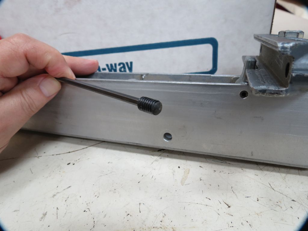

BTW If you had cup point screws in the base, THAT was the problem all along. They should be flat/oval point.
Cup :( or serrated cup :eek: points will scar the rail.

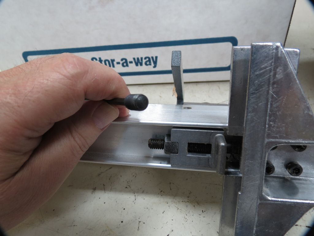

Don't know how you got the wrong screws but you did. I checked the three rip fences I have and they all have the oval points. The one is from the 1976 new from the factory one and another is from the updated fence that I got just after they came out and the third is from if I remember right a 79 or 80 that I got used.
I know it doesn't matter to you at this point but for other readers the set screws should look like this:
Given you have the wrong set screws I have to wonder what other issues your fence might have. Do you want to review more of this or should we just drop it?

I've never found them in a hardware store in my area. I either get them by ordering from shopsmith or by grinding a cup one into a round. I haven't tried to get them online but I'm sure some place must sell them.
Let us know if you find them local and what store it was.
