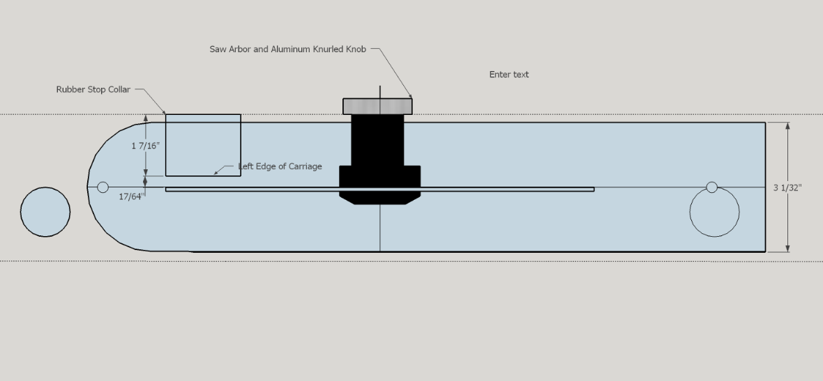

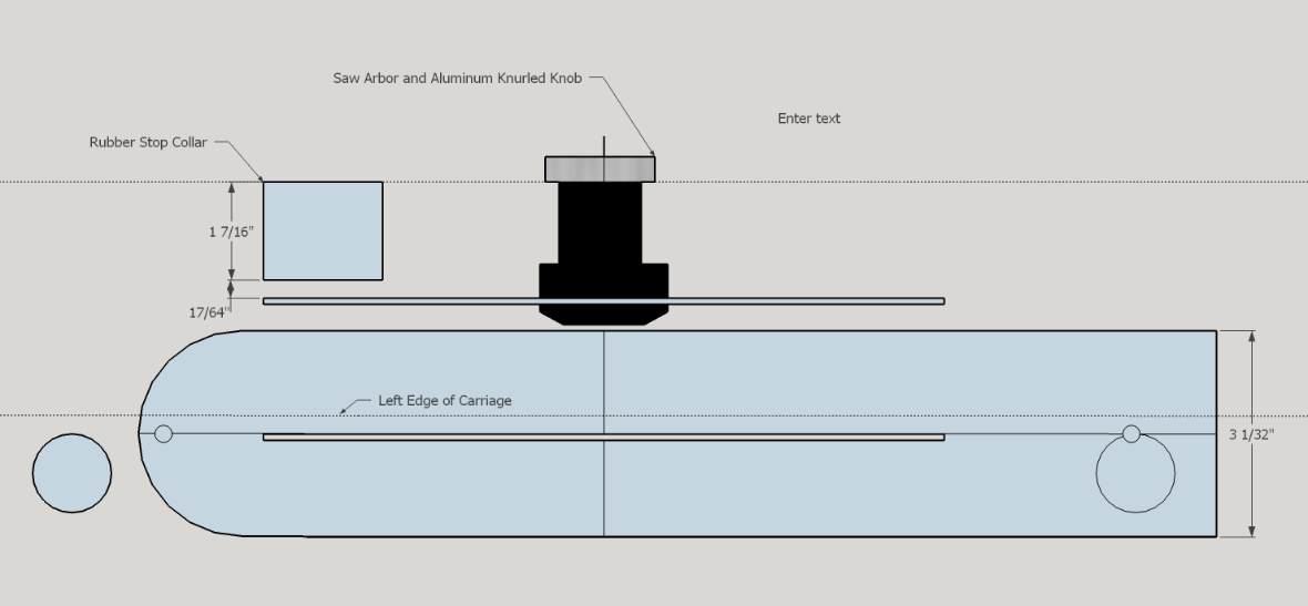

Re: Carriage Stop Ring 516667, Is it a coincidence???
The Rubber Baby Bumper (aka Carriage Stop Ring) exists with two different dimensions. The newer Stop Ring will be 1 7/16" wide while the older ones (the one I have on my 520) will be 1 3/8".
My 520 has a newer headstock which is built with a small nib on the side of the headstock where it meets with the rubber bumper. The older headstock(the one on my Shorty) has no nib. Therefore the rubber bumper meets with the headstock (rather than the nib on the headstock).
If I use the older rubber baby bumper on the newer headstock, the cut line lines up in exactly the same location as when I use the newer rubber baby bumper with the older headstock. If I exchange rubber baby bumpers, the cut line is no longer in the center of the table cutout (the insert).
My own conclusion: The nib on a headstock and the dimension of the rubber baby bumpers are somehow related. If the objective is to put the cut line in "the center" of your table insert, you might be disappointed - depending on which rubber bumper you have and which headstock you are using.
I build my own table inserts and I use, almost exclusively, a thin kerf blade. As I am currently configured, my table inserts are interchangeable. If I ever change rubber baby bumpers, that will not be the case.
For those who do not use ZCI, this is absolutely a "non-issue". For those who do use ZCI, be aware.
This now constitutes the end of a short discussion regarding rubber baby bumpers and their dimensions.

Re: Carriage Stop Ring 516667, the intended function??
Am I correct in stating that the nib causes the blade slot to be further from the quill? If not correct the following is invalid.
If so, the new casting(nibbed) with the newer spacer(1 7/16") would place the blade 1/16" further from the insert center line than the diagram above which used the newer spacer with the older casting.
I am not questioning your measurements, but, this just seems contradictory(bassackwards) rather than premeditated(designed).
JPG wrote:Am I correct in stating that the nib causes the blade slot to be further from the quill? If not correct the following is invalid.
Your observation is correct. Using the new spacer (1 7/16") holds the carriage off by the difference in bumper dimensions. The blade will be positioned to the left of the intended cut line.
This was why I queried Shopsmith about the new (1 7/16") spacers when I received them. Using them messed up my alignment.
Now it is possible that I can do a complete main table alignment and compensate for that by moving the table to match the revised blade position. I have not done that and do not intend to because I have completing projects in the works right now. I have gotten back to work on the RV renovation.
