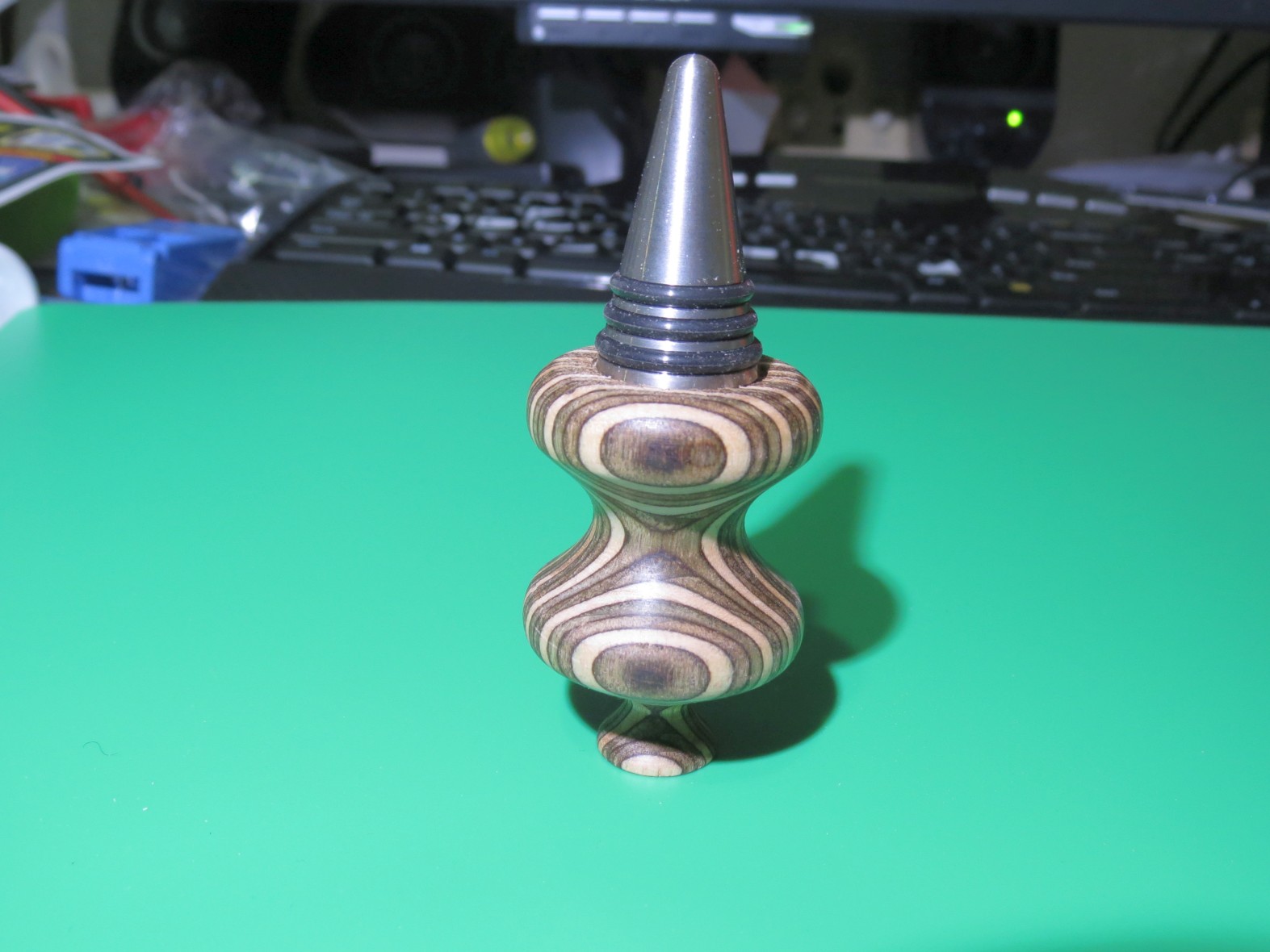

Before I turned my second weed pot tonight I turned one of those plywood stacked blanks. I had no problems. I used Ruth's mandrel to thread it and it seemed to work fine.
One thing that did come to mind is drilling about an 1/8"- 3/16" deeper then the length of the mandrel screw. You need that extra room for wood bits that come off during the threading. If you have no place for them then you will strip the threads when installing the mandrel.
So here is my newest bottle stopper:
