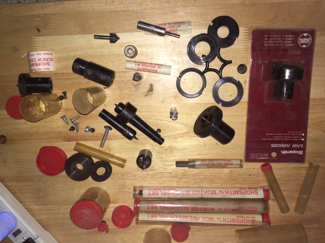

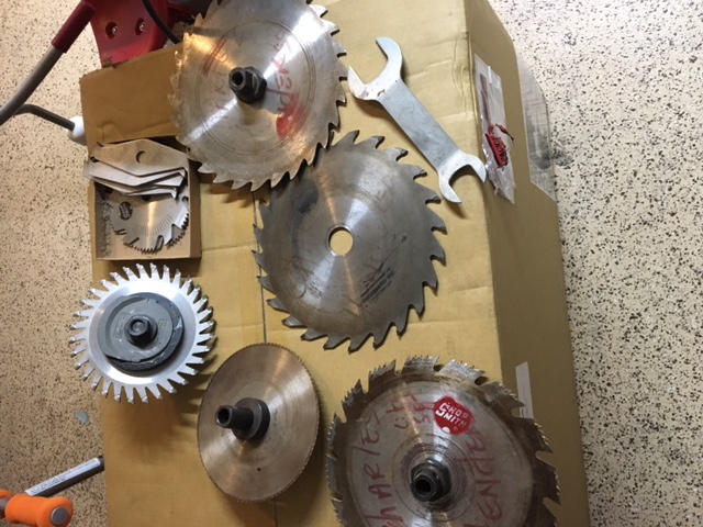

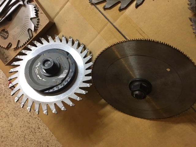

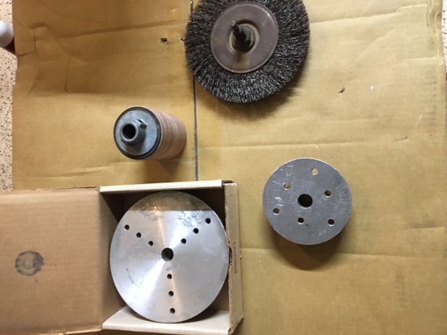

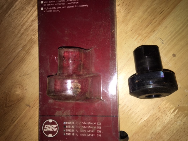

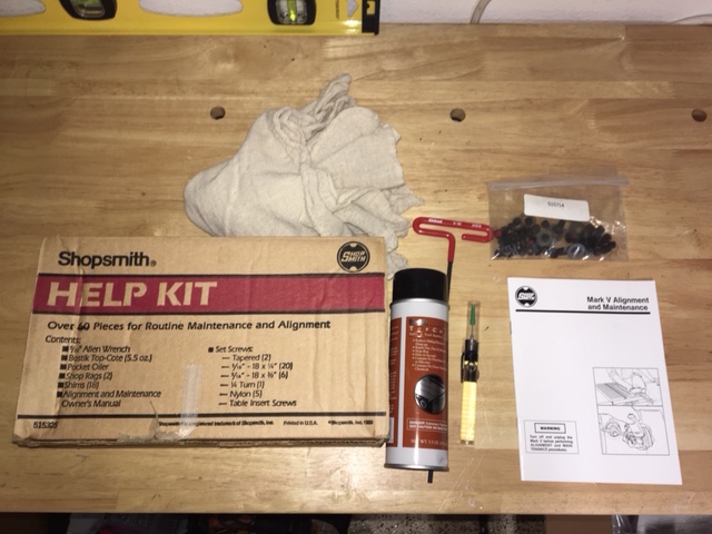

Re: New Mark V Owner
Here are some of the accessories.
The two arbors on the saw blades are for the 500. I threw them on and they are short. The other two blades have an arbor on there but it doesn't have the flat nut like the regular 500 arbors on the standard blades. I threw these on the quill and they actually reach too far. I have to adjust the headstock back from the table a bit. Not sure what the blade next to the dado is for. Large sanding disc doesn't have an arbor attached though I assume one of the others fits.
Don't know what some of these pieces are.
This should be the proper arbor.
In image #1385 the object just to the left of the red blister pack appears to be the arbor to convert the steel sanding disc from a 500 model to a 510/520 model. It is not for the aluminum sanding which is shown in another picture. You sure do have a bunch of good stuff.
Bill V
Bill V
- Posts: 35457
The '500'/Mark 5 arbors will all work with a 510.. by simply advancing the quill.
The aluminum disk however will likely only work off the side of the table as it did with a m5/500.
Image 1386 IS a 510... arbor.
That is a 'plywood' blade next to the dado.
