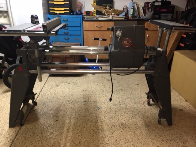

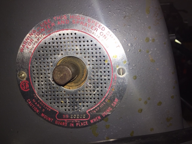

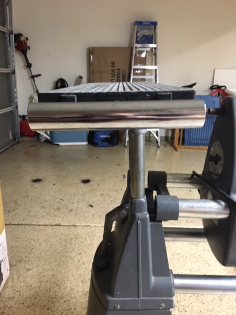

Looks like there are several of these threads on here. Been fascinated by these machines for some time. Finally got my hands on one. I'm the proud owner of what I believe is a Mark V 500 with a 510 upgrade from 1978. At least that's what the serial number of 20200 tells me. I got it and all the accessories for $500. I think it was a good deal and is in pretty good shape. Seems to run just fine though I think it needs some TLC to get it running accurately. Hopefully I can detail what I find on this thread. Glad to be a part of the community!

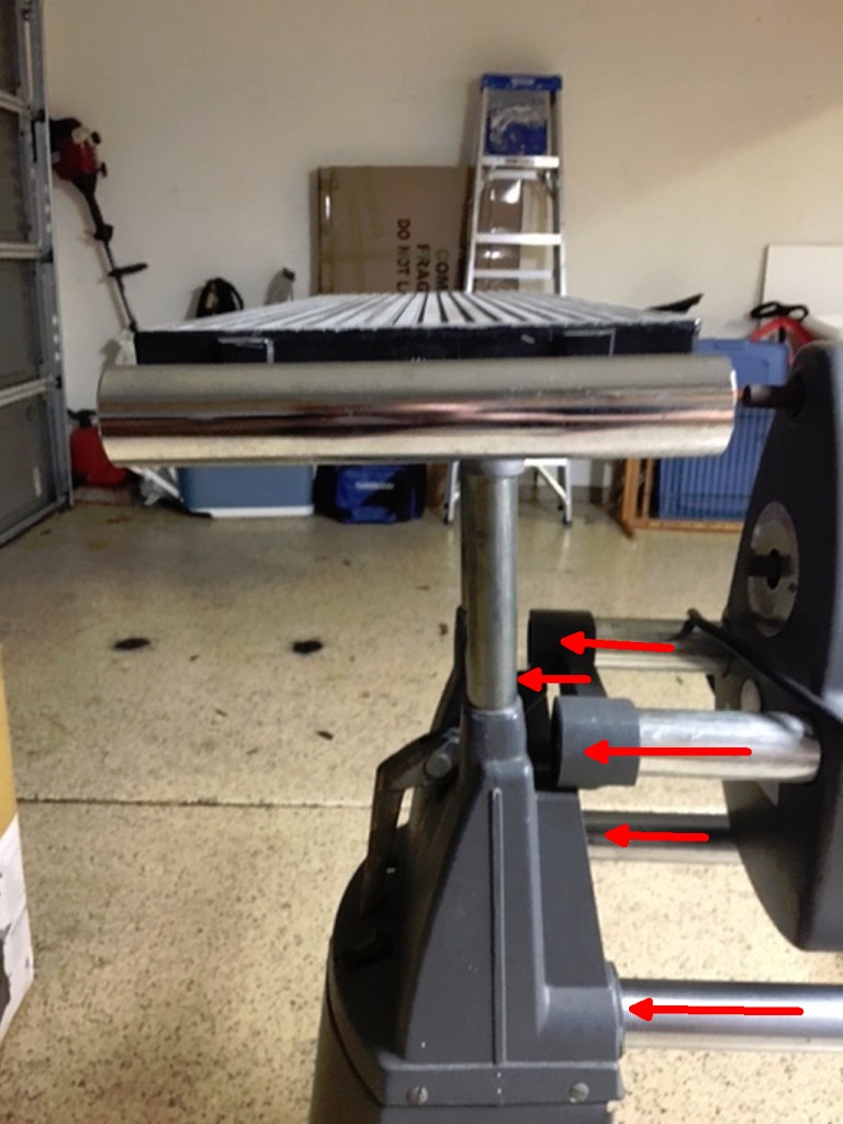

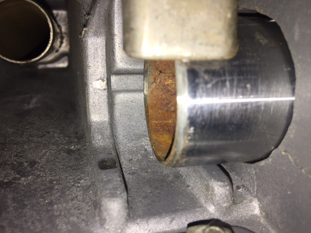

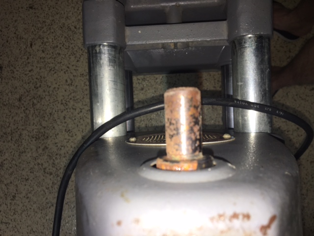

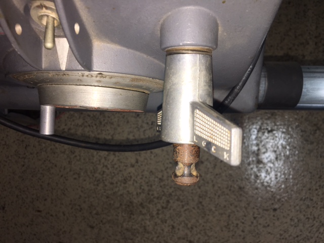

Possible problems.
This table is bent off to the left. I'm sure I can adjust it.
Some rust on these. Don't know how far it goes.

You have an early Shopsmith Inc. Mark 5. Essentially equivalent to a Mark V 500. In 1978 there was no Mark V.
The extension table MAY be correctable as is if it is mounted with studs and double nuts etc.. If not, it is easily converted to studs etc. which makes it easier to set level etc..

Re: New Mark V Owner
Maybe it is just the picture. But I don't like the look of the tube positions. And, if my thinking is right then the tubes are not installed correctly and could be a accident waiting to happen. So before you do much else check to see the tubes are inserted and clamped in the right position. Doing so may fix the issue you were discribing in the post.
Seriously if those tubes pull out when moving it the machine could be damaged and require some additional repairs and added cost for them. If you are not sure how to proceed just ask we have an abundance of helpful people here.

Re: RE: Re: New Mark V Owner
Hmm, it does kinda look like the base is canted away from the bench tubes. Are the ways locked down? Could it be locked but not have the way tubes seated correctly causing the lock to push away? Could be causing the extension table tilt.reible wrote:Maybe it is just the picture. But I don't like the look of the tube positions. And, if my thinking is right then the tubes are not installed correctly and could be a accident waiting to happen. So before you do much else check to see the tubes are inserted and clamped in the right position. Doing so may fix the issue you were discribing in the post.
Note the third pix
http://www.shopsmith.com/ss_forum/viewt ... #post41342
Read the rest if desired!
(you might want to check the hinge end as well)
Saw that the rails underneath weren't seated on all 4 corners. Off came the motor and a reseat.
