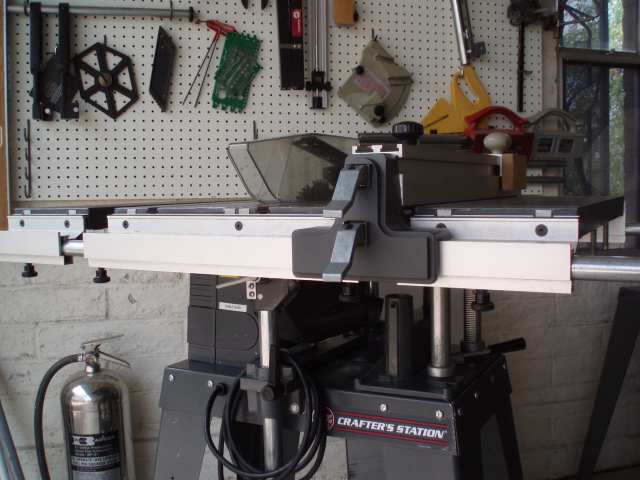

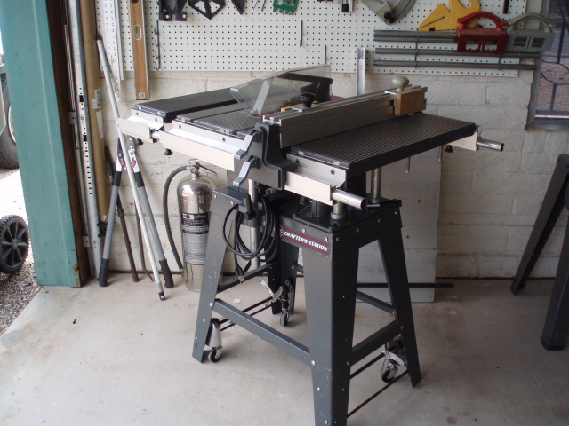

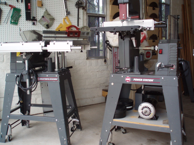

Forgot I had these. They are from before I resolved the wiring issue.
charlese, it should work forever.
There are only two things to fail; the transmission which is the same as in all the Power Stations and the motor, also the same as in all the Power Stations.
Like I said earlier, I sure wish I could put my hands on the two that served you so poorly.
Edited 10:59am
