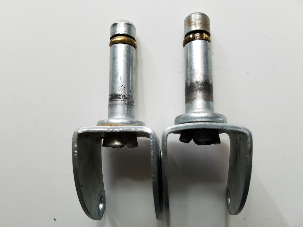

Standard Shopsmith Caster (before the 3" upgrade)
Stem 7/16" grip ring 1 11/16" long
Load Height 2 3/4"
2" wheel 3/4 wide

The 3" castor stem is shorter because it has a pivot bearing just above the wheel. The weight of the machine is supposed to ride on that bearing. Thus you want the end of the piston to sit on that bearing. To accomplish that the stem must be shorter than the piston bore.dusty wrote:Standard Shopsmith Caster (before the 3" upgrade)

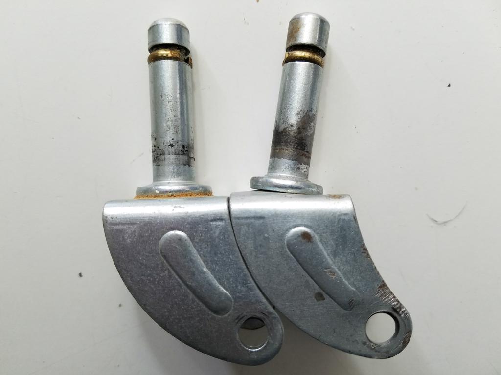

We don't know that the 2" caster with the 1 11/16" stem has been around for 70+ years. But even if it has, that solves nothing. These two images show part of the problem that I am attempting to solve and I hope that the casters that I have on order (with the proper load height and greater weight capacity) will solve at least my problem.
I have replaced at least a half dozen casters that look like the one on the right.
