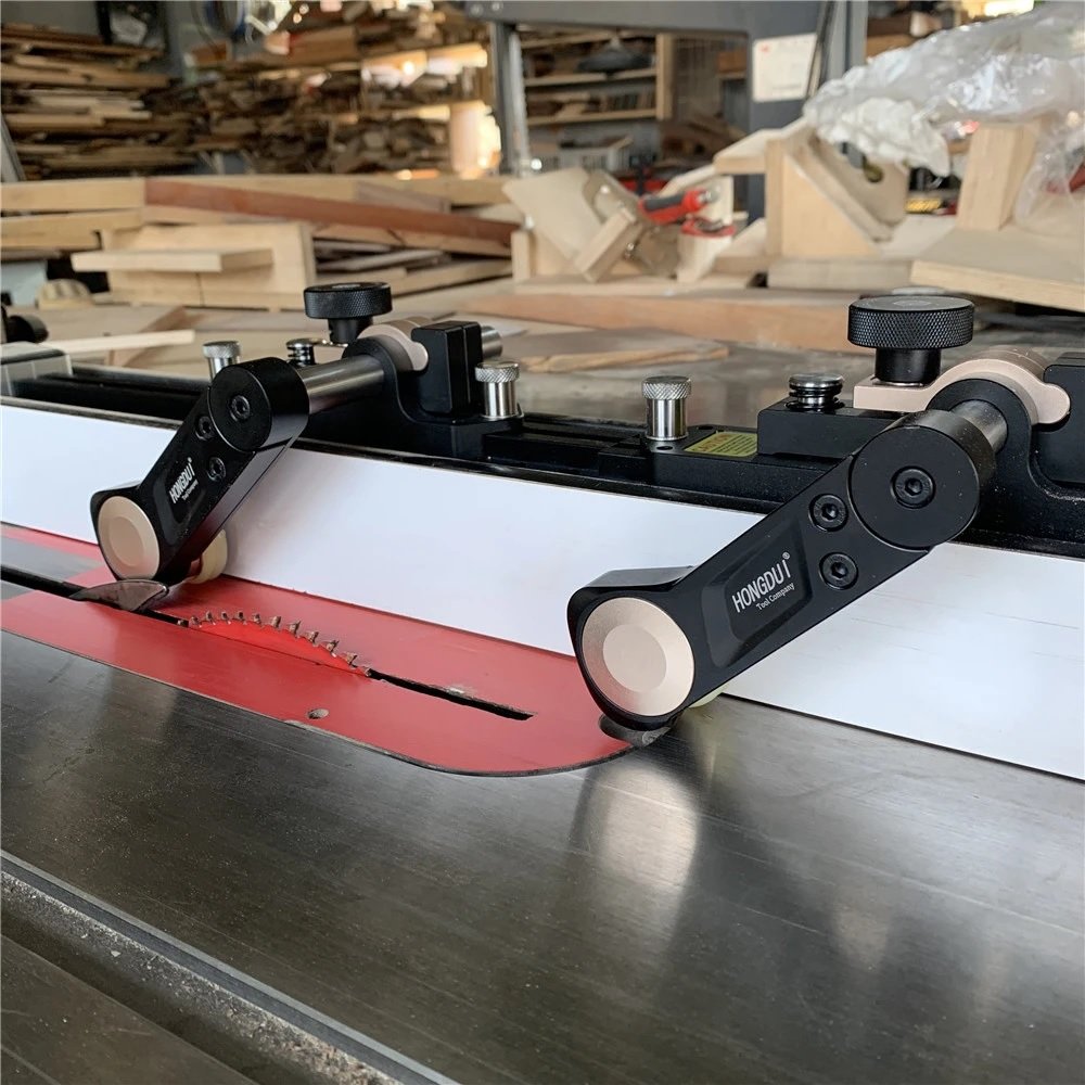

Well, I guess it was only a matter of time before these were copied in China. What is interesting is that the price (to USA) is essentially the same as getting the original from Jessem, so why buy the Chinese version??? Apparently, these come out to about half price (according to reviews) for those purchasing them in Europe...perhaps an exchange rate difference between Canada/China <-> Europe?
Not going to post the link to them because I hope anyone reading this post will consider the Canadian manufactured Jessem guides instead, but here is a pic of what the Hongdui guides look like:

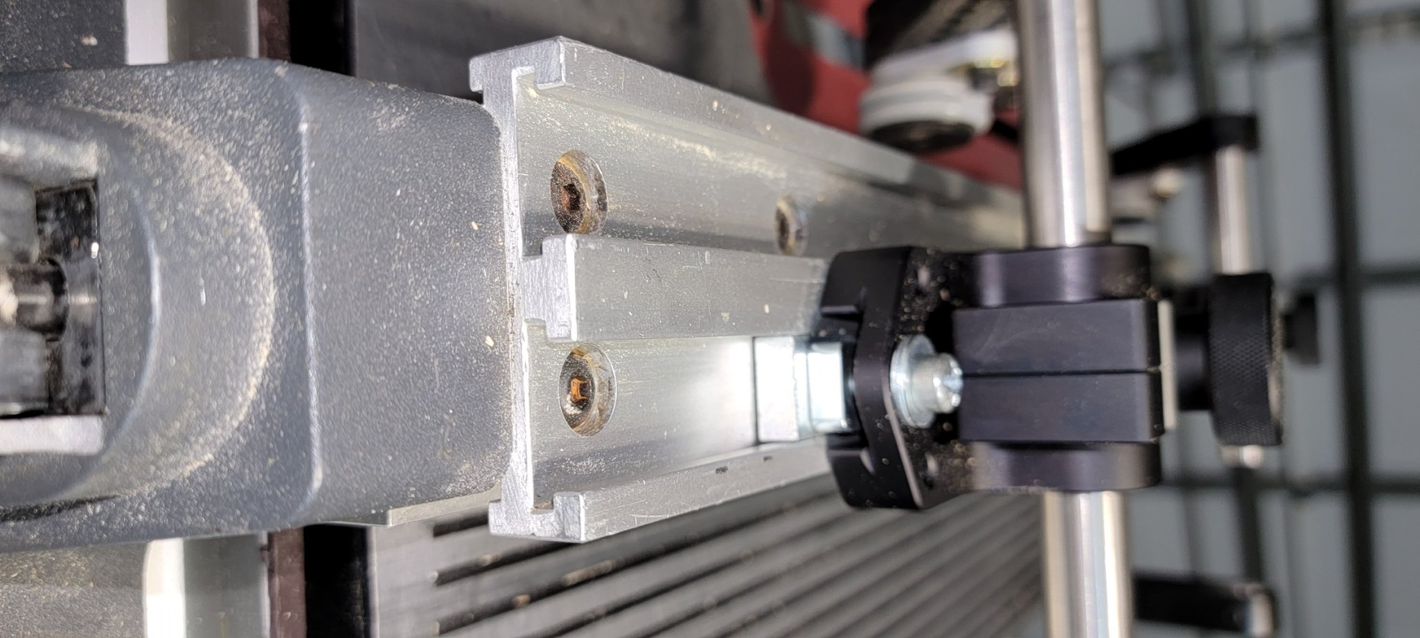

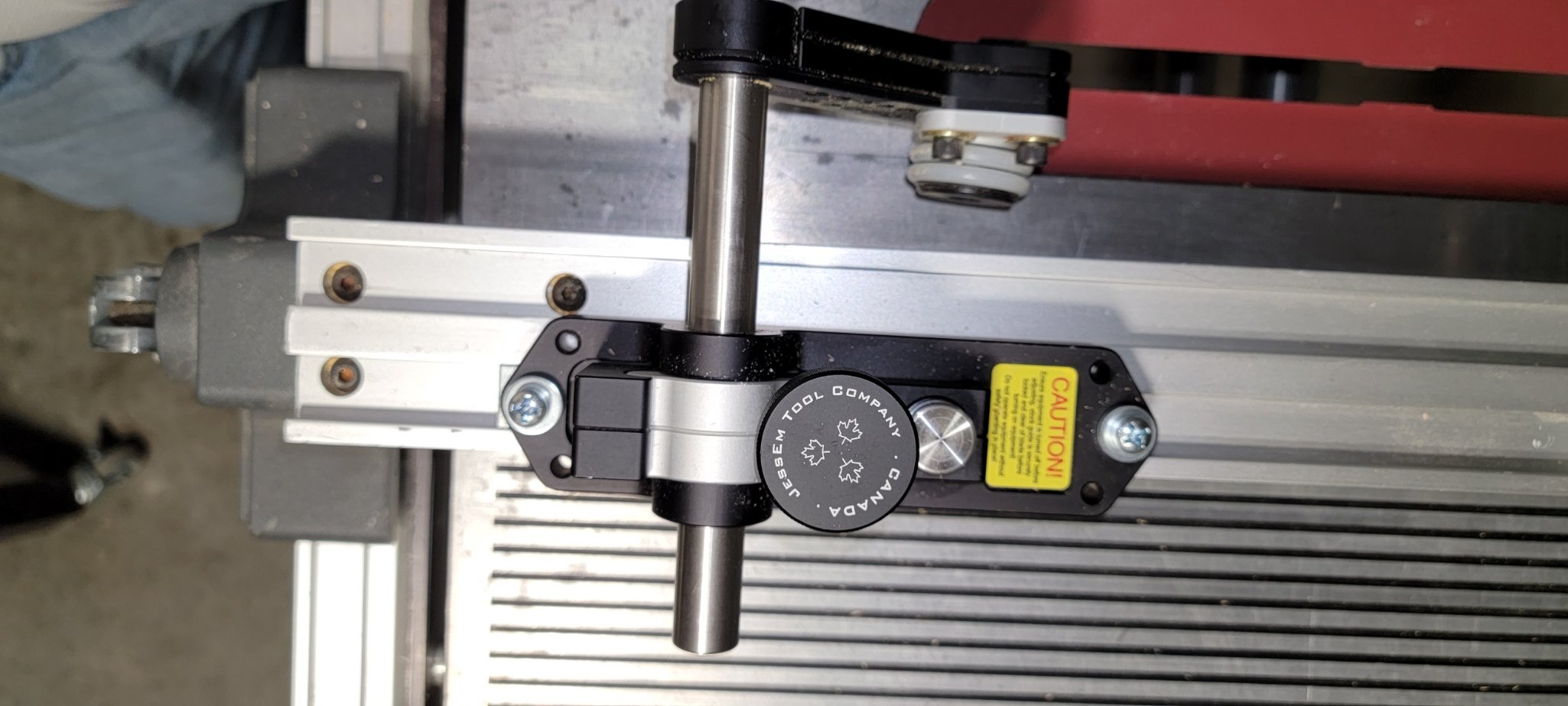

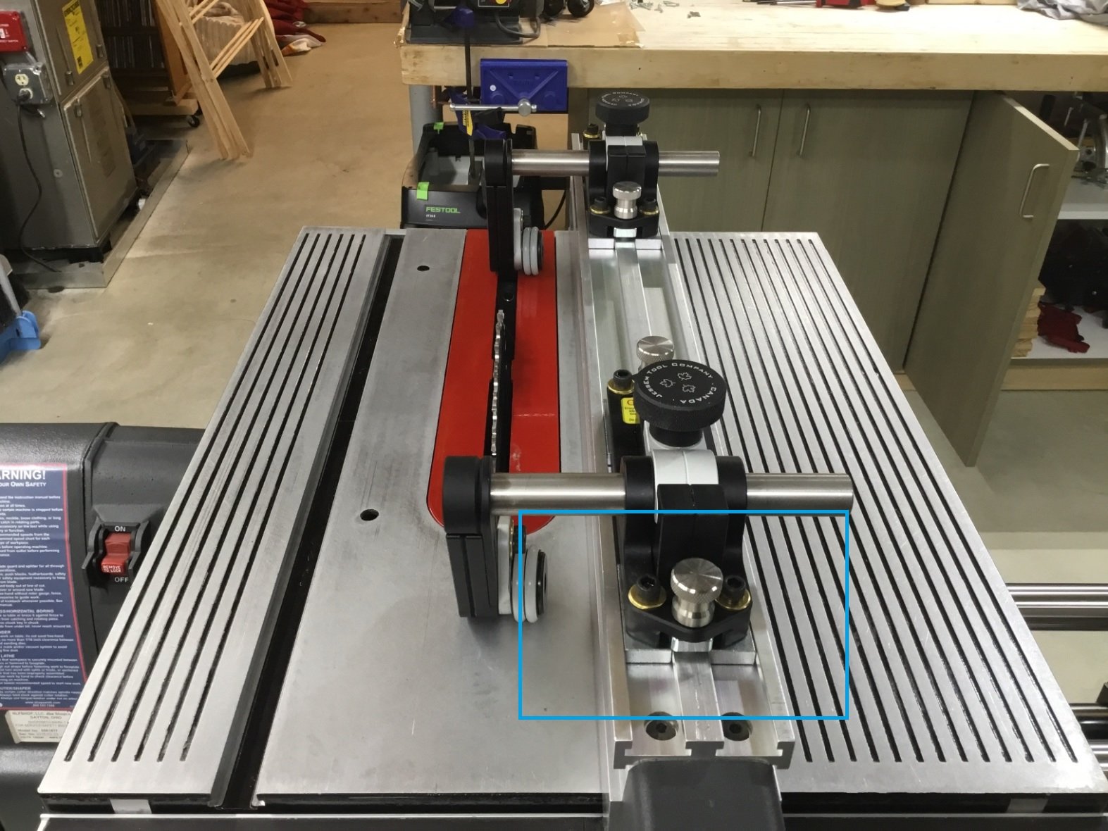

After reading this thread, and thinking ( well trying to, anyways ) about it. I drilled out the 4 holes on the Jessem shoe (?), and used SS t-nuts. Hopefully the photos will explain it better. This was pretty easy, no overhang.

That looks pretty simple. When I look at this view I'm wondering what stops the whole assembly from sliding in the T-tracks on the fence:

It looks like no part of the guide is in direct contact with the fence. So I'm not quite understanding it. What am I missing?

The 4 Allen head bolts hold the guide tight to the top of the fence. One could leave the 4 Allen head screws just loose enough that the guide will slide, and just use the 2 silver knobs to tighten the guides solid to the top of the fence. loosening up the round black knobs allows the shaft the roller assembly is on, to move left and right. As you slide the stock under the rollers, they are angled, and push the stock against the fence, while also preventing kickback. Any more questions I’ll answer if I can.

What size hole did you drill out the shoe holes? Did you offset the holes to better align with the ss t-nut?

If I’m remembering correctly, I drilled out the 4 corner holes to 3/8. This allowed the 1/4-20 bolt to screw into the the tee-nut, just barely, keeping the shoe square to the fence. In this application absolute square isn’t a necessity. Just need close enough so the wheels keep feeding the stock against the fence. This is why I needed the washers on top, because the bolts are not centered in the holes. I think I tried to offset the holes, but was not able to. I think I went 1/4 to 5/16 to 3/8.

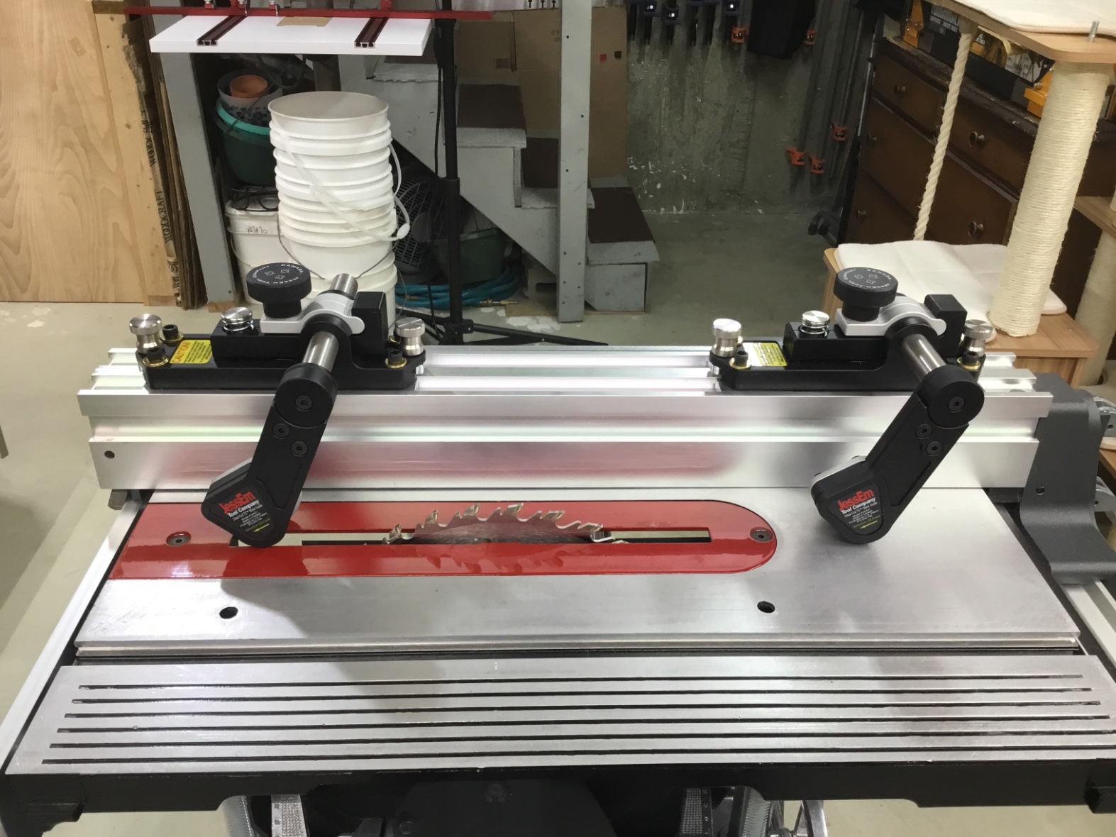

I ended up with a very simple solution, that seems to be quite solid in use. I used 2x1" 1/4-20 bolts and a few washers per shoe to bolt the guide shoe to the right most track of the fence via the shoe slide under the shoe, and a t-nut under the shoe slide in the SS fence track. I could have installed in the left most track, but I wanted to maintain clearance on the blade side of fence. Either way, the install is very sturdy and worked very well in tests. The only negative is I do give up clearance on right side of fence due to a small overhang, and I lose some guide wheel reach (with the install on the right track). Positives are I didn't have to alter the guide at all, the guide is still very sturdy and easily repositionable. It's too bad the thumb knob that comes on the shoes isn't 1/4-20 and have a 1" length.

gidgiddoni wrote: Tue Jan 11, 2022 3:17 pm I ended up with a very simple solution, that seems to be quite solid in use. I used 2x1" 1/4-20 bolts and a few washers per shoe to bolt the guide shoe to the right most track of the fence via the shoe slide under the shoe, and a t-nut under the shoe slide in the SS fence track. I could have installed in the left most track, but I wanted to maintain clearance on the blade side of fence. Either way, the install is very sturdy and worked very well in tests. The only negative is I do give up clearance on right side of fence due to a small overhang, and I lose some guide wheel reach (with the install on the right track). Positives are I didn't have to alter the guide at all, the guide is still very sturdy and easily repositionable. It's too bad the thumb knob that comes on the shoes isn't 1/4-20 and have a 1" length.
This is great Im going this way I think thanks for the pics!

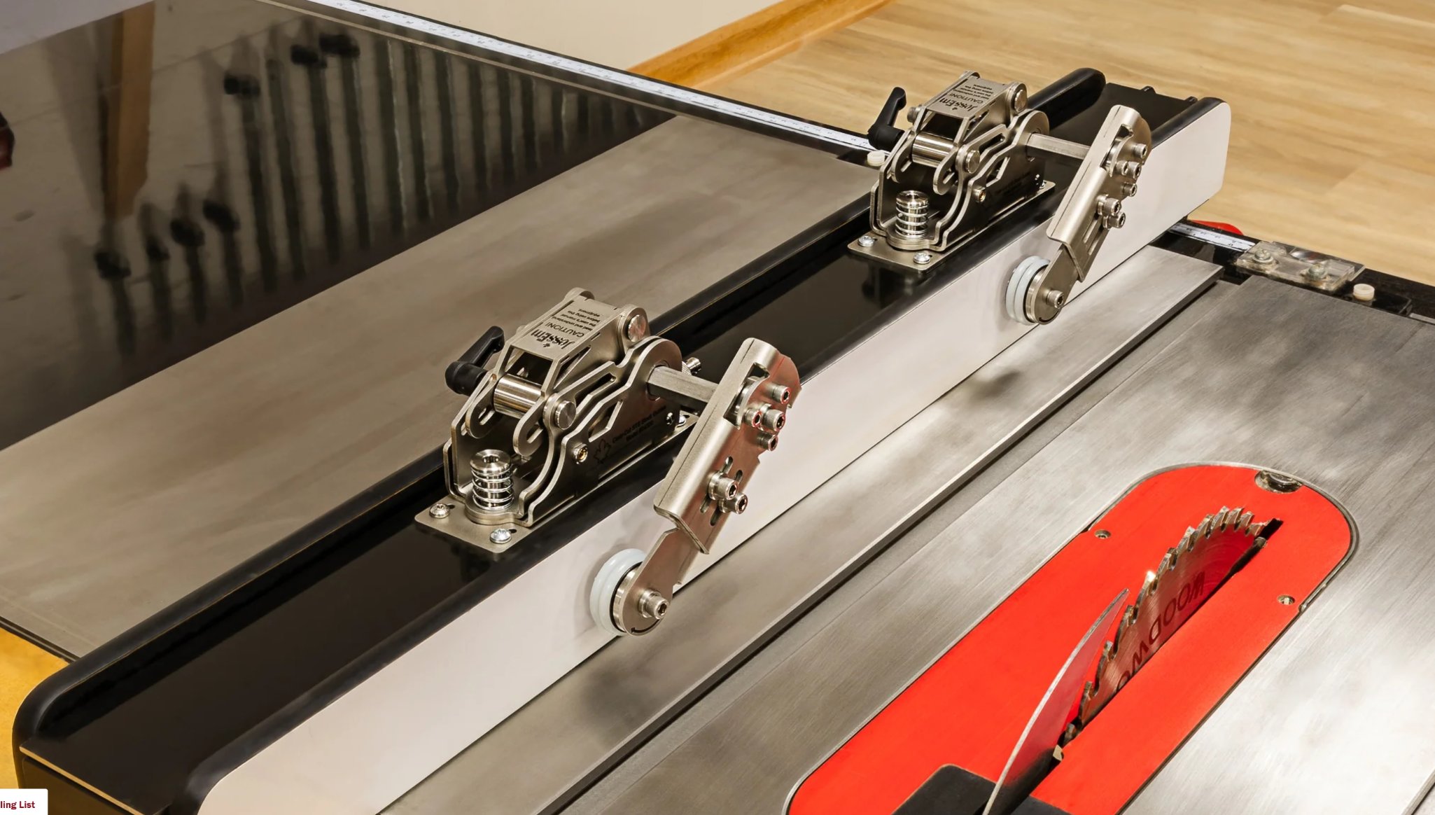

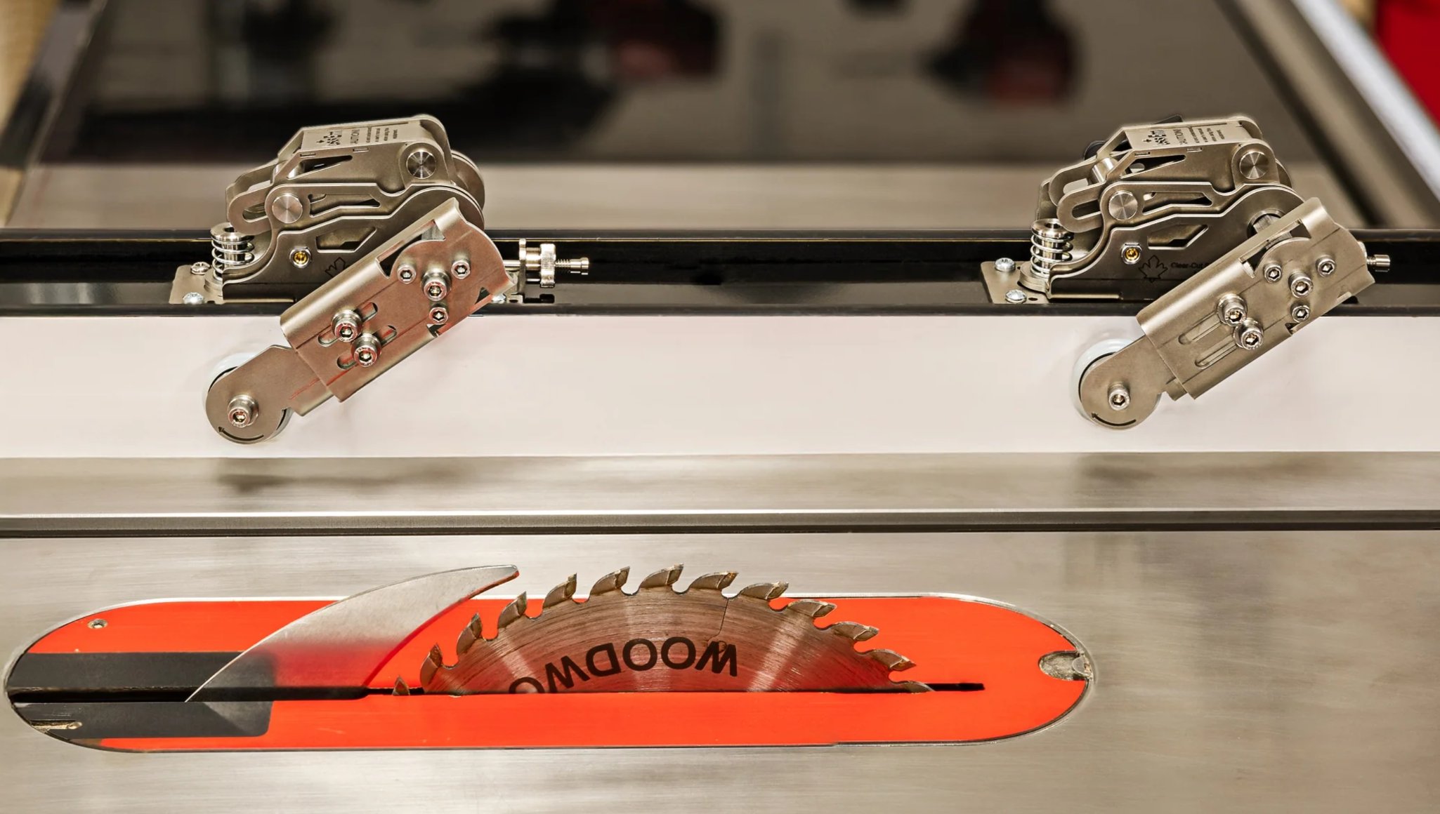

Jessem has come out with a new iteration of their tablesaw stock guides called Clear-Cut STS Stock Guides. Quoting below what they posted on IG about them:
We challenged our Engineers to re-design our TS Stock Guides and make them more compact to fit all types of table saws. Giving you the same high quality, preventative kickback and perfect clean cuts as the Originals. We are proud to Introduce the NEW Clear Cut STS Stock Guides!
They are a bit cheaper at $200 compared to $280 for the Clear-Cut TS™ Stock Guides. They don't really look more compact to me at first glance, but perhaps the key appeal is easier mounting to a variety of table saw fences? It looks like they have different base plates that can be swapped out to achieve this.
https://jessem.com/products/clear-cut-ssts-stock-guides
