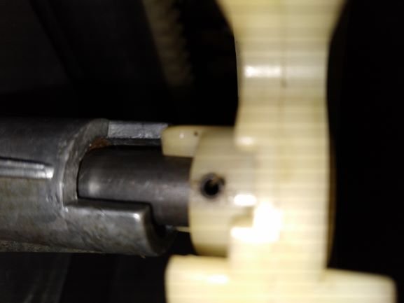

Is the control knob shaft tight or is there end play? I wonder about he duplicate pin holes???

Maybe different thread, but previous posts mentioned more than one pin hole.

I don't remember any alternate pin holes on my speed cam. I did have an alternate key way on the sheave which I thought was odd. It is all back together and operating really well, so I better not push my luck. I think I will try to find a new eccentric end nut and safety washer. The nut is not a very tight fit to the threads and I question if it is original. Maybe that is why the square nut was being used as well?

here is a link to the thread about 2 roll pin holes thru the MKVII speed cam shaft.
viewtopic.php?p=278106#p278106

Thanks for the link. Interesting, I took a pic and can only see the one roll pin. I suppose it could have an alternate drilling under the plastic, but I'm not going to mess with that. I would likely crack it and create a new problem. ;)
