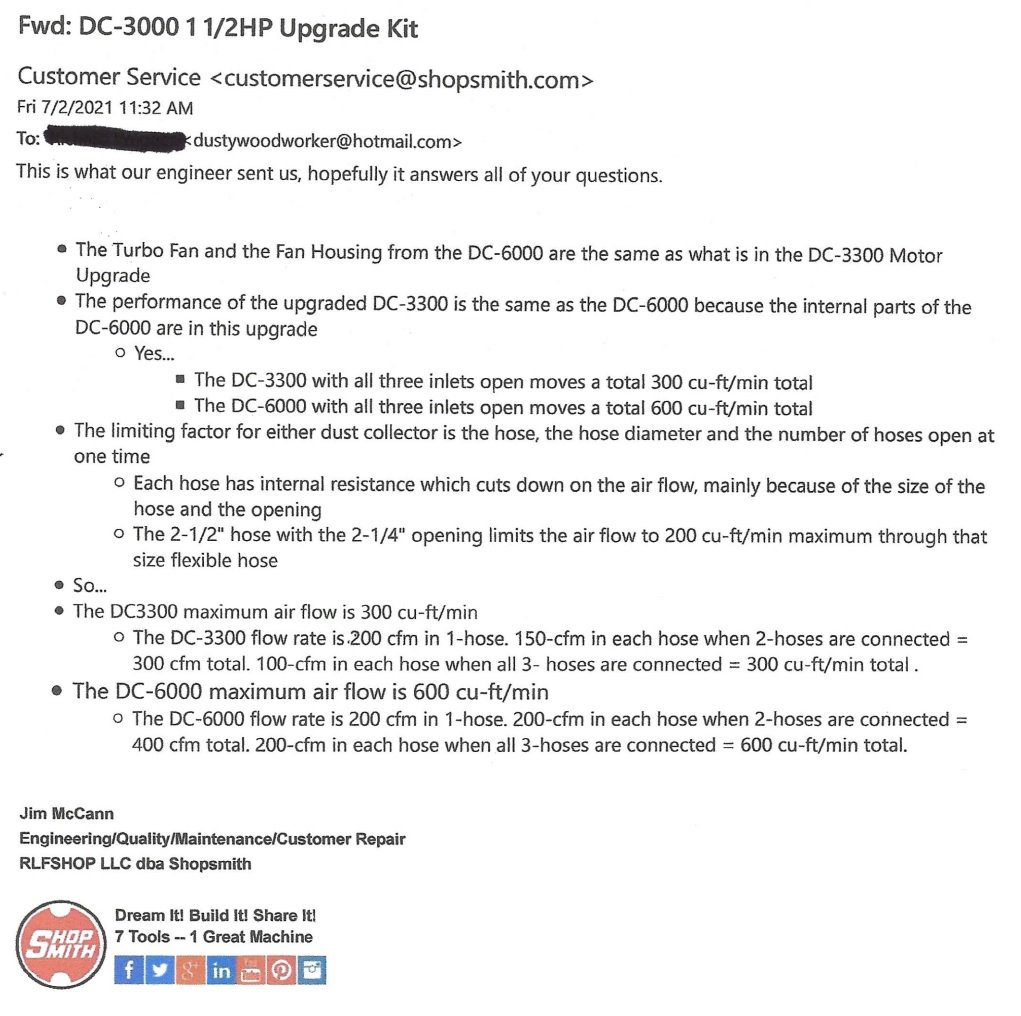

Thanks and I appreciate all of your efforts last year to try to quantify what you saw with your upgrade. I did find more information that I was looking for. You had attached it in a file on the forum previously, but I am posting it as an inline pic below for reference. As I reported last year, my non-upgraded DC-3300 can't even get 200CFM airflow out of 1 port. The best that I could get is 142.7CFM and that was the best port, i.e. the 3 port manifold is not symmetrical for airflow. With all three ports open it drops into the 70's for each port. Granted my DC-3300 is a couple of decades old, but it has been well cared for. I do believe that most likely the DC-3300 was designed for a max airflow of 330CFM, but not into a single 2.5" manifold port but rather into the 4" inlet of the 3 port manifold. We know that airflow and airspeed are governed by the equation: CFM = fpm * area. So, for a constant airspeed, obviously the aiflow will be reduced by a smaller port. What isn't known in my mind are as follows:
  • What was the original DC-3300 designed to, i.e. what airflow and at what port, size, etc. ?
  • What is the new DC-6000 designed to, i.e. what airflow and at what port size, etc. ?
  • Is the DC-3300 conversion kit EXACTLY identical to the new DC-6000 ?
Since I do NOT get anywhere near the 300CFM out of my old DC-3300 that Shopsmith claims, I really don't know how to interpret Jim's performance estimates in the pic below. I have no doubt that the DC-6000 and the DC-3300->DC-6000 conversion kit most probably perform better than the original DC-3300. I would just like to know how much better? If it is only a 10% improvement, then why bother to upgrade? Jim is reporting that the DC-6000 will maintain 200CFM into each port with all 3 ports open, which if true means that it is a 33% improvement (1 port) compared to what I have today. I question his data because why doesn't 1 port open on the DC-6000 yield much more than 200CFM??? The airspeed will hit a limit inside the blower so I don't expect 600CFM out of 1 2.5" port, but it really should be more than 200CFM IMHO. This is what I question, i.e. why there isn't any taper/drop off in performance between 1 port open, 2 port open, 3 port open for the DC-6000 when compared to the original DC-3300?
All of this is why I still question the upgrade and what its actual performance is. I believe Jim is quoting design targets below and his DC-3300 vs. DC-6000 comparison makes no sense to me. Had I known the actual performance numbers last year I might have upgraded as well. Though after seeing all of the trouble you had with your upgrade not fitting right, I am glad that I didn't. I sincerely hope these assembly issues have been resolved now for those who have purchased this upgrade recently.

As I read Jim's comments, the DC3000 or DC6000 cfm is limited by the hose to approximately 200cfm and I read this to mean with whatever manifold hose combination.
Does this mean I could have 600cfm with the right manifold and hose -- I don't know.

Yeah, I agree that the hose, the manifold and anything else in between the blower fan and the tool will restrict airflow. Jim is suggesting that a 2.5" port is limited to 200CFM, but the only thing limiting it is the max airspeed that the blower fan can produce. There is a limit based on physics, but I don't know that it is 200CFM for a 2.5" port with this particular blower fan. This will vary from one blower to another as well, e.g. you can have a different impeller design and increase the ariflow. So, is it 200CFM because that is what the blower fan in the DC-3300 was designed to? IF so, then mine falls far short of this. It seems like an awful big coincidence that for 1 port only that both the DC-3300 (old) and the new DC-6000 have identical airflow numbers (according to Jim). Again I just think we (forum members) are making assumptions and interpretations about what Jim said and we don't really know what the DC-6000 or the upgrade are capable of. Not trying to rehash all of the discussions from last year again, but just pointing this out. Until I purchase the upgrade myself and take actual measurements to compare before and after, I don't think we will ever know for sure (unless someone else has an anemometer and are willing to do the tests). However, to answer your last question...yes, I suspect that you could get more airflow out of your upgraded DC-3300 with the right combination of hoses and manifold. I have done quite a bit of manifold vs. no manifold tests on my DC-3300 in the past and was surprised how much more airflow you can get without it. Also, I was pleasantly surprised that the Oneida hoses I bought had more airflow compared to a similar length Shopsmith hose.
