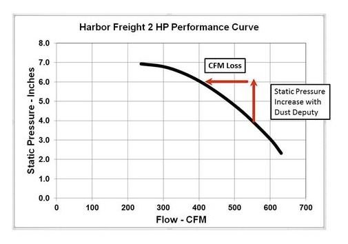

I have a JET 650 CFM which I just adapted a 4" Dust Deputy to the front of.
There is a noticeable drop in air flow at the end of my flex tube.
Here is someones' view of a harbor freight collection coupled with a dust deptuty..unfortunately they do not elaborate if this is the old 2" version, 4" or 5" ...all of which are available. They estimate a 2 - 3" drop in static pressure due to the addition of the dust deputy.
All that said-it seems to be working OK on my tool.
