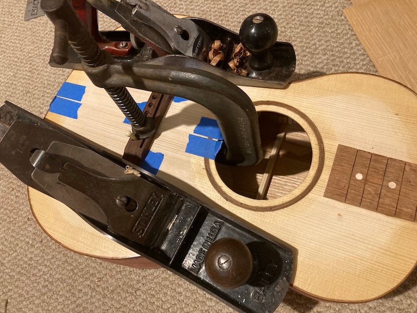

I'm just starting some frets, and the slot depth is fussier than I had expected. Just some more learning to do.

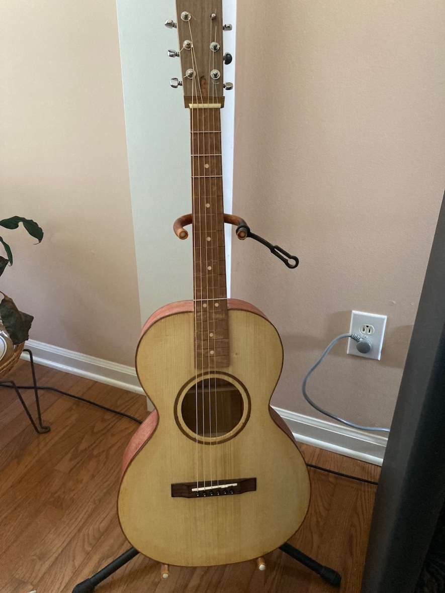

I decided to string the thing up with just 3-4 frets installed. It actually does play pretty decent first-position chords. Further work on the nut height (which is currently shimmed roughly to compensate for a poor headstock measurement I made), along with better fret seating and leveling, will help get rid of some buzzes I noted. But, the good news is, the common red oak body really sounds all right!

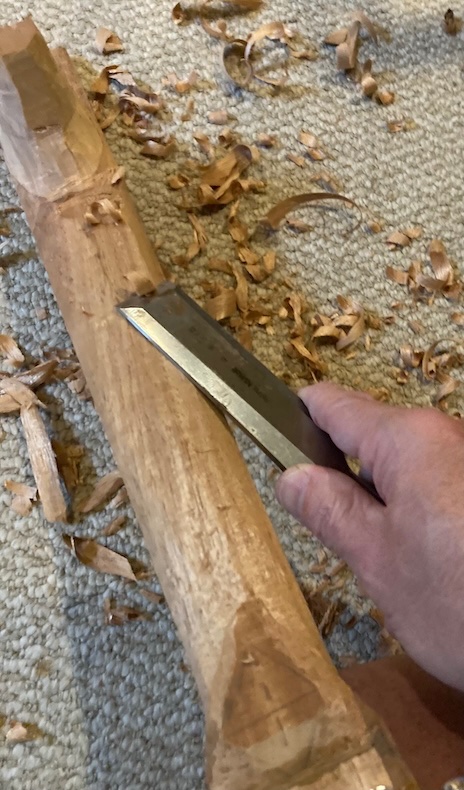

Rough carving the neck from cubist design down to something more playable:
Gluing on the bridge:
The temporary nut shim:
The first trial day:

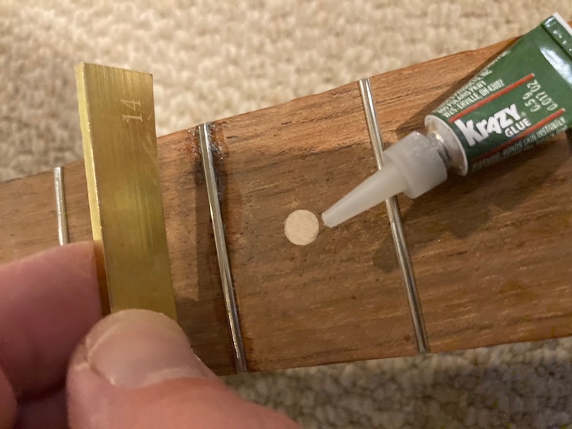

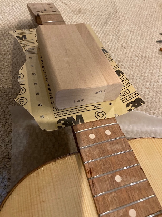

I had to do a lot of learning on (re-) fretting. Here, correct tools are really key. Fortunately, not too expensive.
The main thing I found helpful was getting the fret wire, fret press blanks, and fret sanding blocks all at the same (14") radius. That took care of many problems. Out of 18 frets or so, 3 of the slots were wallowed out from my mistakes, but I resolved those with super glue:

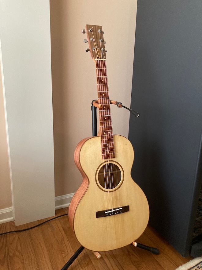

And here is the fully playable guitar!
Thanks for watching! I'll let you know if I ever get a recording up on the web.
