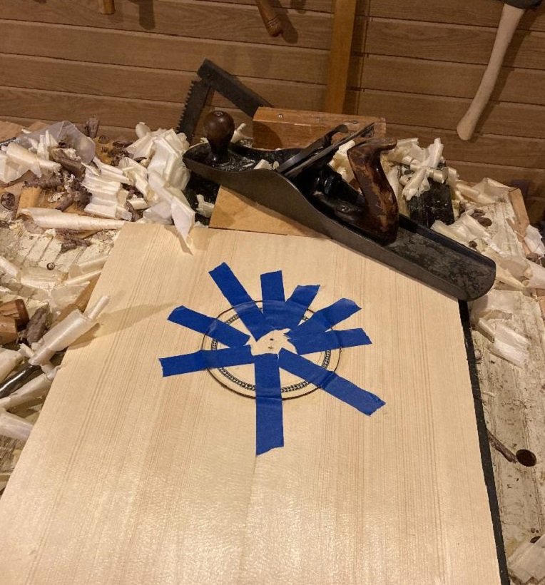

I have a little parlor guitar that plays nice but tinny-- it's a plywood body. I thought I'd make a real wooden body. I bought some curved side pieces from a kit-maker, and I've been working it gradually over the last few weeks....
The SS bandsaw gave me 6 very thin walnut planks to build a back:
Rosette Glue.jpg (129.94 KiB) Viewed 38298 times

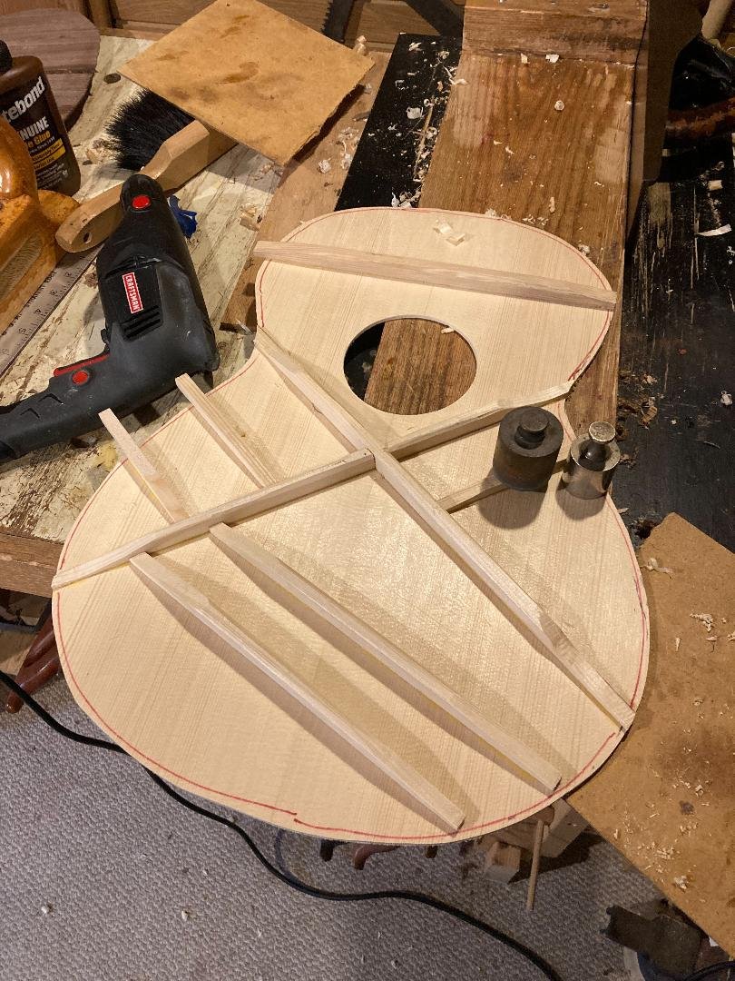

New Top Braces.jpg (199.66 KiB) Viewed 38298 times
Nothing like a Horizontal Boring machine for a job like this! I used a backer board to help run the drill-bit partly in wood and partly in the air:
Drill Truss Clearance.jpg (141.99 KiB) Viewed 38298 times

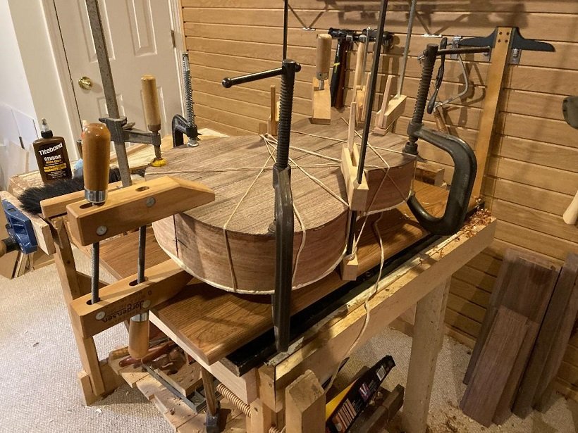

Some SS screw clamps and cam clamps, and everything else I have!
Body Glue Up.jpg (134.21 KiB) Viewed 38298 times

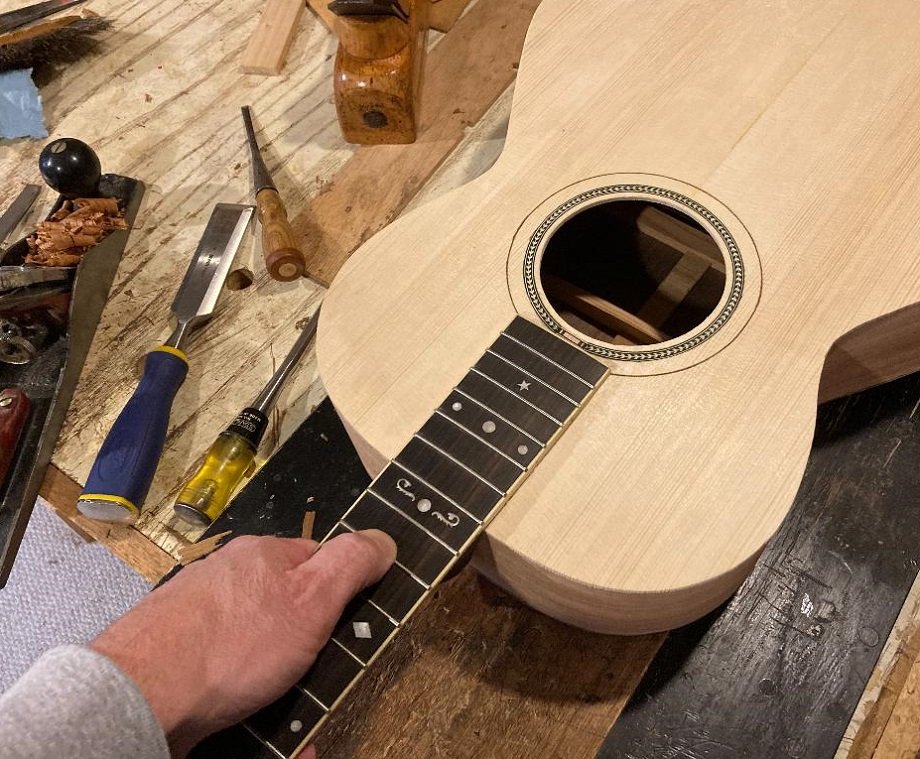

Pulling the nice fingerboard/neck / bridge pieces from the old guitar:
Sacrificed Parlor Guitar.jpg (195.71 KiB) Viewed 38298 times

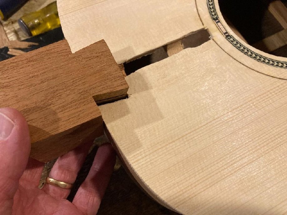

A bit more work so far this week:

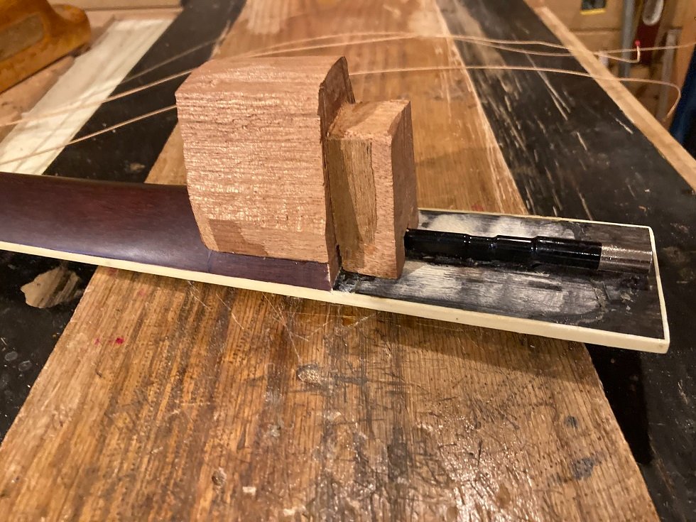

The "dovetail block," which was very tightly matched to the guitar body mortise, had to be attached to the re-used prior neck of the old guitar. I used very strong epoxy here, did a lot of careful sawing and chiseling, and glued it up as straight as possible:
Dovetail Block attached to Neck.jpg (165.33 KiB) Viewed 38199 times
Later I did partially string-up the guitar, and that dovetail joint is a rock (neck to body joint supported the string tension without any glue). Future work will be to refine further the block, which is only partially rasped to shape here:
Neck Joint Rasped Rough.jpg (135.67 KiB) Viewed 38199 times

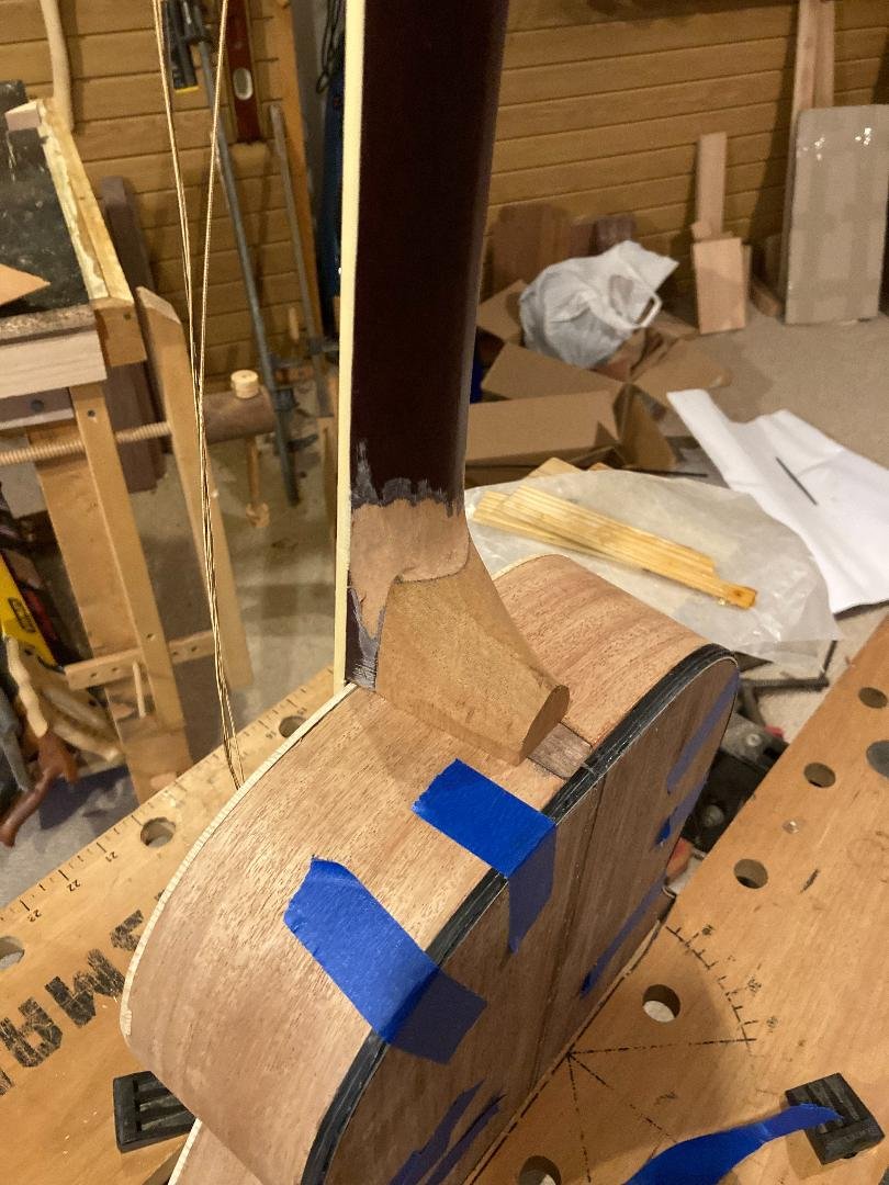

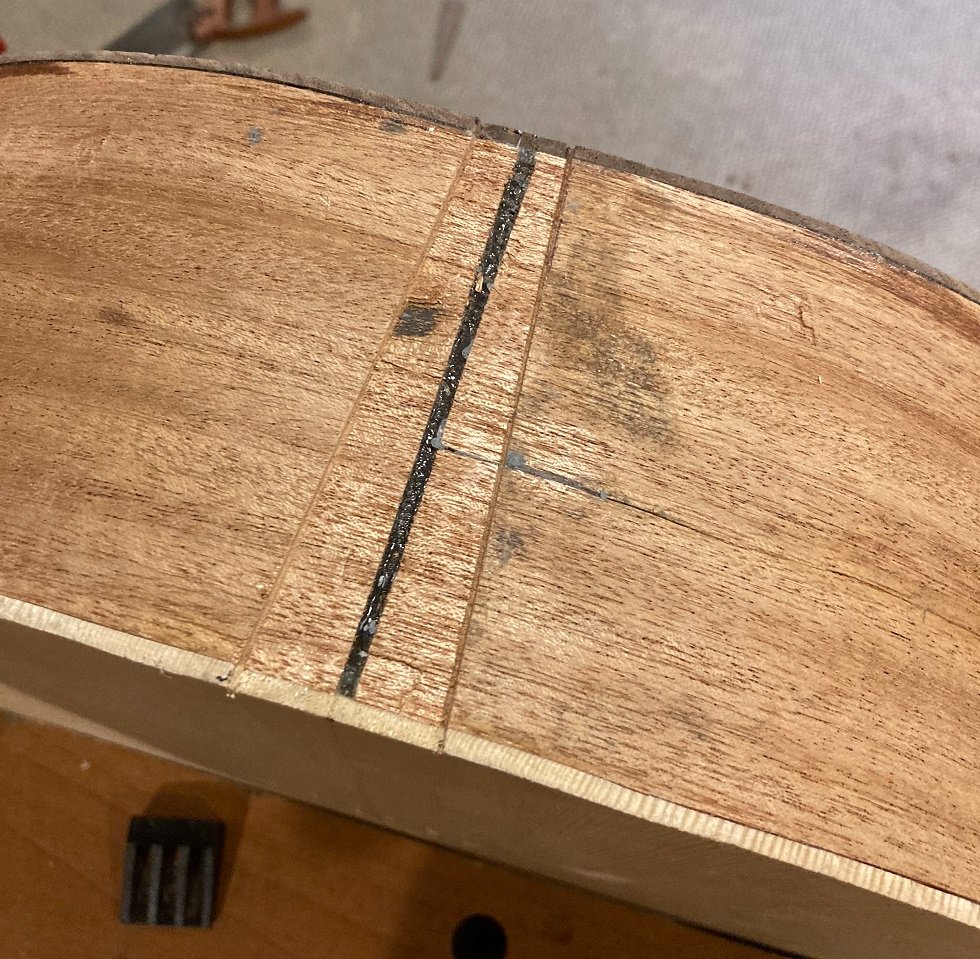

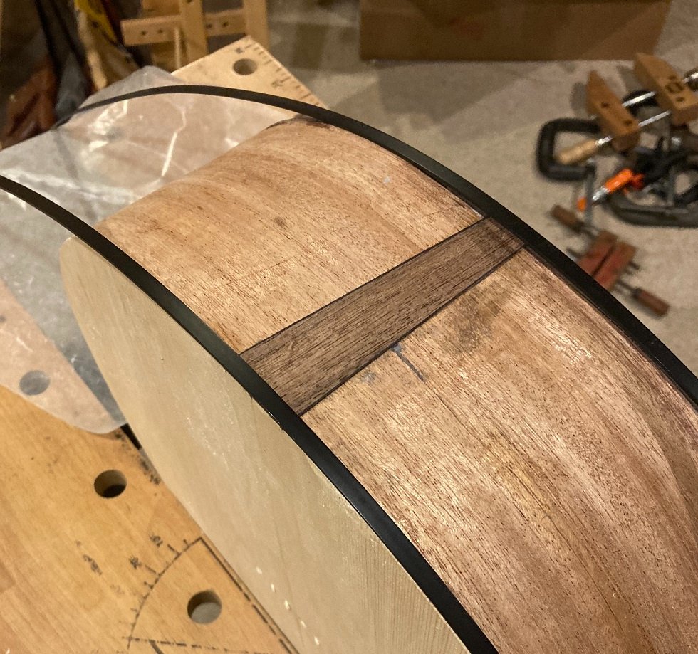

Another detail was to start some body trimming steps. The end block joint was very ugly (I had used a J-B Weld epoxy variant there, since I had trouble with spring-back on the bent woods), so it's being filled in with a V-shaped insert of scrap walnut, etc.:
Heel Joint Opened.jpg (255.22 KiB) Viewed 38199 times
Heel Joint Wedged.jpg (175.4 KiB) Viewed 38199 times
Heel Joint Decor Visual.jpg (204.21 KiB) Viewed 38199 times

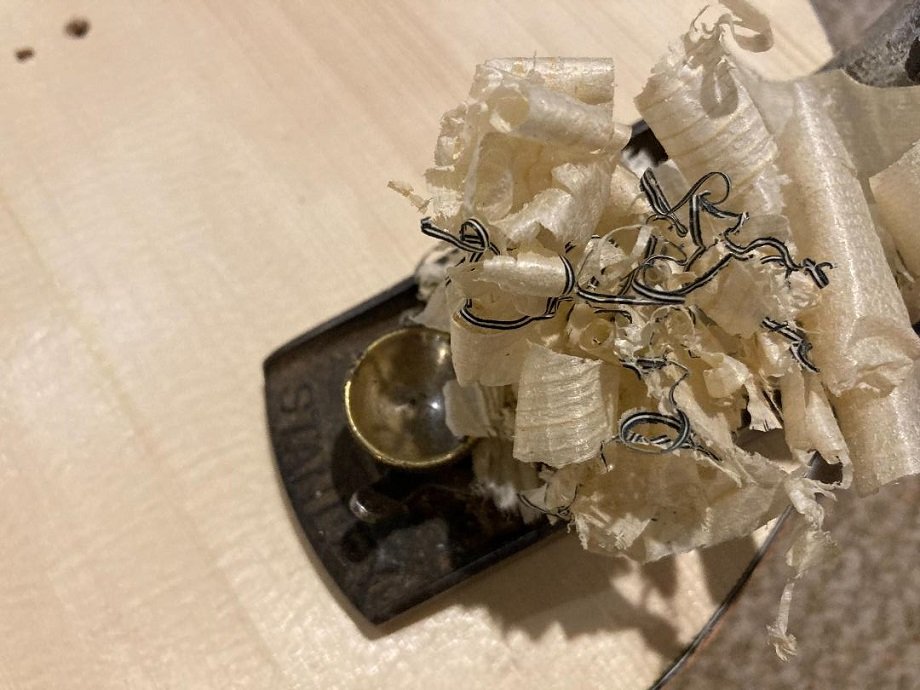

Like probably more than a few Shopsmith guys, I really don't like handheld routers. I've been trying to use a manual knife-edge "purfling cutter" (see separate forum thread), which was a noble idea but has been fraught with mistakes. Anyway, I'm doing the back of the guitar before trying the top / face, and I think it'll be OK once I apply my hard-knocks lessons:
Purfling Concave Cut.jpg (123.87 KiB) Viewed 38075 times
Purfling Gluing.jpg (214.11 KiB) Viewed 38075 times

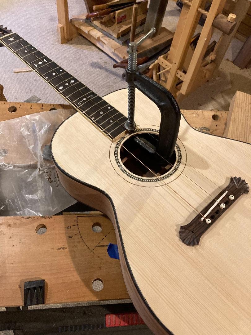

For the bridge position, I had checked and re-checked where it belonged, and I finally glued it down:
Gluing bridge.jpg (133.95 KiB) Viewed 37963 times
Then it was time to commit the neck-joint, the dovetail joint which I had fined-tuned:
Gluing Neck.jpg (162.47 KiB) Viewed 37963 times

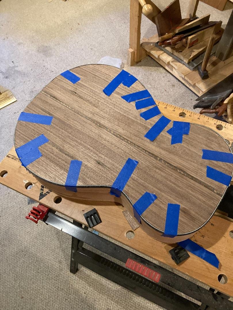

The guitar is playable now! My favorite view is looking inside at the walnut back and the bracing for it:
Looking Inside.jpg (147.03 KiB) Viewed 37963 times
Recalling the original guitar, the resto-mod is definitely improved! It does sound richer. It is also working with a better action, and less buzzing of the strings. The original guitar had a shim under the bridge-insert which is no longer needed. The whole thing is a worthy upgrade... I just need to finish the surfaces. The spruce top and the walnut back were joyful to work with. The mahogany sides fought me all the way with their reversing grains, and they will have a good deal of filler applied before it's all sealed up:
