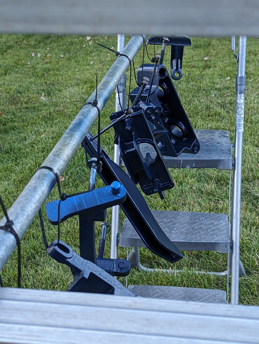

Thanks to the great post & pics here as I can reference while assembling so that it is going together right the first time, BIG help!

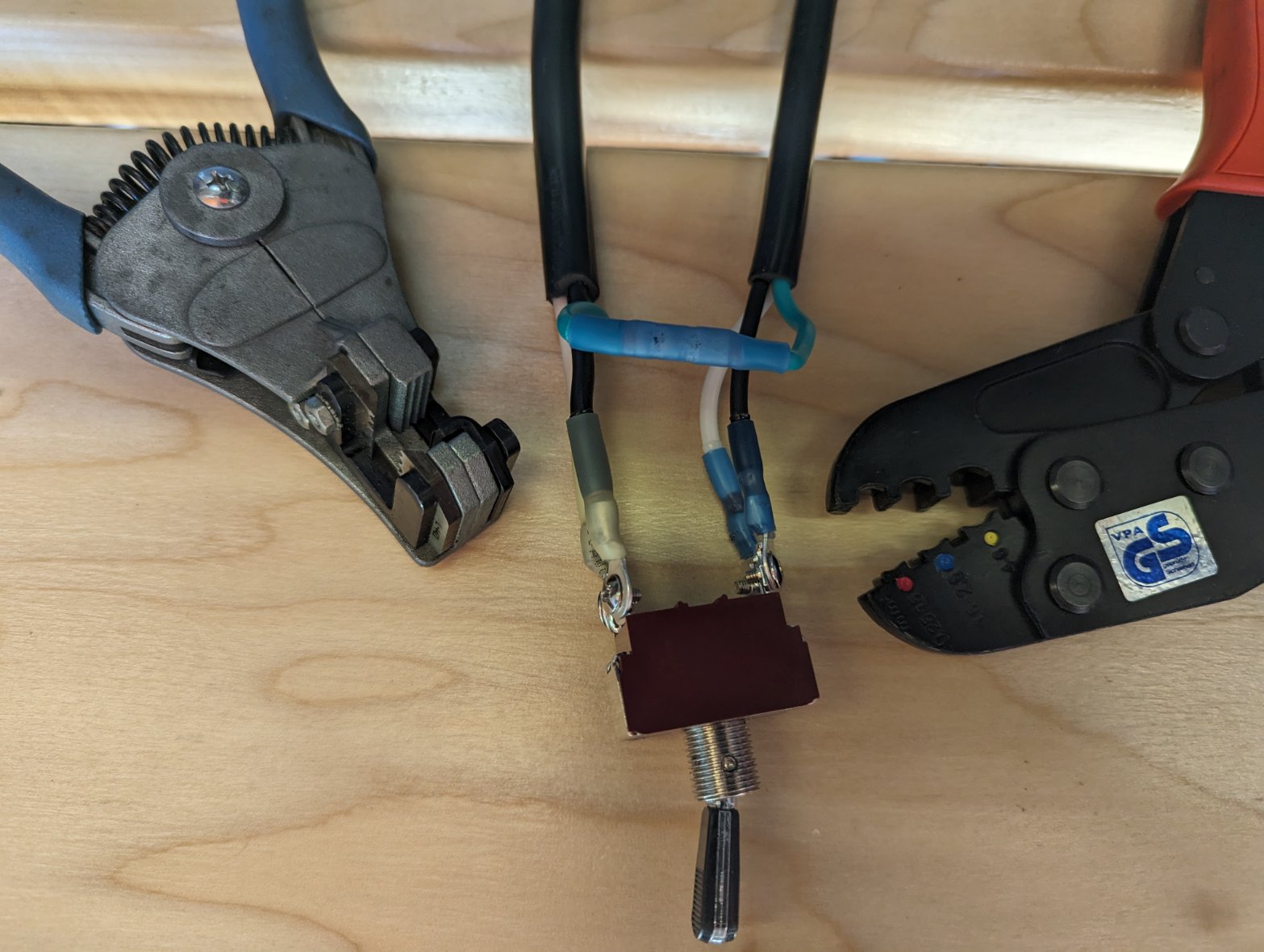

I managed to rewire a new switch & power cable today, was hit with 30K volts as a kid soooo not crazy about wiering for some reason but when I flipped the switch no breakers tripped and the motor spins so calling that a win!
Followed one of the post here and added the ground to a motor mount bolt same as per the pics on the post but since it is not directly contacting bare metal how will that work?

Scrape the paint off where the bolt attaches.

Sounds like the right solution but gonna be hard scratching up my new paint job

When I do my restorations, I replace the power cords and add the ground. As John said remove any paint in the contact area the ground wire is attached to.

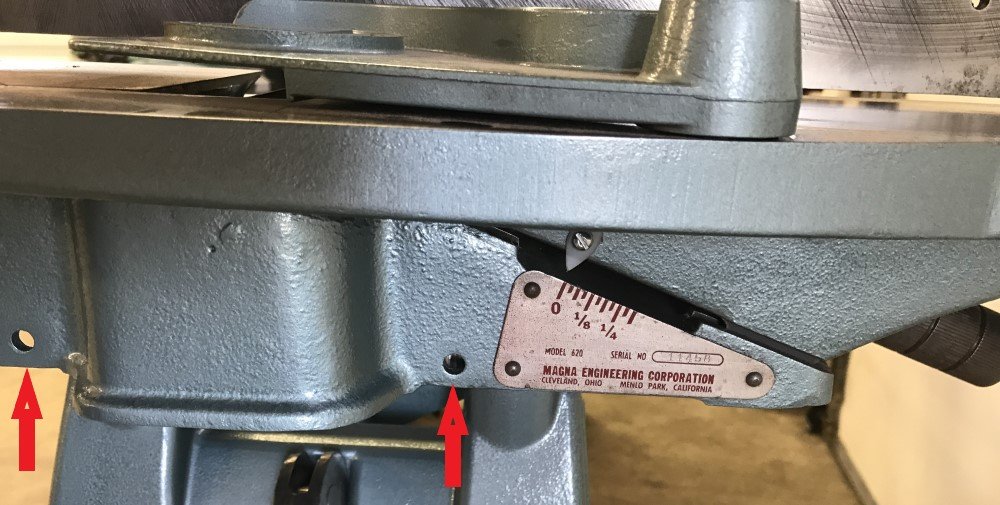

Magna Model 620 4" Jointer Serial Number 23335 was made in November 1954. If you are close enough to pick it up, you could go for the Jointer you found. It doesn't show a shipping option. Do check if it has all the parts. This has the early Cutter Head so check that all the wedges and screws are there. The Knives are the same as current ones so if they are damaged replacements are easily found. The Jointer Fence has a simi circular part riveted to it that matches the groove in the Quadrant that if missing cannot be ordered separately from the Fence from Shopsmith. I don't see in the pictures the Adjusting Knob for the cut height. That would be the knob you see on the underside of the Jointer next to the arrow in the picture below.

I would, and actually have, replaced the Jointer Fence Tilt Quadrant as opposed to trying to "fix" it. My Model 4E Jointer I restored had a stripped Quadrant just like the one you found. The current Jointer Fence Tilt Quadrant part number 502651 which sells for $44.07 is the same as the ones in the original Jointers. The Jointer you found has a couple safety upgrades with the back of the fence Cutter Guard and the Drive Shaft Guard.

Okay I' am gonna sand off some of my shiny new paint to get a good ground but that spot is getting some dielectric grease cause rust has insomnia and never sleeps.

Use an external tooth lock washer between the lug and the frame.

The Mounting Holes on the Model 620 Magna 4" Jointer are in the same place as the Model 4E Magna 4" Jointer as indicated by the arrows in the picture below.

I wish I had kept the Jointer in the picture above. It is serial number 11458 and the lowest Model 620 Jointer serial number I have seen. It was probably made in January 1954 which is before the introduction of the Mark 5 in March. It had been painted gray before I got it and likely to match being on a Model 10.

JPG, I like the external tooth lock washer idea but gonna add the dielectric grease anyway because I have a new tube that will most likely outlast me.
Just for fun, pic I called Shopsmith laundry day
