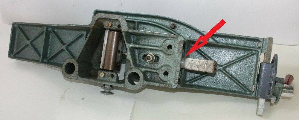

Magna Model 620 4" Jointer Serial Number 23335 was made in November 1954. If you are close enough to pick it up, you could go for the Jointer you found. It doesn't show a shipping option. Do check if it has all the parts. This has the early Cutter Head so check that all the wedges and screws are there. The Knives are the same as current ones so if they are damaged replacements are easily found. The Jointer Fence has a simi circular part riveted to it that matches the groove in the Quadrant that if missing cannot be ordered separately from the Fence from Shopsmith. I don't see in the pictures the Adjusting Knob for the cut height. That would be the knob you see on the underside of the Jointer next to the arrow in the picture below.
_
Model 620 underside arrow.jpg (70.46 KiB) Viewed 6947 times
I would, and actually have, replaced the Jointer Fence Tilt Quadrant as opposed to trying to "fix" it. My Model 4E Jointer I restored had a stripped Quadrant just like the one you found. The current Jointer Fence Tilt Quadrant part number 502651 which sells for $44.07 is the same as the ones in the original Jointers. The Jointer you found has a couple safety upgrades with the back of the fence Cutter Guard and the Drive Shaft Guard.

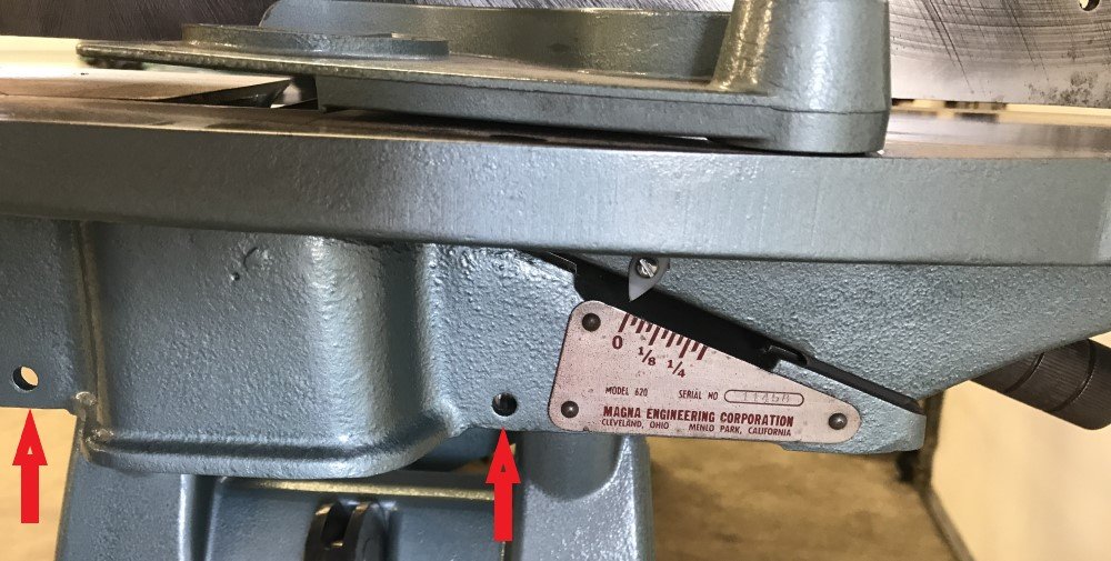

Thanks for the detailed info for this jointer much appreciated and should help with understanding what to look for, unfortunately I didn't notice that 620 was pickup only as it is outside of an acceptable driving distance, were between DC & Baltimore.....Could you please verify that you said a model 620 will mount to the adapter I just bought in case I run across a good deal on a 620.

The Mounting Holes on the Model 620 Magna 4" Jointer are in the same place as the Model 4E Magna 4" Jointer as indicated by the arrows in the picture below.
_
620 extra mounting holes - arrows.jpg (121.88 KiB) Viewed 6897 times
I wish I had kept the Jointer in the picture above. It is serial number 11458 and the lowest Model 620 Jointer serial number I have seen. It was probably made in January 1954 which is before the introduction of the Mark 5 in March. It had been painted gray before I got it and likely to match being on a Model 10.

What do you think about if I come across a good 620C and the only difference between a model 620 & 620C are those holes, I could add the holes myself if someone could give me measurements off a 620 they had? that would broaden my search even further, was thinking that the measurements would need to come off the reference machined surfaces not the rough casting surfaces to make them reasonably accurate….The full jointer adapter kit came in today and it looks in pretty good shape although it seems kinda expensive now after finding that complete machine with a jointer for $75.
