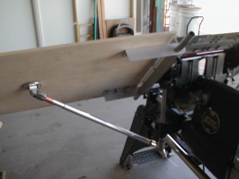

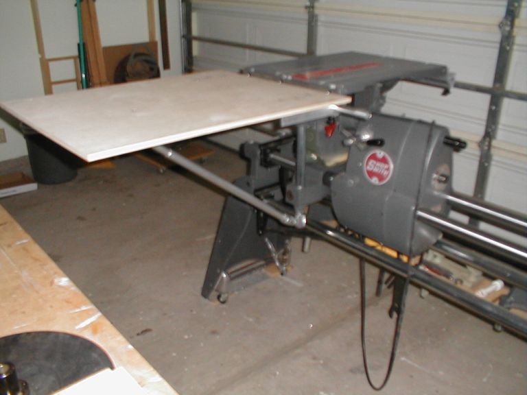

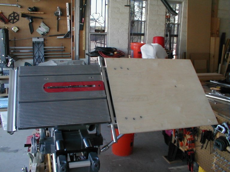

Several of us have been working on our own versions of an outfeed table that Nick posted on this thread. Nicks photos were animated; I haven't figured out how to do that yet. So here are some simple shots that show my initial thoughts on the "Adjustable Outfeed Table".
Sorry about the less than quality photo quality. I'm working on that.
[ATTACH]297[/ATTACH]
[ATTACH]298[/ATTACH]
[ATTACH]299[/ATTACH]
[ATTACH]300[/ATTACH]

- Tilt Far Left.jpg (82.06 KiB) Viewed 24864 times
- Table Brackets.jpg (47.79 KiB) Viewed 24852 times
- Tilt Far Right.jpg (45.51 KiB) Viewed 24852 times

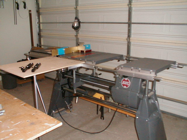

Here are a couple of other shots of my "Outfeed Table", some before and some after modification.
- Original Outfeed Table.jpg (59.87 KiB) Viewed 24772 times
- Adjustable Outfeed Table.jpg (55.24 KiB) Viewed 24769 times
- Tilt Far Right.jpg (45.51 KiB) Viewed 24761 times

I used a piece of 1" steel pipe; it is actually an axle rod out of a forced air cooler. The axle of a large squirrel cage fan. Something we quit using 10 or 15 years ago when we got air conditioning. I parted it out and have been saving it for when I needed it. However, they sell them at Ace for about $15.
I used about a 6" inch piece and had it turned down about .03" so that it would go up inside the vertical column. I then drilled/tapped the column and the pipe for a set screw that holds the two together. Leaving 2" of pipe protrude out the bottom of the vertical column.
I made certain that the setscrew was flush with the surface so that the table could be removed from the SS without pulling the pipe from the vertical column.
The part that attached to the "turned pipe" and the adjustable leg for the table are standard SS. One of the two adjustable legs that came with a SS. Made up of 514529 and 514520.
I'll post some pictures.
Sidenote: The id of the vertical columns on the SS are NOT all the same. Since SS doesn't insert anything there, it is "apparently" not a spec'd parameter. You get what you get.
I have three pair of vertical columns. I carried two of them with me when I went to the shop to turn the pipe. We took enough off so that the pipes that we were turning would fit into the smallest of the four vertical columns I had brought for samples. I thought that was a safe approach.
You can guess. When I got home with the newly milled pipes (four of them), none would fit into the columns on my shop SS.
If you are going to attempt this or something similar, just be aware that this is a custom job. No two are likely the same.
All said and done, the pipe could be replaced by a piece of hardwood turned on the Shopsmith that it is going to fit into. That way it would truely be a custom part.
