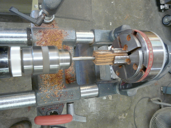

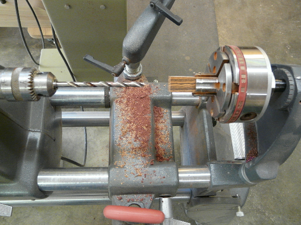

[quote="tom_k/mo"]I just wanted to add a pic of my new Barracuda2 Chuck in action. What a great way to drill a pen blank, centered every time, automatically.
Sorry for all the sawdust.
This is one place you never have to say "Sorry" for sawdust!

Inspired by Toms post, I went to the shop this morning to try a similar setup. I have to say I much prefer this method and now have a lightly used pen drilling jig on CL.
