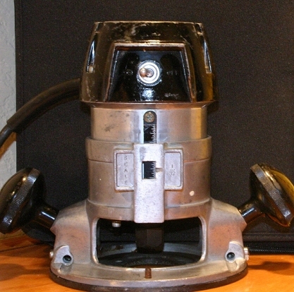

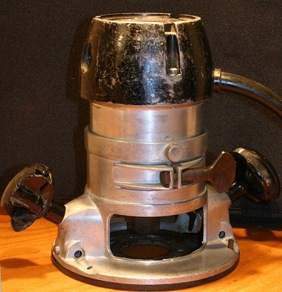

OK guys, I know you'll ALL be green with envy with my recent score so just remember, keep a better eye on your local Craigslist as I did!! :D
Here's my $8.50, 3/4hp beast in all her glory. Don't know if she has the "AHA" feature discussed here but even if she does, it seems it would be an easy fix with some rubber shim stock in between the outside locking collar and motor body.
If you want to visually inspect router more closely, go here and here. Maximize the window and click on the image to enlarge it.
[ATTACH]6450[/ATTACH]..[ATTACH]6451[/ATTACH]
[ATTACH]6445[/ATTACH]

mickyd wrote:OK guys, I know ALL you'll all be green with envy with my recent score so just remember, keep a better eye on your local Craigslist as I did!! :D
Does the round brownish looking thing allow movement of the '1/32" scale' up/down? What is under the raised nub in the second pix?(anti-rotation pin?) It seems to be a newer version of my movable index(do not know it they were referred to as AHA, but mine is not very useful/accurate.
How is the body raised and lowered into the base?
I am surprised the 'clamp' is not fatigued!
You can turn a replacement knob on the greenie I . . . . . . . . If you can bear to get wood debris on it.:D

JPG40504 wrote:Does the round brownish looking thing allow movement of the '1/32" scale' up/down? If your looking directly above the scale, the answer is NO. That's just a phil pan machine screw that attach's the scale to the body. If looking somewhere else, direct me better. What is under the raised nub in the second pix?(anti-rotation pin?) I'll have to look and see tonight. It seems to be a newer version of my movable index(do not know it they were referred to as AHA, but mine is not very useful/accurate.
How is the body raised and lowered into the base? In the picture showing the back, you see a brown thumb screw in front of the right handle. You loosen that and it releases the clamping pressure.
I am surprised the 'clamp' is not fatigued! Hopefully it isn't. It will be all over for the router when it does I believe. I will lose my investment.

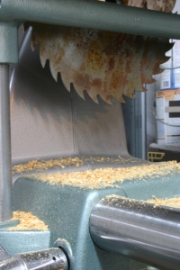

You can turn a replacement knob on the greenie I . . . . . . . . If you can bear to get wood debris on it.:D I was planning on doing that. (and....to let you know..... she already has seen debris, just plain old construction debris...nothing worth posting. see exhibit for proof and NO comments about my blade!!!)
exhibit
[ATTACH]6452[/ATTACH]
