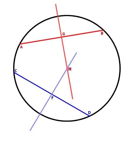

The other day I was reading through one of the issues of "Wood Magazine" from the late 80s that was included along with my Mark 5. There was a small article about finding the center of a circle using a compass. It seemed a bit too complicated to me. This is an easy method:
Draw two straight lines that intersect the circle, but not each other (AB and CD in image below). Find the midpoint of each segment (F and G in the image below). Make another line perpendicular to the original lines at the midpoints. Where those lines intersect is the center of the circle (H in the image below).
The midpoint can be found, and a perpendicular line drawn using a compass. Open it to a distance greater than half the length of the line. From each end of the line (really called a "segment" in geometry - a "line" has no end point) make an arc on each side of the line. Draw a line through the points where the arcs intercept each other and you have a perpendicular line exactly on the midpoint of the original line.

heathicus wrote:The other day I was reading through one of the issues of "Wood Magazine" from the late 80s that was included along with my Mark 5. There was a small article about finding the center of a circle using a compass. It seemed a bit too complicated to me. This is an easy method:
Looks like the compass/ruler method(better than compass only, no approximation at all).

Heathicus drew up the method! This is used by archiaologists to find the actual size of a pot or bowl from a shard of pottery. By simply drawing the outline of the shard on paper and using this method to locate the center , the diameter can be found. I listened to Gabrial on the radio in my grandpas dairy barn.

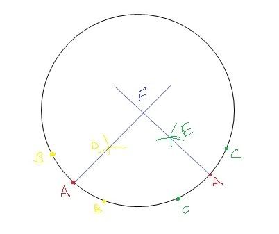

I came home tonight and found the instructions in "Wood Magazine" for finding the center of a circle. My scanner is broke, so I can't scan the page. I don't have a decent image editing program on the tablet PC I'm using, so I just sketched it out real quick in Paint. The instructions below are re-typed as they appear in the magazine (not as complicated as I was thinking it was!):
From any two points (A) on the circumference, use trammel points to mark equidistant points (B and C) on both sides of both starting points. Then open up the distance on your trammel points a bit, and arc from each of the second pair of points (B and C) to determine two interior points (D and E). Use a straightedge to connect your two starting points (A) with the interior points (D and E). Now you have it: The center (F) will be the point where those two lines (A-D and A-E) meet.
