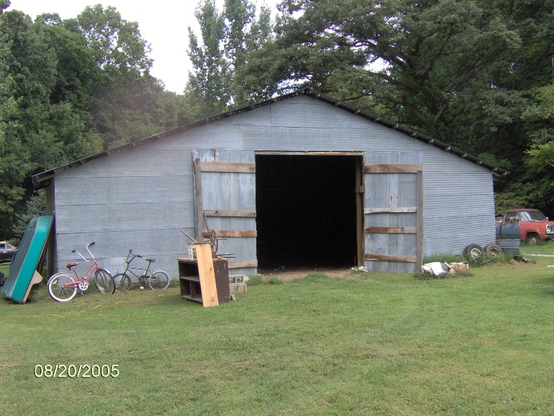

BTW, here's my "shop" ... (this picture was taken before I cleaned it out, poured a concrete floor and ramp, wiring, pegboard walls, shelving, etc.)
[ATTACH]8383[/ATTACH]
