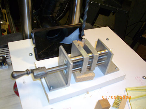

Several weeks ago on another discussion I related my process for turning pens. At that point I did not share pictures of the jigs I have built for cutting blanks on the band saw and drilling them. They are attached here. jim
