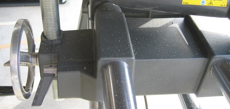

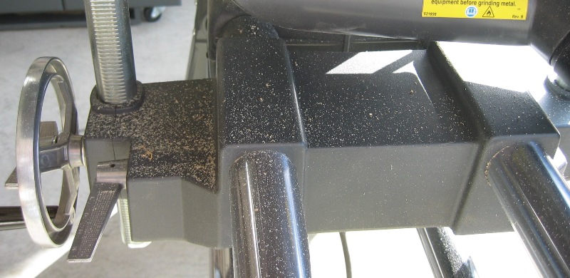

I had a chance to visit mbcabinetmaker's shop yesterday (very very nice!) and we talked about several Shopsmith related issues one of which was the baffel for improved dust collection. After seeing his, I had to give it a go for myself. Here's what I came up with...
This is my results without a baffel - I cut about 6.5 feet of 2x4.

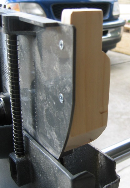

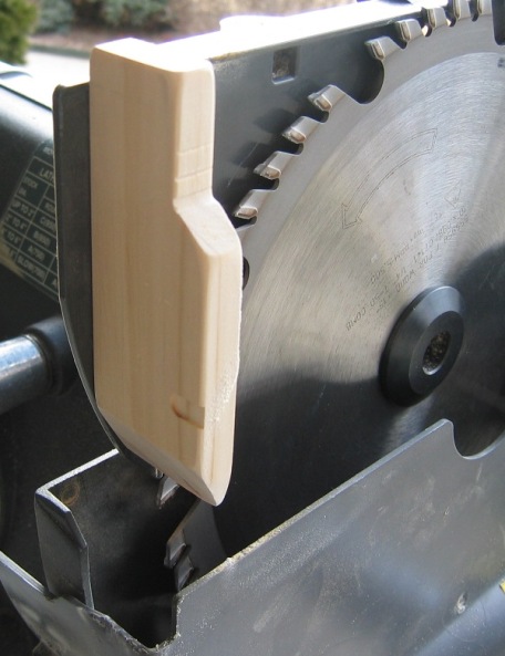

Here's what it looks like mounted to the lower saw guard. It is made from a piece of 1/2" pine.
[ATTACH]16057[/ATTACH]
[ATTACH]16058[/ATTACH]
[ATTACH]16055[/ATTACH]

- DC_Before.jpg (118.5 KiB) Viewed 4765 times

- DC_Right.jpg (73.23 KiB) Viewed 4761 times
- DC_Left.jpg (76.52 KiB) Viewed 4760 times

Bill: You have used a different baffle format but you have done essentially the same thing as I did.
I am curious though about how you decided how wide to make the lower saw guard.
I have one that is about the same and one that is about 1/2 that size. I am trying to determine which one is best.
I am also trying to determine if there is any functionality that we are disabling by eliminating this adjustibility.
