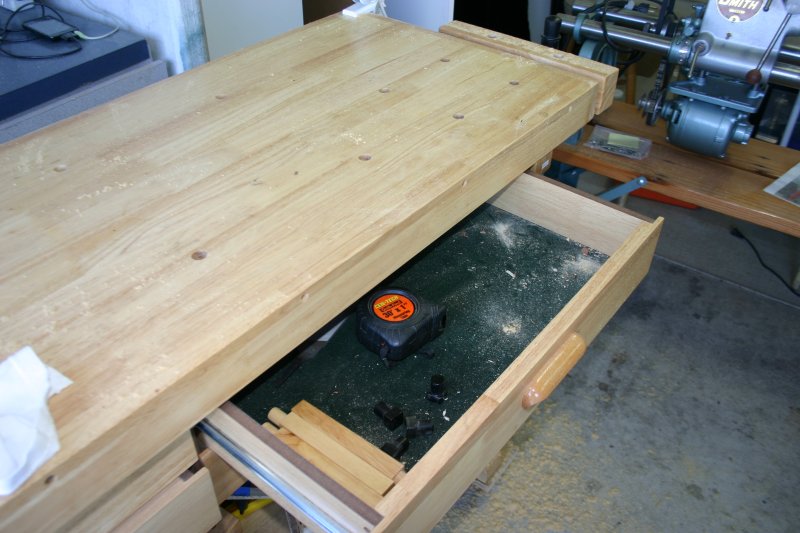

Geez Troy, and all this time I thought my Harbor Freight workbench drawers were lined with felt. Thanks for ruining a good thing!!horologist wrote:I relined the drawers of a machinist chest....

Ahhhh, my work here is done!mickyd wrote:Geez Troy, and all this time I thought my Harbor Freight workbench drawers were lined with felt. Thanks for ruining a good thing!!I find out now the stuff is 'flocking fiber'.
Seriously, the flocking looks like a really great idea after cutting all those bits of felt for my machinist chest. No doubt there are unforeseen problems with this stuff as well.
I am surprised that the drawers of your workbench have this treatment. Seems like an excellent way to trap sawdust.

No dust on MY 'flocking fiber'!horologist wrote:Ahhhh, my work here is done!
Troy
[ATTACH]10129[/ATTACH]

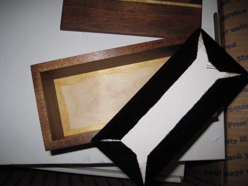

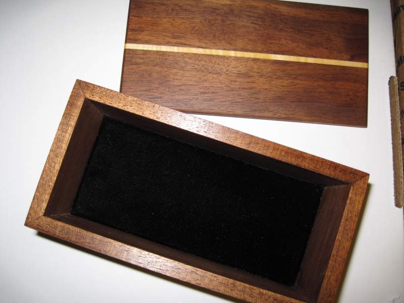

Steve, I've made a good number of jewelry boxes over the years and would line the bottoms mostly with black velvet. I've also used faux suede that was called doe skin, but most any dense fabric should work. I used mat board from an art supply store.
My procedure was to cut the mat board about 1/32 to 1/16" smaller in length and width than the inside of the box. Then cut the fabric so that it's about an inch larger all around than the mat board. Use spray adhesive to coat one side of the mat board and then center it on the back of the fabric and lightly press the mat board and fabric together.
Next, with the mat board facing up, I'd place a slat of wood about 5/8" wide against the edge of the mat board and trim the fabric using a rotary cutter.
Next, I'd fold that edge over the back of the mat board, but before doing that you need to trim the corners of the exposed fabric so that you don't overlap the material and create lumps. I trimmed these to something over 45 degrees. Leave a bit of material right at the corners so that when you fold over the fabric you don't see the mat board.
To secure the fabric on the back side, I used double sided tape from an office supply store, like Staples. It's made by Scotch and 1/2" wide. I'd apply it around the perimeter of the mat board and then fold the fabric over and press it into place. You could try the spray adhesive again here, but it gets a bit messy and could be transferred to the show side of the fabric.
When finished, there should be a relative tight fit to the inside of the box. The fit depends on the thickness of the fabric you're using and how much smaller you cut the mat board in relation to the inside of the box.
Here are a couple of pictures of a 3" x 6" walnut box and the fabric insert. Not the neatest of bottoms, but it's all hidden with a tightly fitting insert.
[ATTACH]10210[/ATTACH]
[ATTACH]10211[/ATTACH]

These are fine enough for the average user. I would venture that 99% of users would never look underneath to see how it is put together. Only the inquisitive mind such as those of us who are doing the woodworking and wondering how this stuff is made would even think to look underneath to see how it is made. Most everyone else would simply admire it as it is a fine job. Thanks for showing this. Great work and thanks for posting. Your explanation is exactly what I was thinking about before I heard about the flocking and saw it demonstrated on a DVD with George Vondriska. I have a whole series of his DVD's and he gives some really good points and has helped me to think about the whole process of a project rather than just the end product. I like to build things and I don't always have the quality of the process engaged until near the end and then have to retreat to get it up to the standard desired. Your explanation is great and your work is fine. Thanks for sharing. I learned something else.
