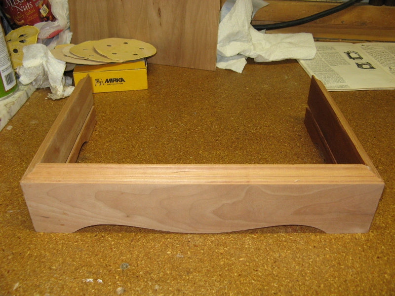

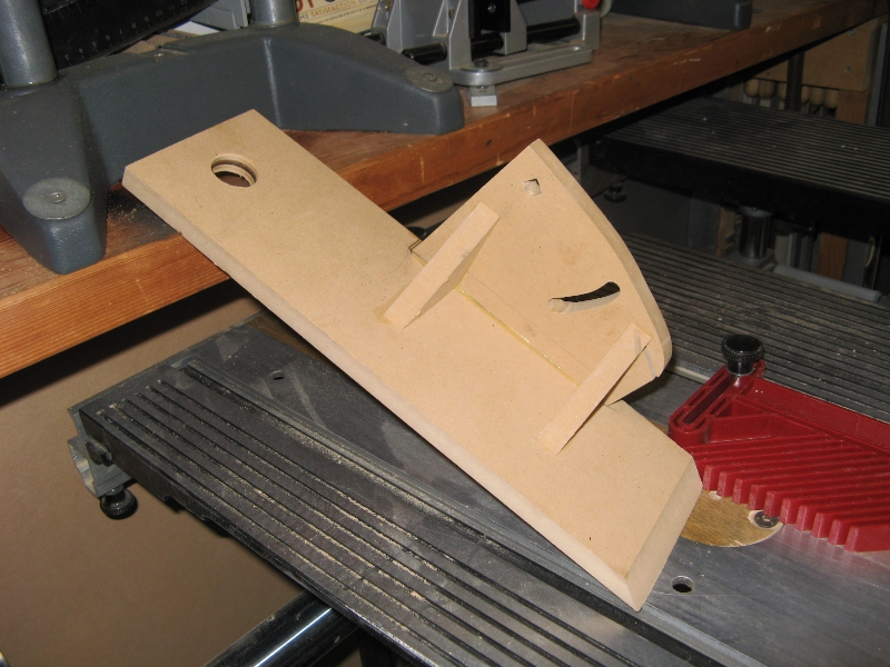

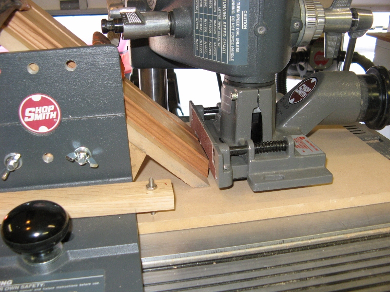

I assume you are referring to a Shopsmith biscuit jointer. Picture 1 shows the 45 degree joint I reinforced with a biscuit. Picture 2 & 3 show the jig I made to accurately cut the biscuit slot. The jig can be adjusted for almost any angle.garycd wrote:Has anyone tried using the biscuit joiner with beveled (I have 36 degree bevel edges) edges? Making 3D Texas stars and need to use biscuits with them. Thx
[ATTACH]23794[/ATTACH]
[ATTACH]23795[/ATTACH]
[ATTACH]23796[/ATTACH]
- a2.jpg (423.27 KiB) Viewed 1996 times
- a1.jpg (418.83 KiB) Viewed 1992 times
- a3.jpg (369.79 KiB) Viewed 1995 times
Glenn
- Posts: 35457
Now ain't that just plain slick!stumpbuster wrote:I assume you are referring to a Shopsmith biscuit jointer. Picture 1 shows the 45 degree joint I reinforced with a biscuit. Picture 2 & 3 show the jig I made to accurately cut the biscuit slot. The jig can be adjusted for almost any angle.

Ok, I was thinking about that the wrong way. I assume you are using the Tenon Master Jig to hold the custom made jig, correct? Thanks for the pics, that makes it perfectly clear now.
