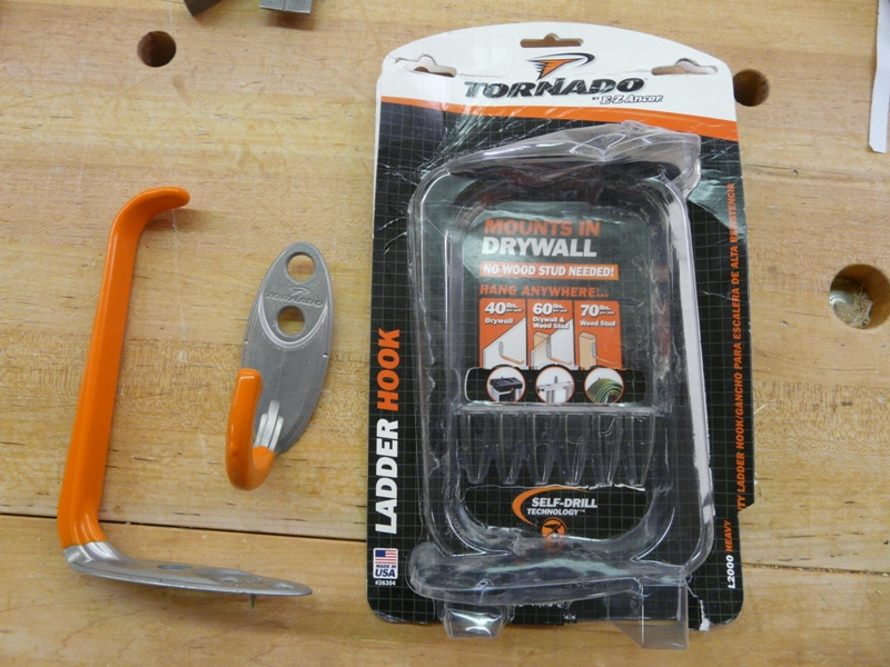

I have been buying a few of these hooks along the way. They are a little expensive but work great. Today while cutting some corbels on my band saw I had to change blades so I decided to do a little improvement project for my blades and band saw fence.

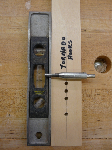

Since I plan to use more of these in the future I decided to make a simple jig to locate the holes. I can use my torpedo level and a vix bit to mark where i need to drill 1/4 inch holes.
[ATTACH]14991[/ATTACH]

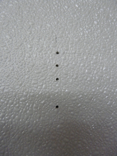

Holes located.

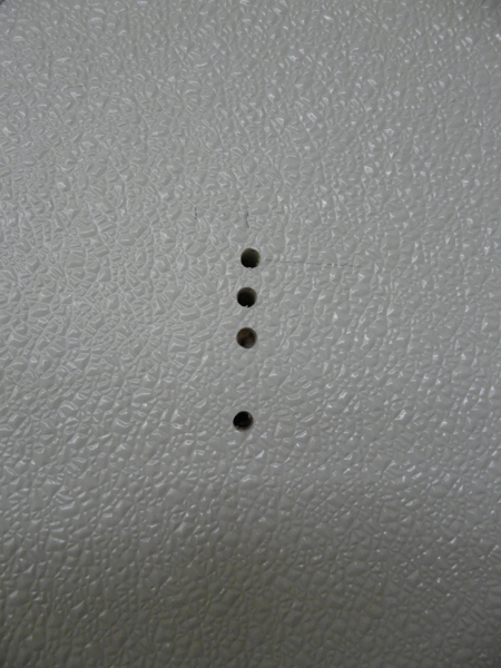

Holes drilled.

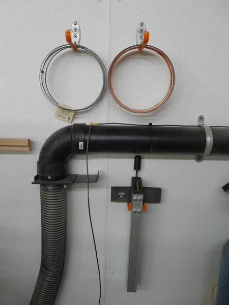

No more bandsaw clutter!:cool:
Wow! This went a lot smoother than the last project.:D

Second hole from top for the locating tab on the back?
Holes drilled shown is the one on the right.
Are the pieces on the top holes NOT shown in the first pix?:confused:
What wall anchors come with that?
mbcabinetmaker
Posts: 1627
Location: Greer SC
Post by mbcabinetmaker »
JPG40504 wrote:Second hole from top for the locating tab on the back?
Yes to question #1.
I am confused at the next to question.:confused:

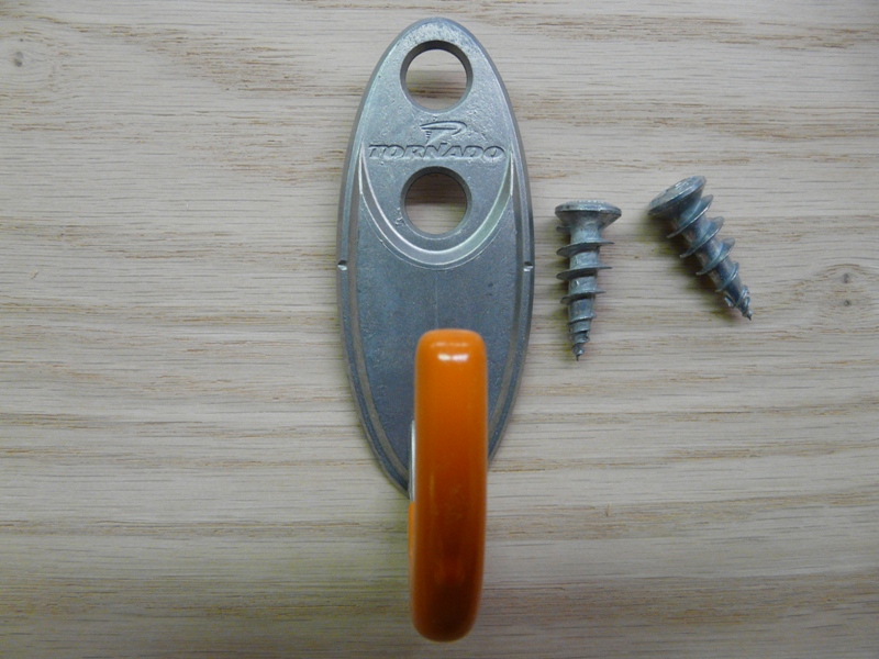

Some of the hooks require 2 screws and a 3rd hole for the tab. Some require 3 screws and a 4th hole for the tab. They are designed (tabs)to be driven into drywall to hold the hooks in place while you drive the screws. I am going through the marlite board so I am pr drilling 1/4 inch holes
[ATTACH]15037[/ATTACH]
Hope this makes more sense.

The top hole on the right hook is slightly mis-aligned to the right as were the holes drilled shown(pilots were in line, but the top one skewed to the right when enlarged.;)
mbcabinetmaker
Posts: 1627
Location: Greer SC
[quote="JPG40504"]The top hole on the right hook is slightly mis-aligned to the right as were the holes drilled shown(pilots were in line, but the top one skewed to the right when enlarged.]
Could be a little off. The marlite board has a texture that tends to lead the drill bit. Also could be exaggerated by the camera.
