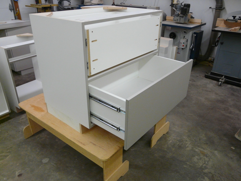

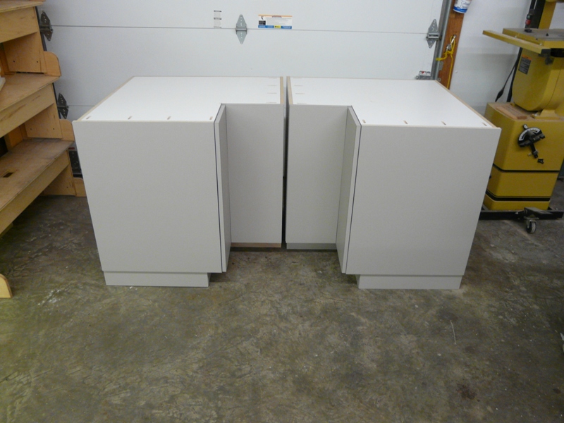

[ATTACH]15633[/ATTACH]
[ATTACH]15634[/ATTACH]
[ATTACH]15635[/ATTACH]
[ATTACH]15636[/ATTACH]
I am not as far along as I had planned to be on this project. I am not worried about not hitting the target installation date it is the 4 jobs lining up to hit at once after that that is intrupting my sleep at night. :eek: :eek: :eek:

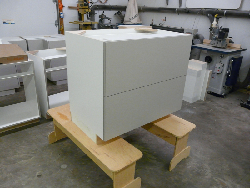

Interesting double hinging!;)
Posts: 21481
Once again, Mark, I am impressed. I literal spend hours reading and rereading your posts. I learn something every time I log in. Your operation is one that I would have enjoyed apprenticing in.
I can't duplicate your results but what I have learned from your posts has helped to improve my work.
Posts: 35433
One thing I have noticed, and I think significant enough to deserve highlighting is the fitting of the drawers separate from the fitting of the drawer front. I have noticed that in previous post(s), but it is very obvious in this post in the next to last pix.
Keep it coming!!!:)

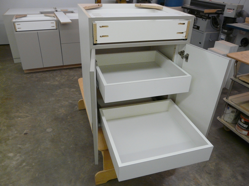

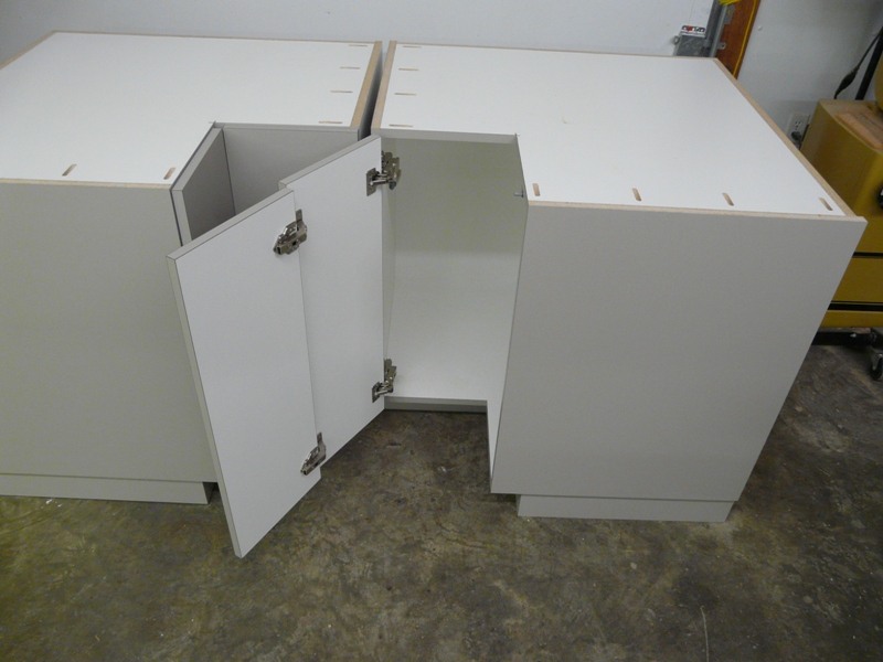

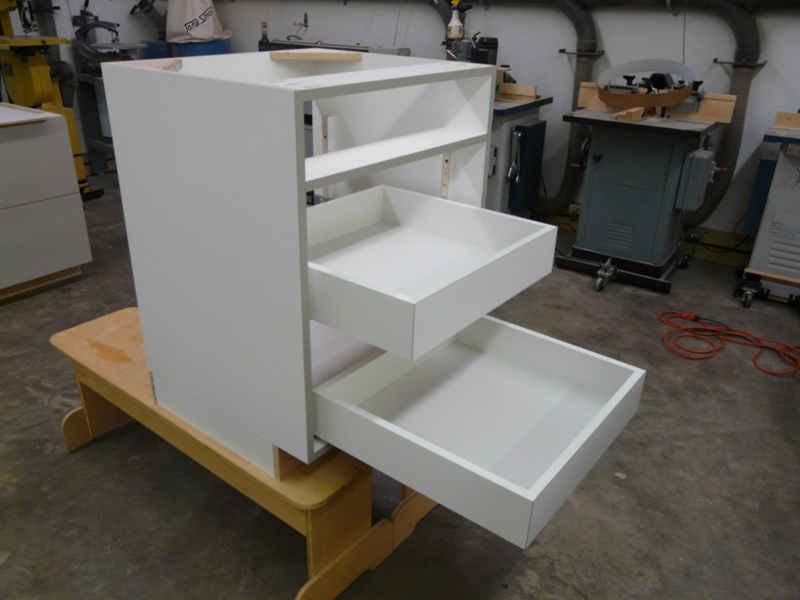

[ATTACH]15648[/ATTACH]
[ATTACH]15649[/ATTACH]
[ATTACH]15650[/ATTACH]
[ATTACH]15651[/ATTACH]
[ATTACH]15652[/ATTACH]
I fell 2 drawer fronts short of my goal today. Oh well I will just do like farmer and make a new goal tomorrow. ;)

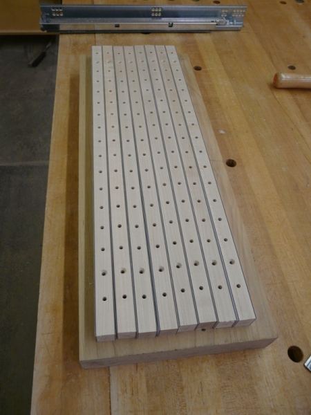

Details please. The inserts: are they hardwood? and how thick (look to be about 1/2")?
Are the screws being used to hold the inserts in the dados as well as the slides to the inserts? or are the inserts glued in?
I gotta go find some of those screws.
I assume NO power driver for those screws into that melamine.

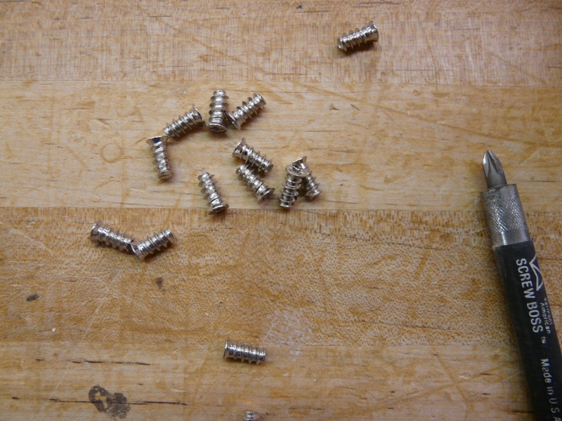

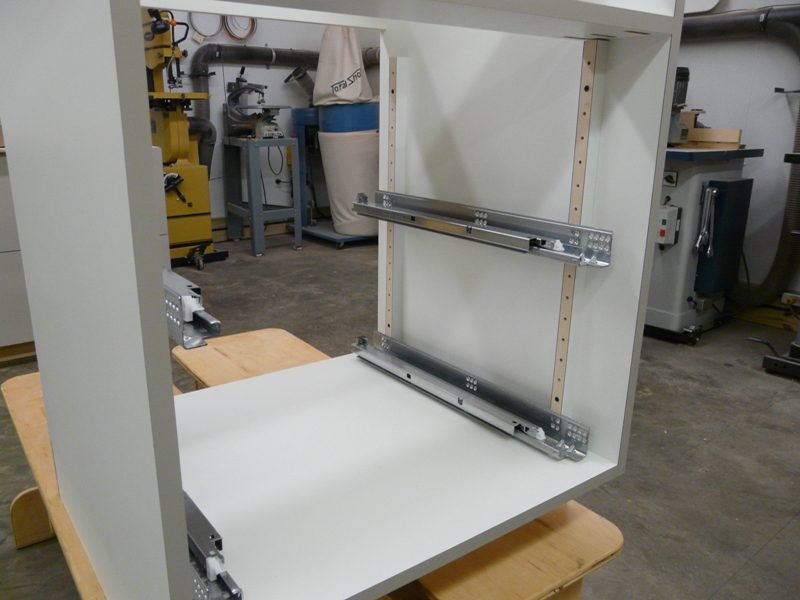

Dusty the pull out shelves and drawers have to be built out to clear the door hinges. With a 1/2" or 3/4" overlay hinge I use a 1" standard of my own design to accomplish that task as well as make them adjustable by using a regular 5MM line boring pattern and what is commonly referred to as a system screw. It actually fits into the 5MM hole. I will warn you that they are soft and I recommend using a #2 Pozidriv® bit and a impact stile driver works best. If it ever slips at all throw the screw away and replace with a fresh one. This is a great sheet on different bit designs.
http://en.wikipedia.org/wiki/List_of_screw_drives
I get the best results using the correct power driver and have standard drills right angle drills and impact drivers of each. About the only driving that I do by hand is to adjust the door hinges and I use a special Blum brand screwdriver for that.
I used maple for these standards and just covered the sides that are most visible. I have covered the entire standard and drilled through the laminate before but I get some tear out around the holes and I think this is a little neater. I my go back and paint the maple edge. I have attached the standards to the cabinet with the regular square drive screws that I use using two of the standards holes that I have counter sunk and drilled through.

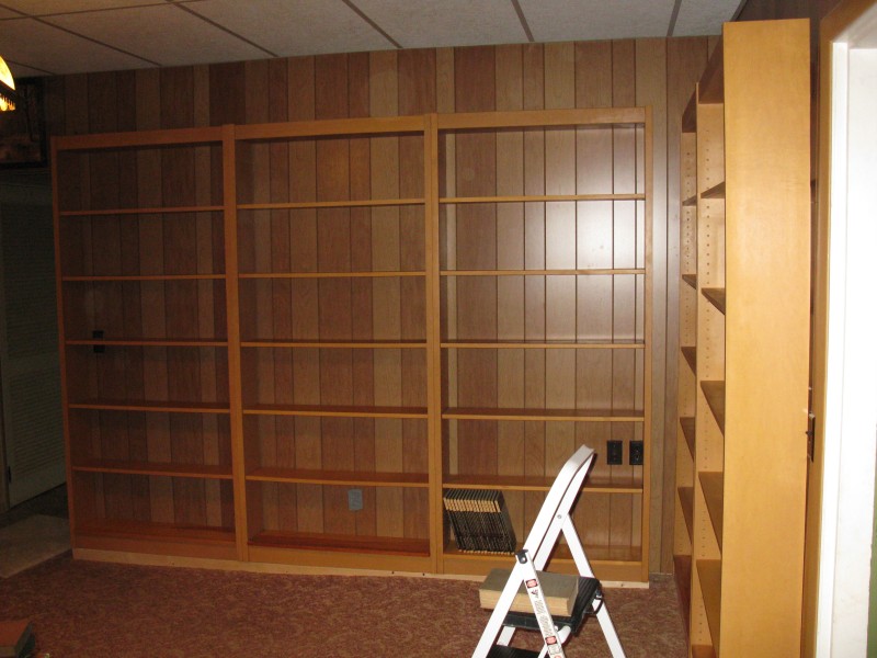

dusty wrote: Mark: Are the inside corners in all of your carcass' absolutely square? I try and try and never succeed. They are close but not right on. My individual pieces are properly sized. The corner cuts are all square. The dados/rabbets are all properly sized. Then comes glue up and close is the best I get.
Here is a shot from my recent library project showing the coped strip at the bottom between the shelves and the floor that it took to reach a level line.
[ATTACH]15664[/ATTACH]
That part of the house was built around 1840 and then moved to this location about 1900. There are no signs of settling. Basically the difference was from it just being "good enough". :) People lived a lot differently back then and floors were not given the attention they get now. I have seen a lot of historic homes (even Mt. Vernon) that were quite fancy but the floors were commonly just rough planks.
I have 3 100+ year old barns and in spite of "old time craftsmanship" I can find dozens of mistakes, mis-cuts and re-cuts all through them. Then again for their need they were "good enough". :)
This original house was as I understand its history built for tenant farmers and many such houses were not built for show. My father and I re-sided it in the late 1950's with ceder shake shingle siding. We spent weeks shimming with pieces similar to what I used under the book shelves just to get a flat surface because the original frame was so crooked. Then again, for tenant farmers it was considered "good enough". :)
While you feel that you are only getting "close" look at the work of others with a square in hand and you will find that in most cases they too are only "close". :)
