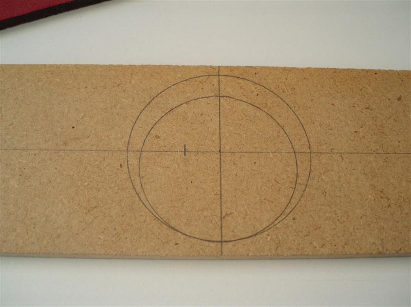

I sorta wish you had not asked that question right now. Here's why.
[ATTACH]16275[/ATTACH]
They are on the center line of the arbor (the drill line) but offset on the other axis.
One is the shaper insert (smaller) and the other is the drum sander insert (larger).
I don't do much shaping so I am unable to comment as to why the hole in the shaper insert is offset as it is.
Note: the vertical line is the drill line and the horizontal line is the insert center line.

Relax Dusty. There is no need for the round table inserts to be in any particular location (left to right)[in/out when vertical]. But being on the drill line is relevant.dusty wrote:I sorta wish you had not asked that question right now. Here's why.
Let this be. It is a .non-issue.
I realize that and I realize that by adjusting the table either insert can be centered on its center line.JPG40504 wrote:Relax Dusty. There is no need for the round table inserts to be in any particular location (left to right)[in/out when vertical]. But being on the drill line is relevant.
I am curious as to why one is manufactured centered and the other is not. There is a reason. I have learned that the Shopsmith was designed by a skilled engineer. It did not just happen.
dusty wrote:I realize that and I realize that by adjusting the table either insert can be centered on its center line.
My bump has been aroused as well! However I do not have the two versions to ponder.
Only thing I have come up with is that offset brings the opening closer to the shaper fence. (assuming it is offset that direction).
