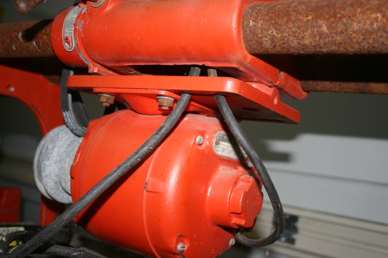

Installed the 'real' powercord / switch to motor strain relief on the ER headstock today. The OEM method of wrapping it around the motor bracket as show in the post above was just too mickey mouse for me.
When I got my ER, the cords weren't wrapped around anything. They just passed through the slot in the motor bracket.

Designed and installed a 'real' strain relief for the power cord and switch to motor wiring. The OEM method used by ShopSmith of wrapping them around the motor bracket as show in the post abovewas just too Mickey Mouse for me.
When I got my ER, the cords weren't wrapped around anything. They just passed through the slot in the motor bracket. Accident waiting to happen. Any tug at all would have either damaged the off / on switch OR pulled the ring terminal off the wire risking electrical short.
