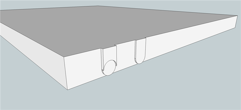

pennview wrote:One thing you might want to check is whether the three bosses on the main table are on the same plane. Perhaps the fence is true enough to use for checking or possibly a decent level will show if there's a reason for the shorter spacer. You could also check how the bosses line up with the bosses on the auxiliary table.
This is somewhat off topic except that I checked the bosses on my tables only because of this thread. My tables have bosses that have been milled in two different fashions. With either style, the pad where the spacer rests is 1/16" proud of the table side.
[ATTACH]17824[/ATTACH]
Pads (Custom).png (40.65 KiB) Viewed 1878 times
So maybe the PO did not tweak after all!
