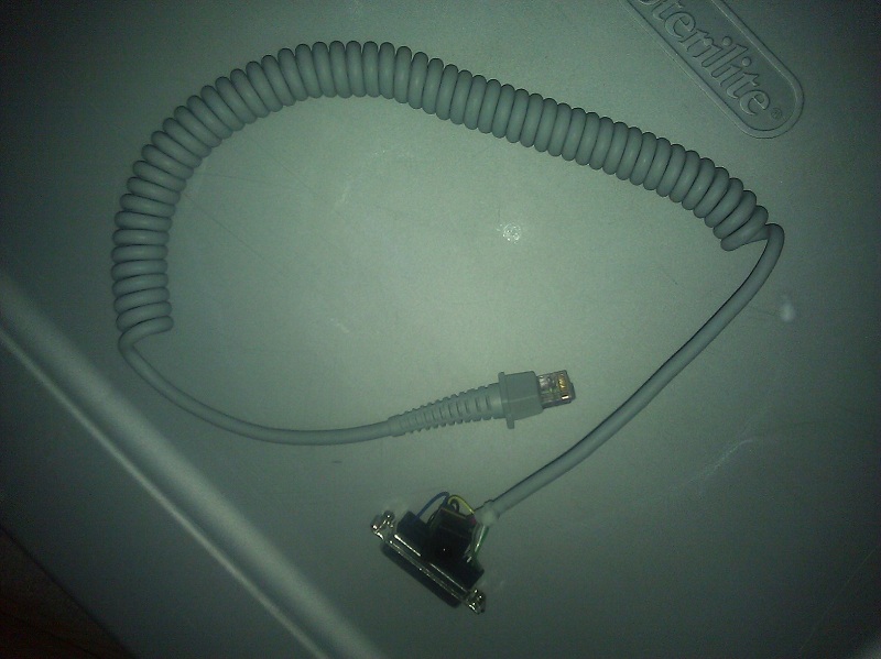

1) Creating an adapter board using an ATTiny or similar microcontroller such that when the Start button is pressed on the remote, it will send a confirm press shortly thereafter. Since the nova remote receiver runs off of the power supplied for the LCD, the microcontroller will be able to do the same. The code for the microcontroller will be pretty simple since you can use the arduino firmware to make prototyping and usage easier.
Secret option number 2:
[ATTACH]18363[/ATTACH]
2) A) Use a cable to extend either extend the whole control panel. As i recall its a 10-pin connector from the control panel to the motor controller, so 10 pins in a cable would be fine. I got this coiled cable as an experiment. Then you make it so the panel can be hooked/set wherever you need it.
-or-
B) simply create a remote panel with start, stop, up, down, and confirm buttons. Since the nova remote just emulates button presses, its pretty straight forward concept to trigger button presses with a similar hard-wired setup.

paulmcohen wrote:I am not sure if you mean you want to remove the panel and relocate it to a different place using your new cable or you want to add a second panel located remotely.
A second hardwired remote panel would be fine with me, removing the existing panel seems like it would create its own issues with keeping things inside of the panel and headstock dust free. Adding a second panel with a wire could be interesting with there was a quick disconnect so it was only used when needed and would not get in the way (assuming two parallel panels would actually work together).
A third option might be a remote soft "STOP" button (vs. shutting the power which involves a long boot time), this would address 90% of what I want.
Both are viable options.
For just a stop button you would need two wires and a button.
For the remaining buttons (if desired), you would need one wire for the common and then one wire for each button. Put it in a little project box and you are good to go.
If you wanted to move the whole panel, my thougth was to do somehting like a z-clip or magnet. basically cover the existing speed control hole and have a mating attachment to the back of the current panel. Then add the wire and go. Will try to mock up something like this.

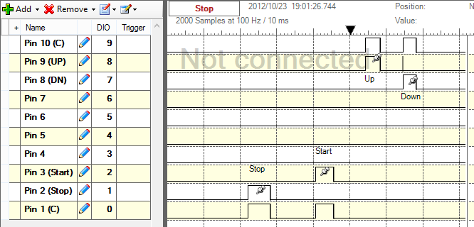

Sorry for the lack of updates, though I know for many this is greek (or worse - geek:rolleyes:).
I adjusted the diagram above based on doing some analysis with my logic analyzer.
[ATTACH]18901[/ATTACH]
Basically, the circuit will immediately pass RPM up/down, but there is a slight delay for start/stop because of the need to determine if its a press or a press and hold. Either way, the remote setup pulls pins high when simulating the button presses. Based on this, should be pretty simple to insert a circuit to watch for pin 3 to go high and then make the confirm line go high as well. Perhaps a safer alternative would be to do a simple state machine to require a second start command from the remote...I will think about it.
