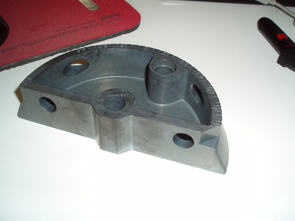

This is a throw back to an older thread but the subject matter may still be of concern for some you.
This resurfaced somewhat due to a problem that I was having with the Mark V in drill press mode. I spoke with Shopsmith and part of their contribution to the solution of my problem was a replacement trunnion. Customer Service, during our discussions asked about my trunnions. Upon discovering that my rear trunnion had 3/8" holes, I was informed that I would be receiving a replacement.
Today it arrived but in addition to the 1/2" trunnion bolt holes, there is another significant change.
Woodhead52 made mention of the rail mounting bolt that interferes with the rear trunnion, making table alignment difficult (to say the least). See post #4 in this thread. Shopsmith has resolved that issue. This along with other occasions makes me believe that they do hear what is said here on the forum.
I have not seen woodhead52 online in a long while but I hope he checks in now and then. His comments did make a difference.
[ATTACH]25988[/ATTACH]
Notice how one corner has been milled off. This allows room for the nut that holds the rear rail to be installed while leaving room for the table to be moved around during table alignment.

Drilling the holes larger, Ed, is only part of the change. Notice the corner that was taken off.
dusty wrote:Drilling the holes larger, Ed, is only part of the change. Notice the corner that was taken off.
Yep saw that, I haven't had that problem yet.
Could you measure and make a drawing of the missing piece in case I decide I want to do something like that in the future? Please and thank you.
Wonder when that change was added?
Question about table saw alignment
reible wrote:Yep saw that, I haven't had that problem yet.
I don't know but I do suspect that it occurred as a result of this series of posts on the forum. It was about this same time that Nick indicated that the trunnion bolt holes should all be 1/2".

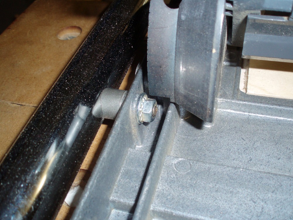

The replacement trunnion has been installed and with it installed the table aligned with no difficulty.
I did forget to use the dollar bill and had to do it all over so that the table would tilt without squealing.
