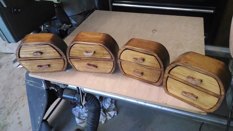

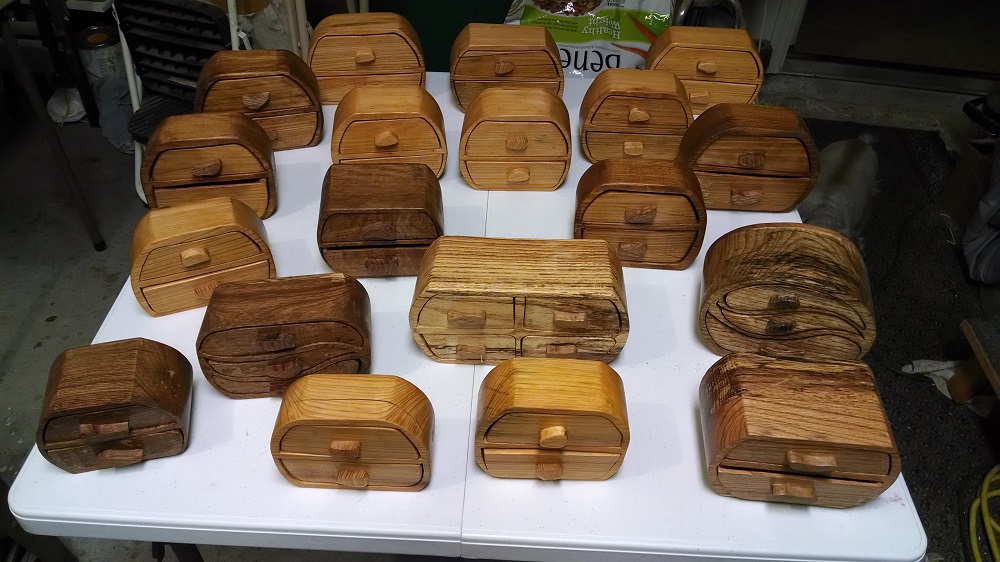

I think I'm set on a design, the two drawer version. It's easier to make and the drawers hold more stuff. Here are the latest 4 that I just finished up today.
[ATTACH]24893[/ATTACH]
Taking my time now, I just spend a couple of hours every third day or so on these boxes.

Those are just outstanding Fred, very nice!fredsheldon wrote:I think I'm set on a design, the two drawer version. It's easier to make and the drawers hold more stuff. Here are the latest 4 that I just finished up today.

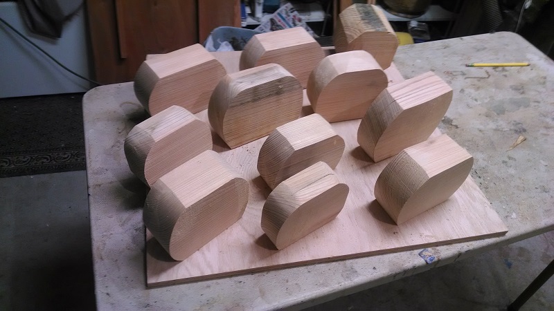

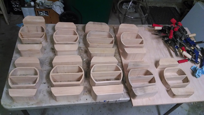

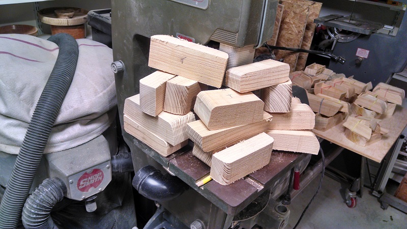

I used my 1/2 " blade in my band saw to rough out 11 more blanks tonight. I used my 12" disk sander to smooth out all flat and curved surfaces. Next I will cut out the drawer plugs.
[ATTACH]24973[/ATTACH]
I'm going to stick with my 2 drawer version with this batch. I will then have 21 boxes, enough to give one to each family in both my wife's and my clans.

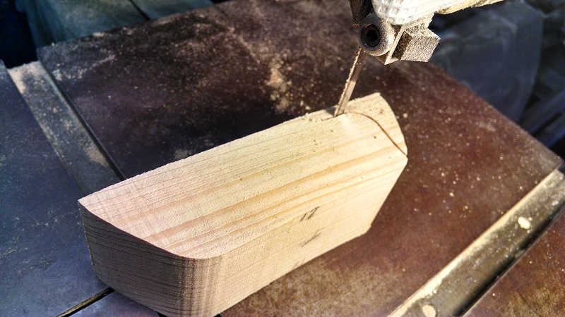

Cutting out Drawers

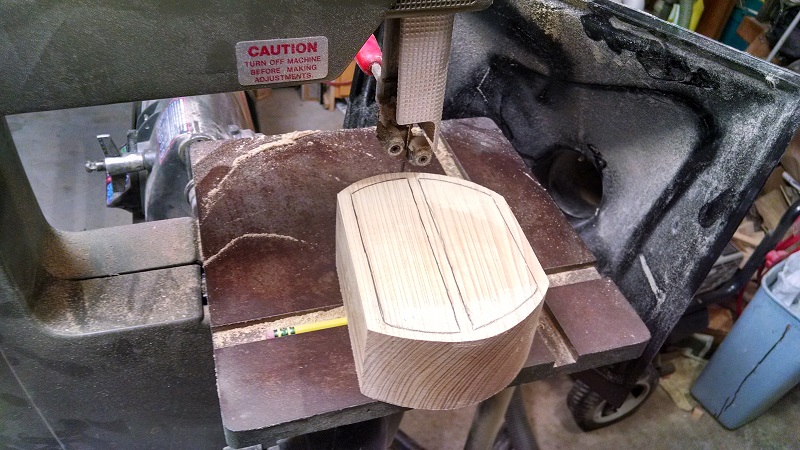

[attach]24984[/attach]
Draw out drawer shapes. Using my 3/16" saw blade.
[attach]24985[/attach]
Drawers all cut out.
[attach]24986[/attach]
Glue up entry points on block. Next I will work on the drawers. I'm getting the hang of these boxes, I will have 9 completed from this batch in a few days.

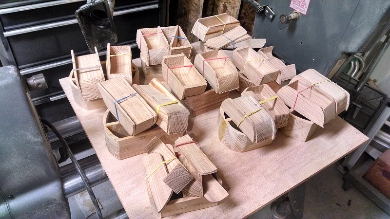

Cutting end plates off drawer blanks

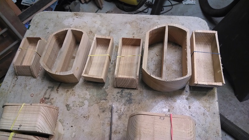

[attach]25011[/attach]

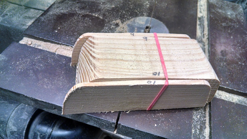

Using 3/16" blade to cut ends off drawers

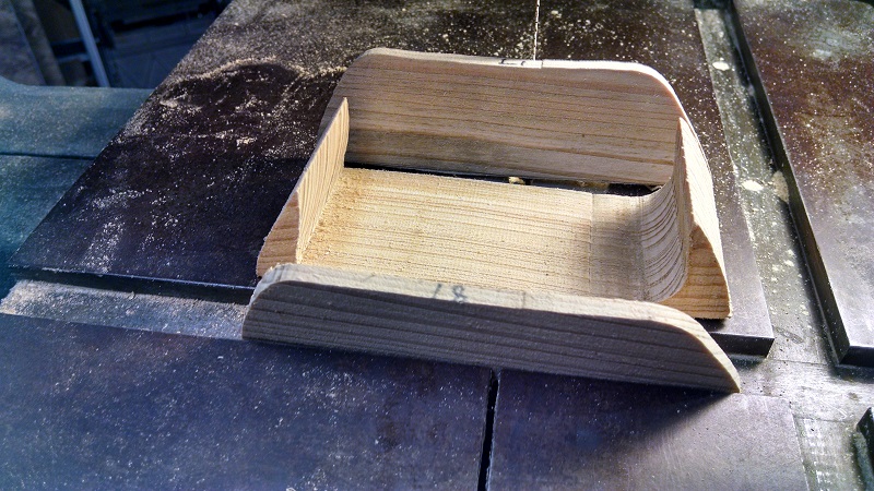

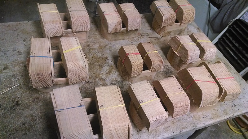

[attach]25012[/attach]
Numbering end plates and using rubber bands to keep everything together.
[attach]25013[/attach]
Now I will cut out the insides of the drawers next.

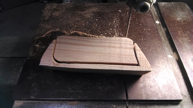

[attach]25022[/attach]
Cutting out center plug
[attach]25023[/attach]
Finished

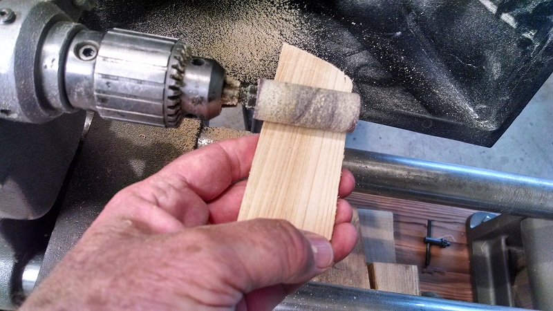

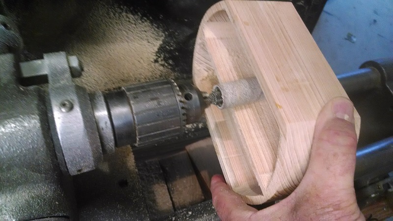

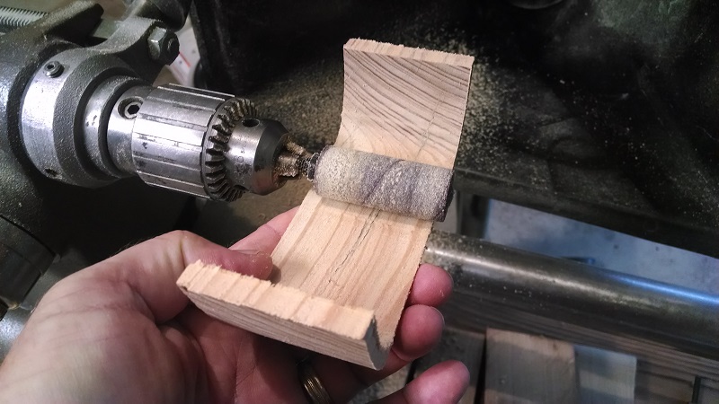

[attach]25027[/attach]
sanding inside of drawer using small drum sander before attaching front and back panels
[attach]25028[/attach]
sanding interior of box before attaching rear panel.

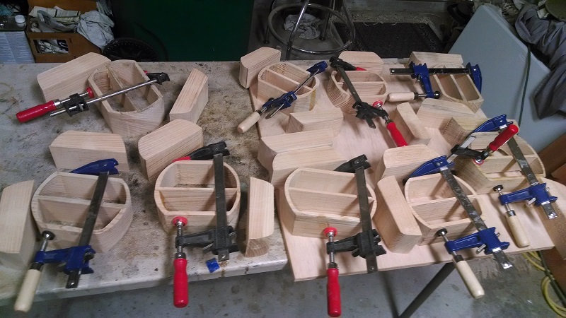

[attach]25029[/attach]
Waste plugs for some future projects. Now that I think of it, these would be perfect as 1 drawer boxes.
[attach]25030[/attach]
Ready to glue front and back panels to drawer base.

I have finally finished with my first batch of boxes. I have enough to give all families on both sides a box for Christmas this year. Now I'm going to experiment on some different designs and won't feel rushed to get them done.
[ATTACH]25443[/ATTACH]
Doing these 19 took almost as long as turning 60 bowls. If I was doing this for a living I would turn bowls and not make band saw boxes.
