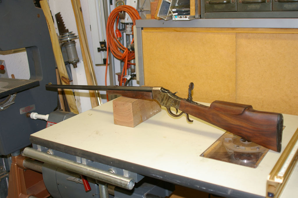

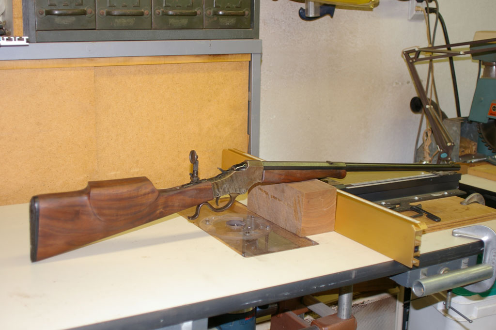

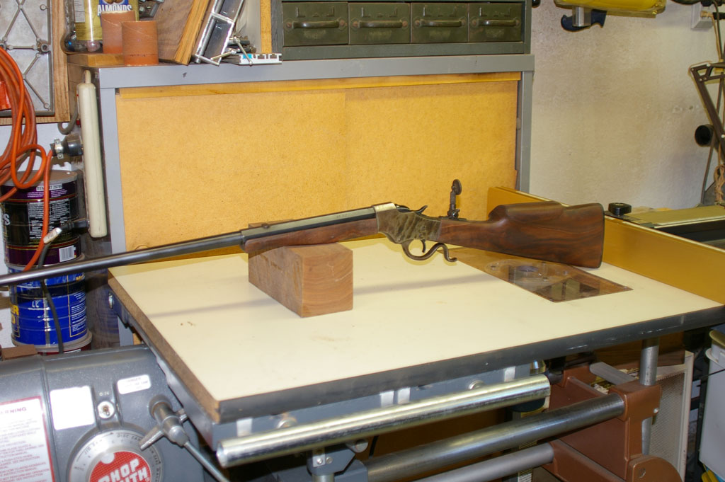

[ATTACH]24343[/ATTACH]For those that may be pursuing this idea, I am attaching a couple of photos of this concept with the router mounted in a work station panel laying on top of the 510 main table and extension. I have not cut any miter slots and probably won't since I use the table for other things.
