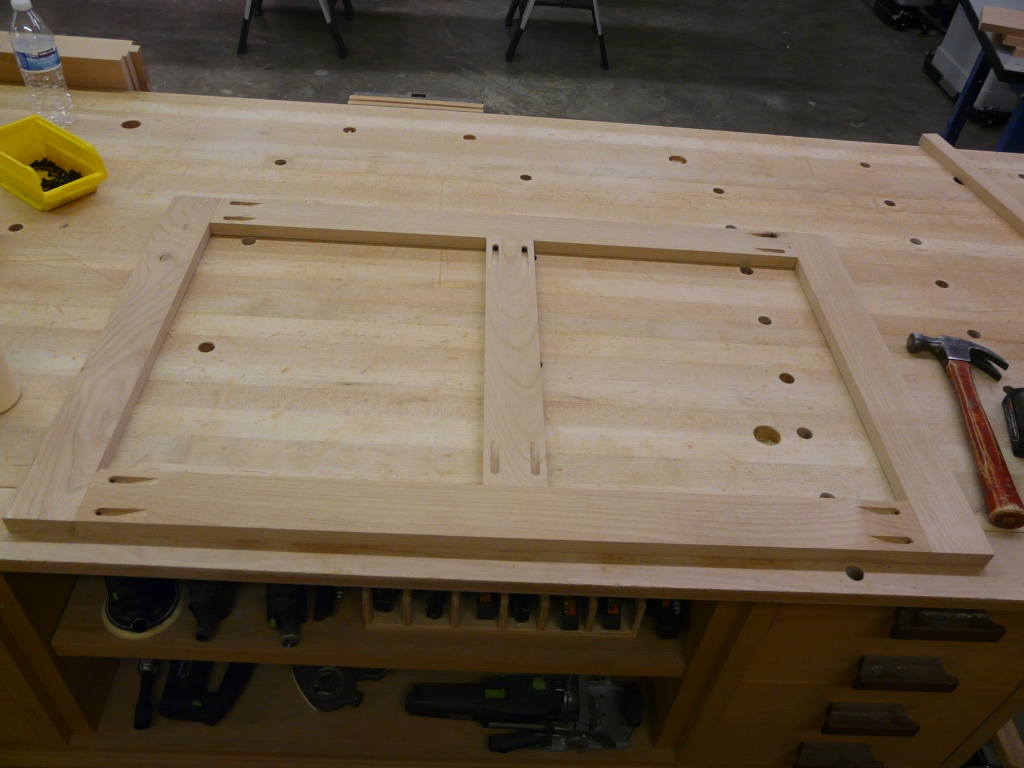

Here's a hint. The glue ups go with 16 of these. :D

I am guessing and I said this in the missing post that this is one of 16 "face frames".

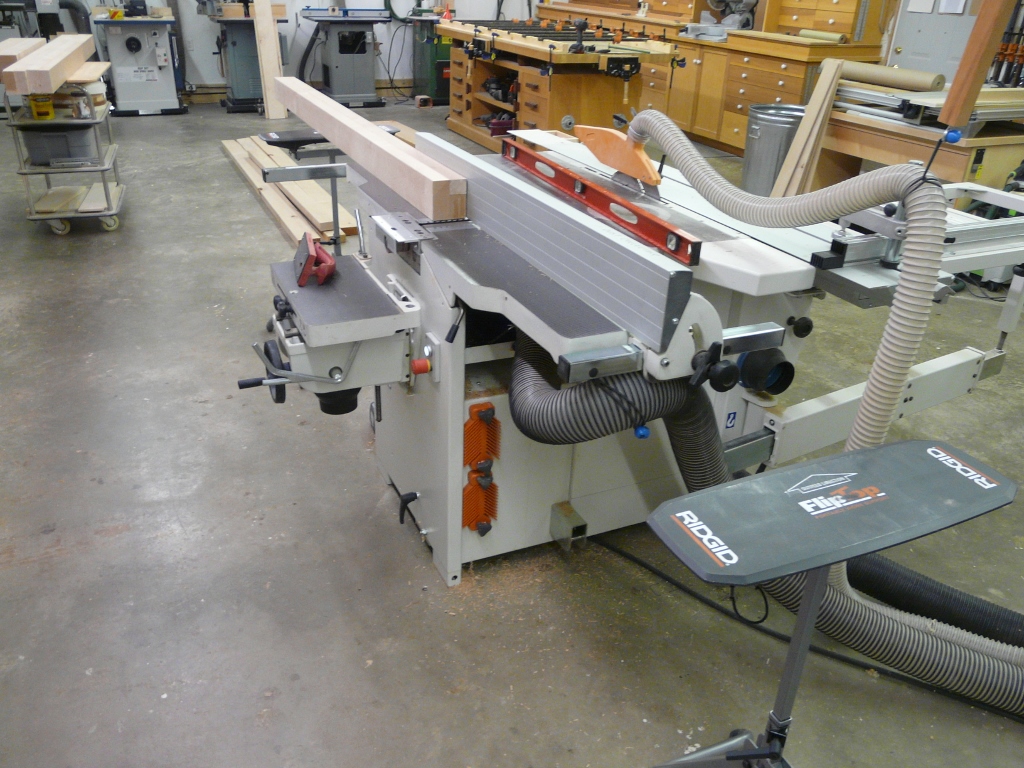

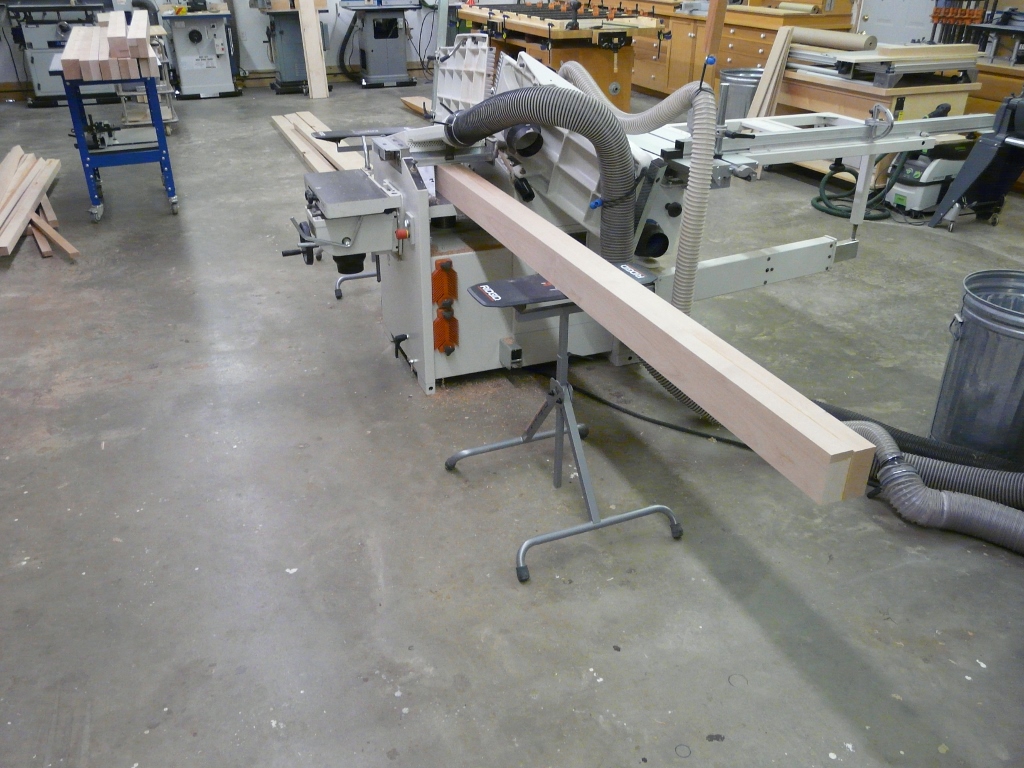

Need a longer jointer?  The HD flip stops work very well.
2 (2).jpg (469.15 KiB) Viewed 13325 times

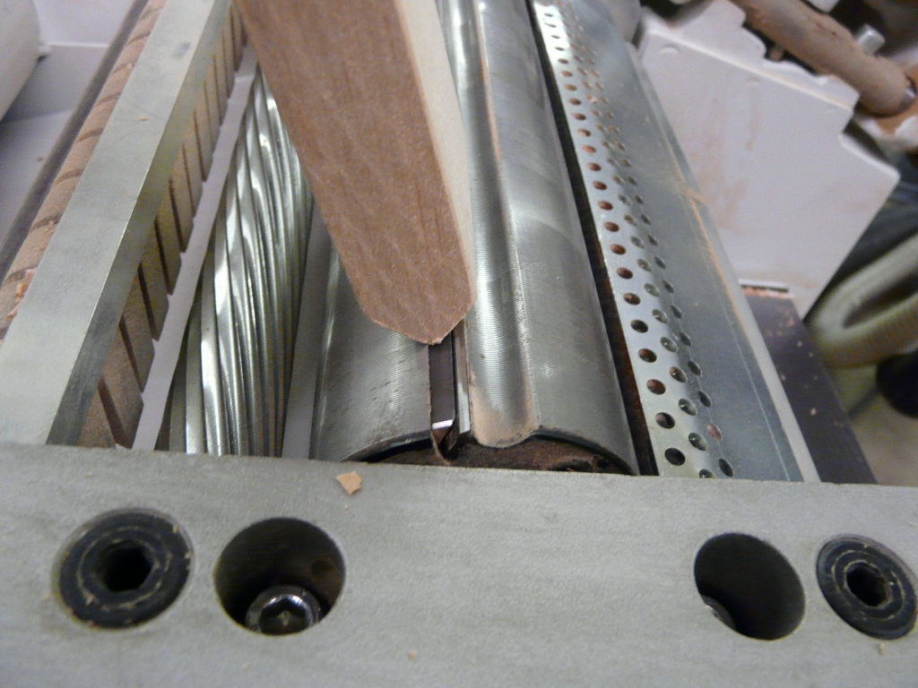

They also work for the planer.
2 (1).jpg (437.7 KiB) Viewed 13325 times

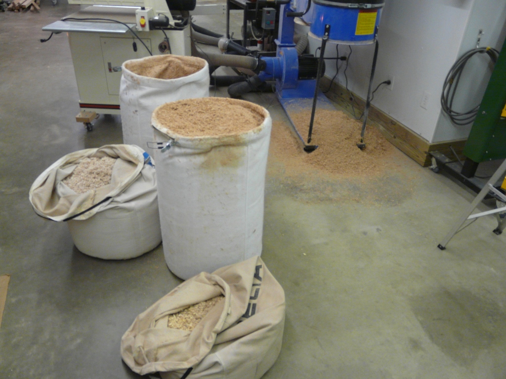

I hate when this happens. Funny thing is the front bags has always fill up first so that is the one I keep a check on. Recently I added a port and blast gate to this collector so I must have changed the dynamics. :eek: :eek:

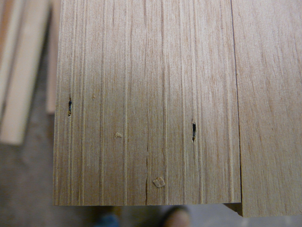

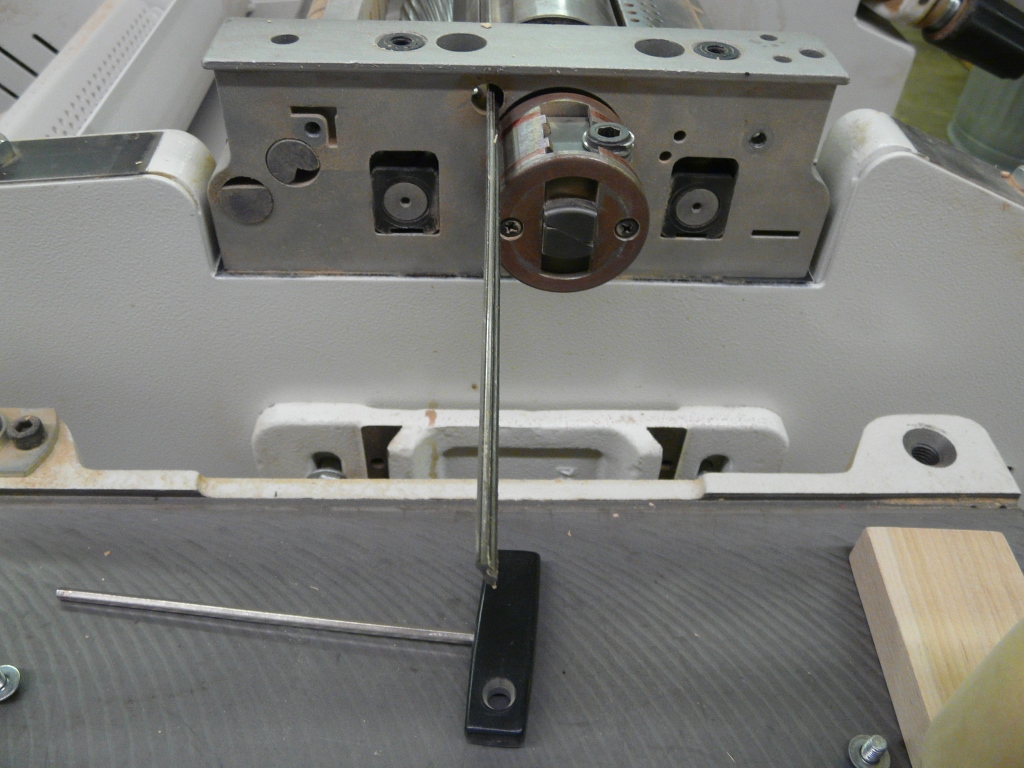

I hated even more when I discovered these nails (16 total) in the glue ups I was planing. See all the grooves. The knives are shot. :mad:

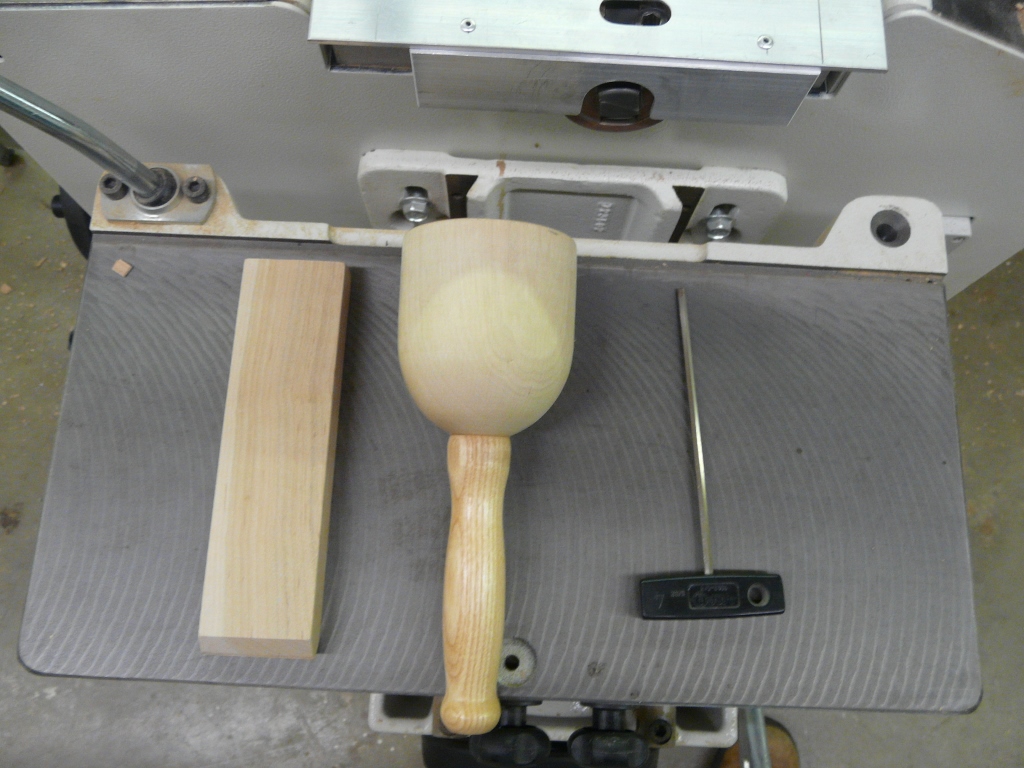

These are the tools I need to change the knives on my Tersa cutterhead. The allen wrench is to remove the homemade guard over the mortise head made by my alter ego mbmetalworker. ;)
You just tap the jibs down with the block and mallet.

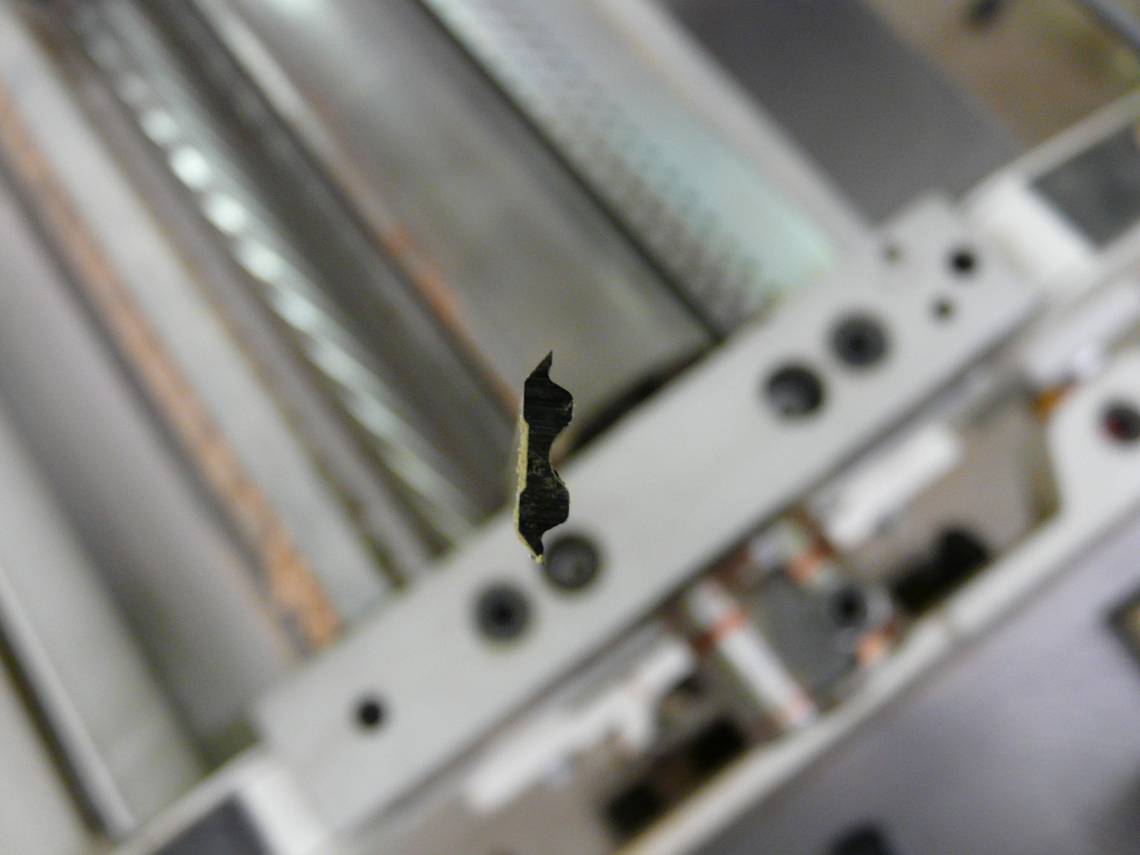

The knives slide right out.  They are double sided so they can be flipped over.  Unfortunately these have already been flipped.
This is a close up of the profile. It takes less than 2 minuets to change these out. Centrifugal force resets the jibs when the unit is power back on.
