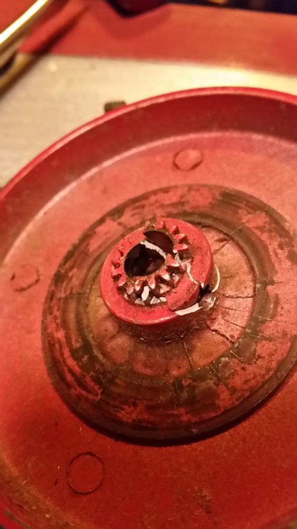

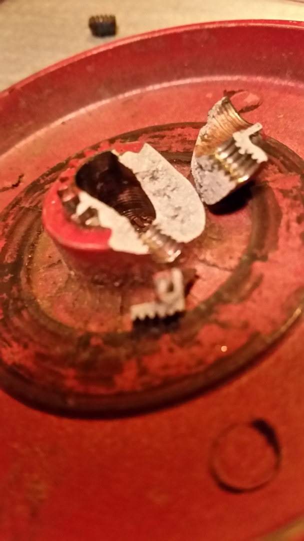

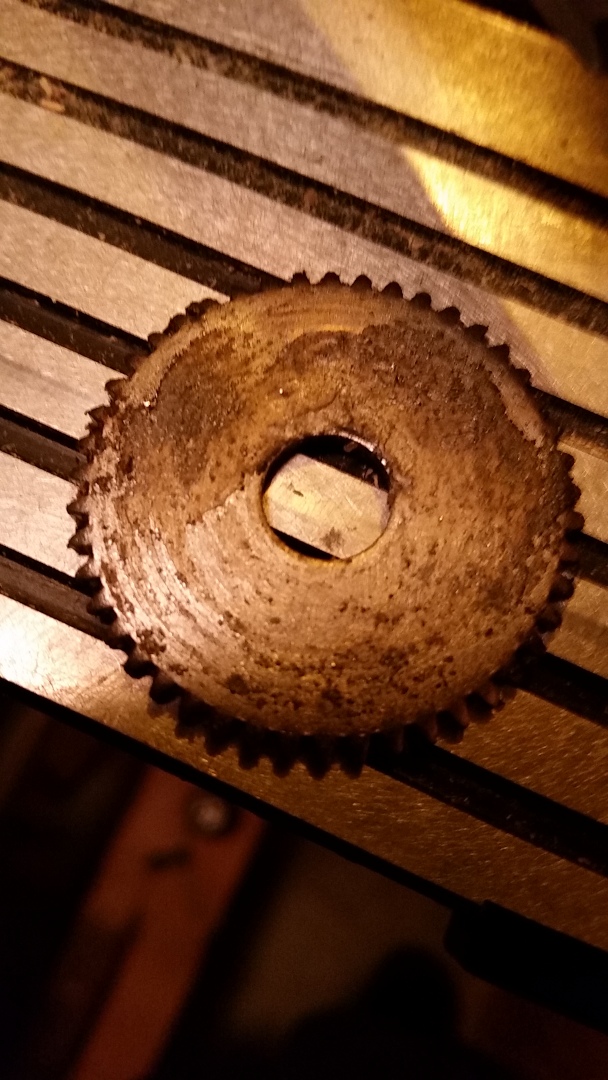

Re: What did I buy, 500 or 510?
Ok, I figured I was pretty much screwed.
The knob wouldn't move.
The dial wouldn't move. Finger pressure wouldn't move it.
Thinking maybe the set screw was loose enough, I pried at the knob... It came off. Not intact :-(
And I think I found the problem... the gear (under the knob, meshes with knob and ring) had "goop" on the back of it.
One thing I noticed, the gear is not... symmetric. The teeth seem to be toward one side. That is, placed one way, the gear will be touching, resting on the back and teeth sticking out. Placed another way, the teeth only would ride on the base.
Anyway, I had it so the teeth stuck out and the "back" (the up side in the photo) against the base, and there was goop on it. I'm guessing that bound it up.
I'm guessing that what I lubed it with was not a good choice. I wish I could remember what it was.
So I'll get the knob from the other headstock (which has a broken tooth, as I remember) and see if that works.
What's a good lube for inside the speed dial?
And, I've got the speed dial and pork chop out, and it had been on "Q". I'd like to move the spindles, sheaves, belts to fully fast before I put the speed dial back in. I think that would make it easier to get the pork chop clip on. How can I move that without the speed dial/pork chop in place?
(and I had some trouble with the attachments ;-) If you see "The attachment brokenKnobSetTogether_scaled.jpg is no longer available" please ignore)

- Goop on the back of the gear
- goopOnGear_scaled.jpg (260.03 KiB) Viewed 2249 times
