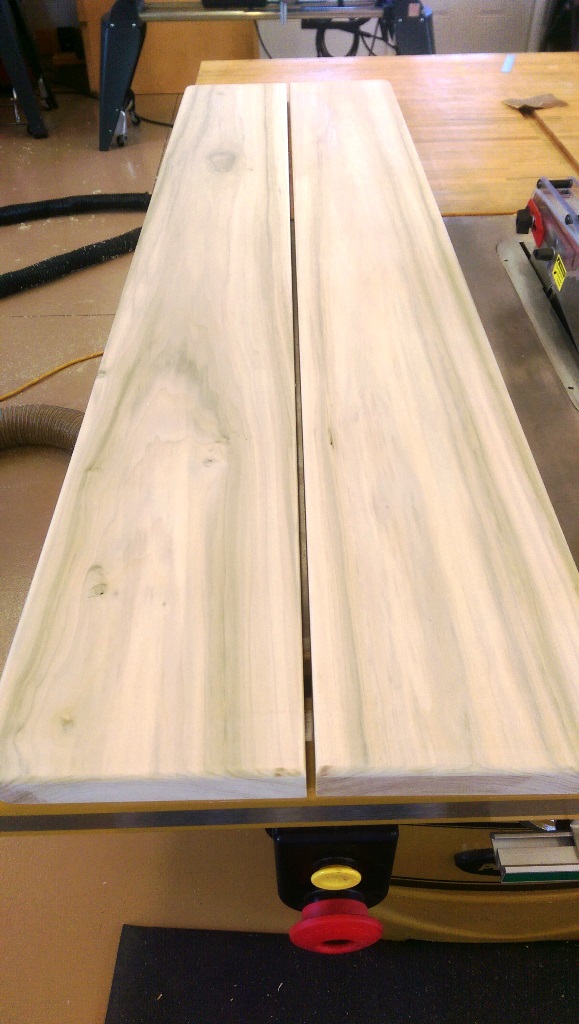

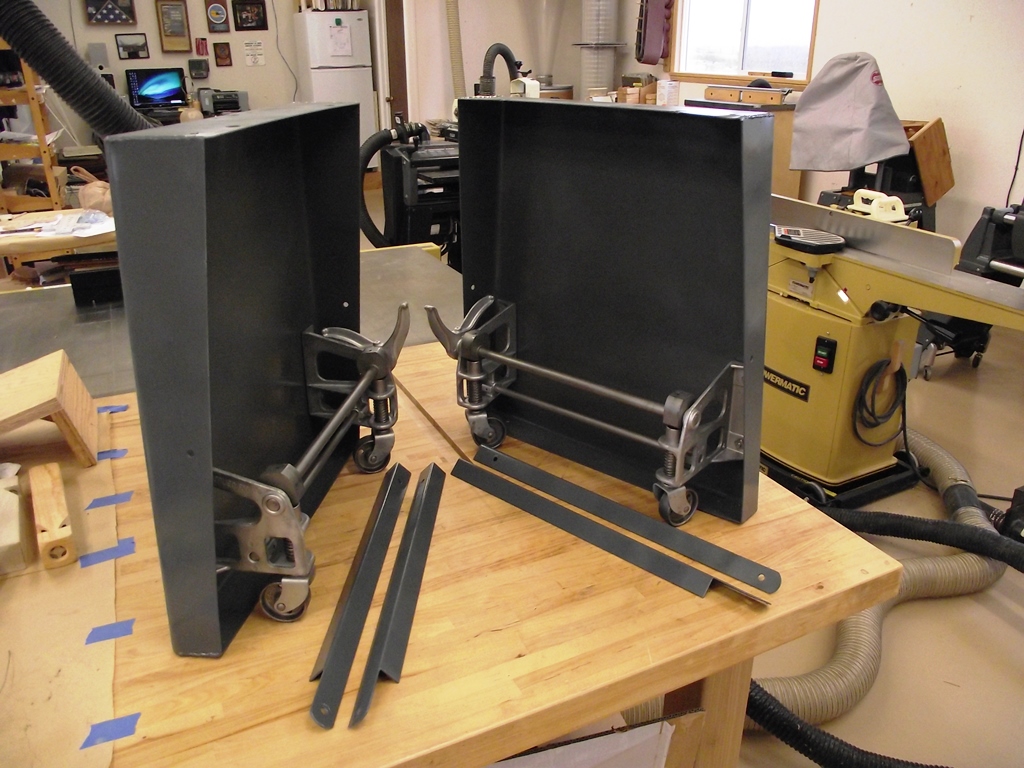

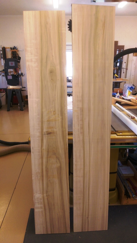

The bench legs are all done and the castors are attached. Next I need to get the material for the bench top. I think it will be 6/4 popular.
- DSCF1645.jpg (406.8 KiB) Viewed 8117 times
Re: Restoring 10ER S/N 83974

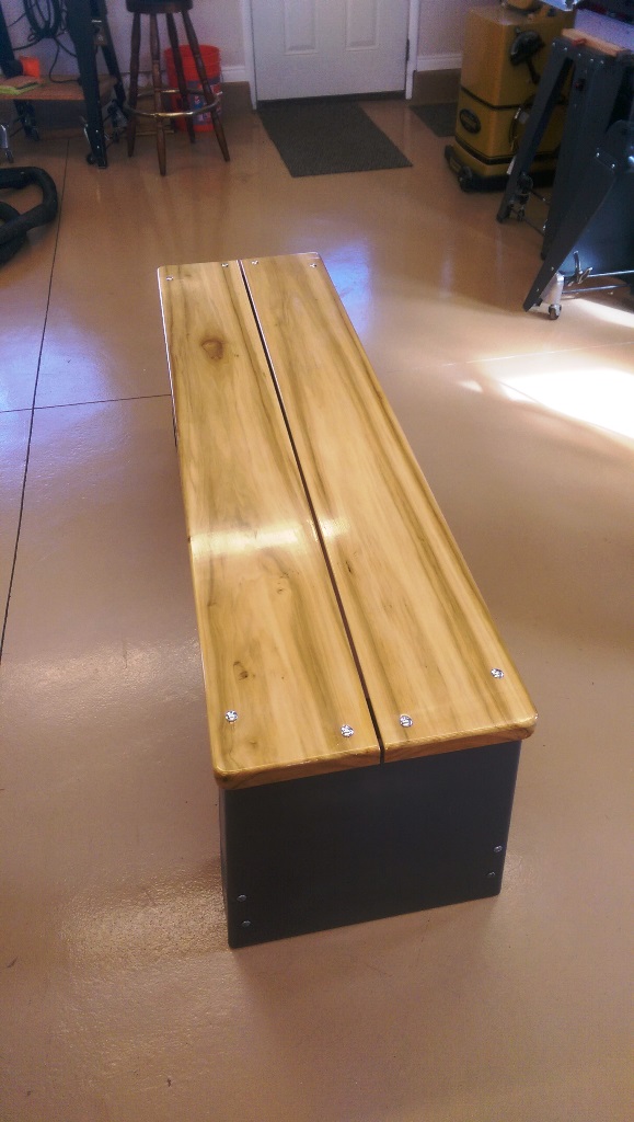

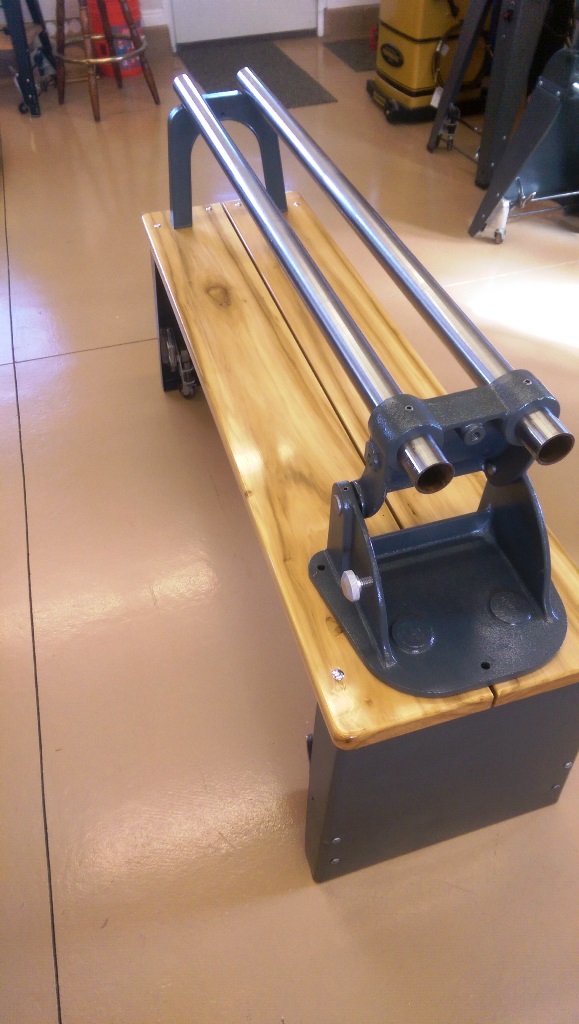

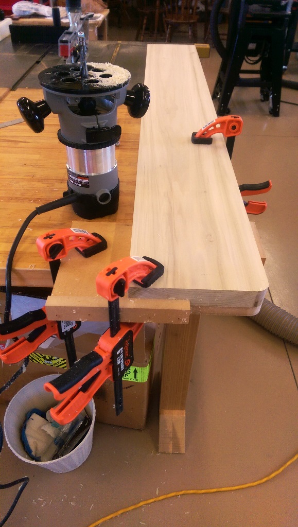

The bench is put together. It is 6/4 Popular. The finish is one coat of Shellac then 3 coats of exterior oil base Polyurethane. Now it is time to assemble the machine. However, I still need to clean and polish the aluminum table tops. As you can see the bench over hangs the legs by 1/2" all around. Skip did that on his pristine '53 restoration and I like the looks. There are round overs all around on the top side. 1/8" between the planks and 1/4" on the outside edges.
I brushed it and it is not as good as it looks in the pictures. A few runs and dull spots from sanding the previous coat. I am going to touch it up as it stands before I assemble the machine. Finishing is not my forte, but I try. It is really not too bad, just not up to my standards.rjent wrote:Looking great! Makes me want to go clean mine off again LOL
