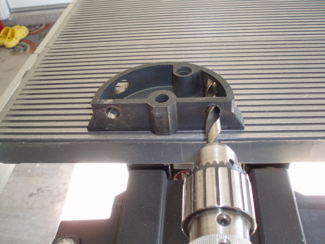

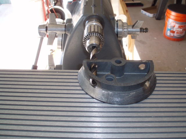

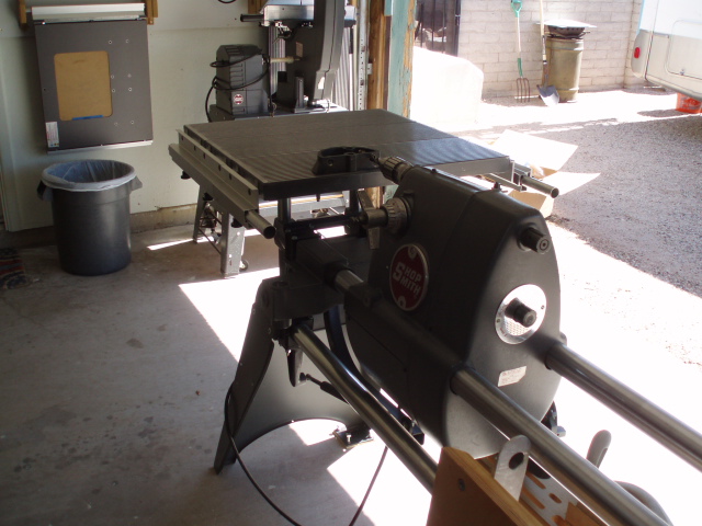

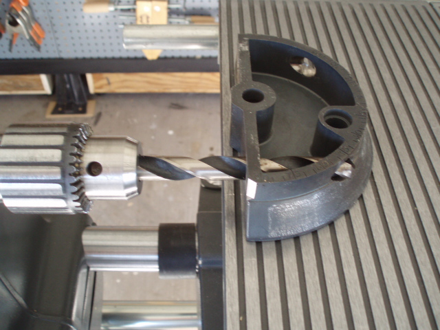

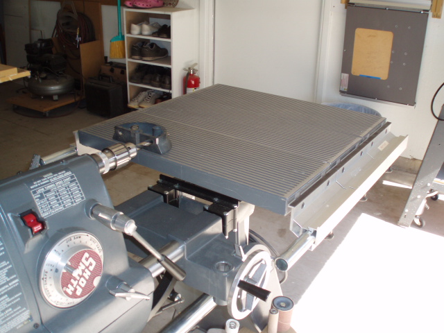

I have taken a couple pictures but I DID NOT do the necessary clamping to make this a safe task. I really don't have the right clamps for a task like this but if I needed to do this job I'd get the clamps. Just might do that anyway; I hate to know that there is a common job I can't do for want of a simple clamp.
I have two floating tables mounted but only one is necessary. In fact, if I didn't have the lift assist, I believe this could be done on just an extension table.
If I elevated the trunnion, I would be able to move the carriage closer to the table. As it is, if I get the carriage closer to the right end of the Shopsmith, the arbor touches the table top. Since this is just a trial effort to prove concept, I didn't do all of that. However, don't take shortcuts. After all, that is sorta why we are having this discussion.
- P6190002.JPG (136.9 KiB) Viewed 2535 times
- P6190004.JPG (154.93 KiB) Viewed 2526 times
- P6190005.JPG (140.53 KiB) Viewed 2517 times
- P6190006.JPG (139.44 KiB) Viewed 2515 times
- P6190007.JPG (136.23 KiB) Viewed 2515 times
[quote="dusty"]...I have taken a couple pictures but I DID NOT do the necessary clamping to make this a safe task. I really don't have the right clamps for a task like this but if I needed to do this job I'd get the clamps. Just might do that anyway]
Hi Dusty! It looks like you already have the clamp that would be my first choice. Try out that hand screw that I see hanging on the wall in photo P6190004.JPG. You might be able to put tow of those hand screws on to hold the trunnion. If you don't want to dent the handscrew, put a wood block above the trunnion and below the table.
I don't understand how moving the carriage to the right would cause the arbor to touch the table top.

charlese wrote:I don't understand how moving the carriage to the right would cause the arbor to touch the table top.
With the trunnion sitting flat on the table, to align the drill bit with the hole in the trunnion, the arbor touches the table. To see if this table arrangement was feasble, I just pulled the headstock away from the table (to the left).
I just went back and reread what I wrote. It's confusing; not well stated.
Actually, the carriage doesn't really impact anything except that it is there. The potential interference that I saw was between the arbor and the extension or floating table that the arbor is resting on.
If I was actually setting up to drill the trunnions, I would elevate the trunnion with something like a piece of 1/2" plywood.
Having done that, there would be clearance between the arbor and the table top.
