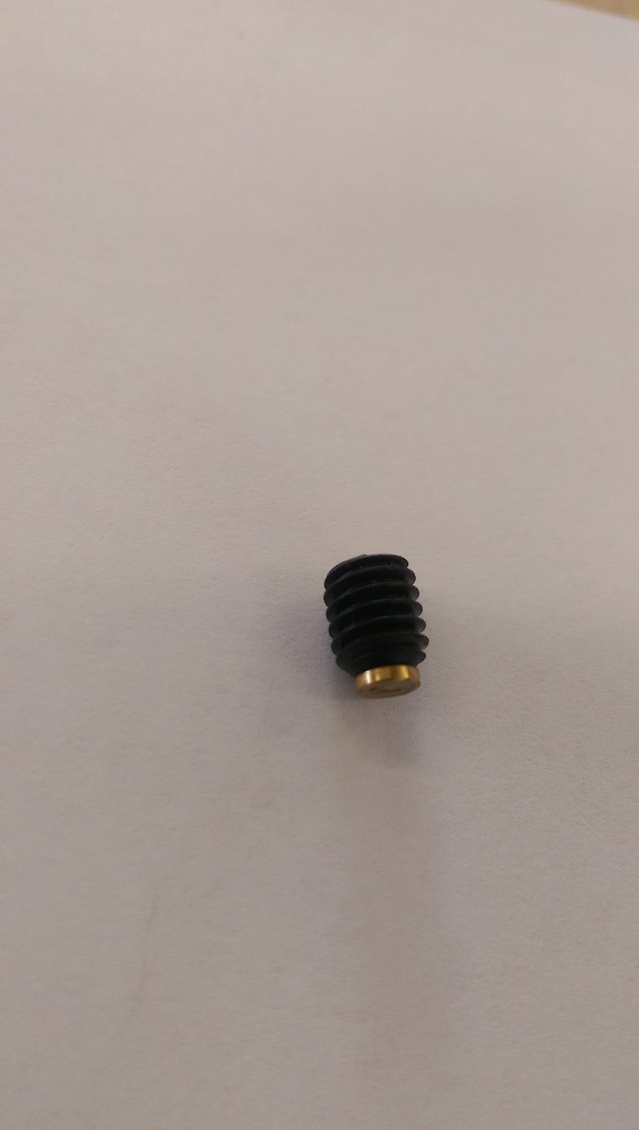

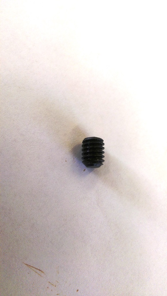

I said that all my arbor set screws (18 of them) were round end. So then I asked the question, why does a tilted set screw hole make a big difference. As it turns out upon further inspection they are not round. The actually have a flat spot on the end although depending how you view them they may appear round. OK, a senior moment. See the first picture.
As far as the dog nose screw that Ed posted, I agree with you JPG. How would you know from that picture that the end is brass. Well, I have 2 SS saw blade arbors for 5/8" blades. They both have brass tips in the dog nose style. See the second picture.

They are just like all the others as shown in the first picture above, no cup.
