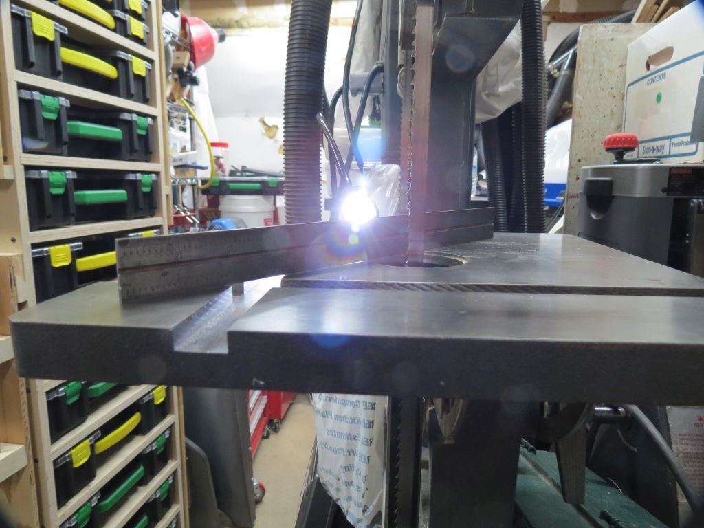

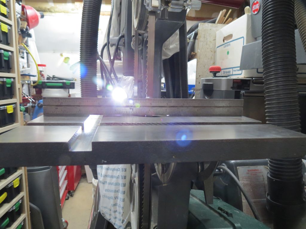

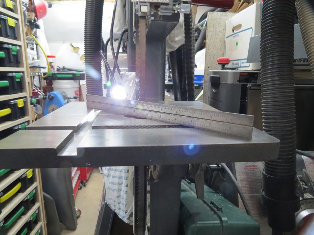

I went back out and looked again at my table and took a few more pictures. I have one area just ahead of the blade that I can see light at. That area is small and I tried to see if I could measure it. The finest feeler gauge I have is .0005" and it will not fit. So as a guess I would say maybe .0003", that is flat for a saw table.
Edit: [I miss read the feeler gauge, the thinnest one I have says .0015" not .0005. At any rate the feeler gauge of .0015" will not fit under the rule so it is something less then that number. I don't have a finer one to try. Keep in mind a piece of note book paper is on the order of .003" so this is clearly a very small deviance from flat.]
Any derivation in that direction isn't an issue in resawing, especially when it is as small as I'm seeing. The thing with resawing is the fence being perpendicular to the table and parallel to the blade. The control surface is the fence not the table for this operation. If you don't keep the wood against the fence it will not work well.
Anyway the question was ask if anyone had a flat bandsaw table and I will answer the yes I do. Is it perfect? No but plenty close enough.
