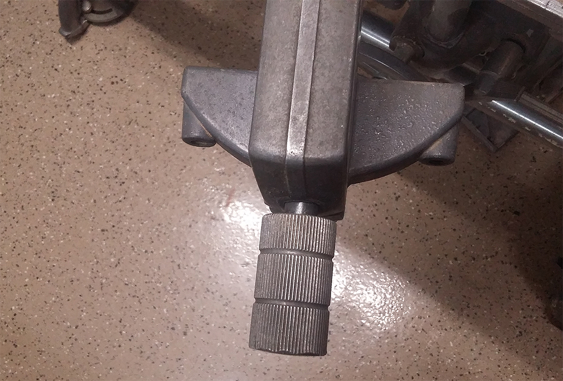

#207015 by reible » Tue Mar 08, 2016 8:57 pm
Don't know how you got the wrong screws but you did. I checked the three rip fences I have and they all have the oval points. The one is from the 1976 new from the factory one and another is from the updated fence that I got just after they came out and the third is from if I remember right a 79 or 80 that I got used.
I checked, everything on my Mark 5 has Cup Point Set Screws, except my 2 -12" sanding discs, those have Flat, not round set screws, I have 3 power coupler sets, all Cup Point, Molder / Dado Arbor, Saw Blade arbors, 4 - 5/8" and 3 - 1 1/4" all are cup point, is this correct? My Mark 5 is 1981 vintage.

Re: Original rip fence update my design.
[quote="JPG"]The Mark 5 fence only had the one screw since that side is the one to use the screw to offset the fence.
IIUC the second one was added when the bandsaw fence was introduced for the alumuinum table(blade drift...). Since the same base casting was used for the '500' it also has two screws.
Here is a picture of my 1981 Mark 5 fence, 2 set screw locations, from the factory.
- Set screws 2.jpg (679.32 KiB) Viewed 1562 times

Ouch someone did a job on the setscrews on your machine.
There are very few places that have cup setscrews on a shopsmith. There is a list here of the set screws that things use. I don't have the time right now to look it up but someone can find it and post here that would be great.
I'm going to have to assume that a previous owner did this and perhaps as an improvement. It is unlike to have been an improvement, who knows what damage these set screws have done to different shafts and the like.
I think what we are saying is that it is fine to make improvements but they should start with factory parts and then go from there. A used shopsmith who knows what others have done to it. I got a few that had some real hum digger of repairs. One was missing the spherical washer, it had fallen in the motor pan and the repair was several sets of washers on the shafts lock but of course that didn't work well and the owner admitted that it had a problem. The solution was not for me to redesign the lock it was to return it to factory condition.
In your case the fence has a problem and one that is not common, there are who knows how many shopsmiths that are working fine so in an effort to help you we have suggested that your situation is not normal and as such any repair and or improvement is specific to your problem. If you were to replace this fence you might not need or want the repair or improvement but since I don't think you're interested in doing that then you have your solution. It is also possible that this part came from the factory defective, pretty hard to tell at this point.
I personally want to try this with some uhmw strip material I have to see if I like it.
The problem come in where someone will read this and say OH I have to do that to get my fence to work right and they may not need to do anything other then retract the set screws..... again if you start with the factory stuff being right you can go where you need to go. If this is a solution to another user fine.
Also keep in mind this fence design is over 60 years old so while it has evolved there is also a long history of them working right. I think I once saw there are over 550,000 shopsmith so that is a lot of parts and other fence makers wish they could sell that many.
We do encourage people to post their ideas, we do like to see what others have done and to share. Perhaps it may not seem that way but we are trying to help you and others and that is because we love our machines and want people to be happy with them. We don't work for shopsmith we are just owners and represent a lot of years of owner ship. I personally own 5 machines and that is not uncommon. Perhaps our passion is a bit much but our hearts are in the right place.

I am the original owner of this machine, and I certainly haven't changed out these screws, must have been a rush time at the factory and were short on inventory, I know for a fact the one coupler set was purchased in the late 80's early 909's and it has cup point set screws, still in the package.reible wrote:Ouch someone did a job on the setscrews on your machine.

There is a thread here on the forum that details the set screws used in the Shopsmith equipment that is more detailed than this but this one icontains the same data.
Shopsmith Setscrews Version 9.doc- (117.5 KiB) Downloaded 431 times
