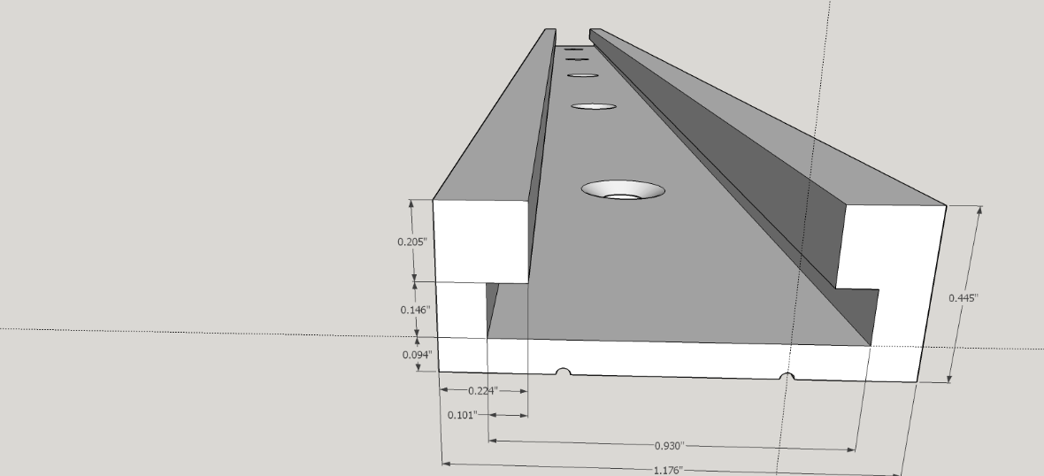

Does this resemble the aluminum extrusion that you have?
