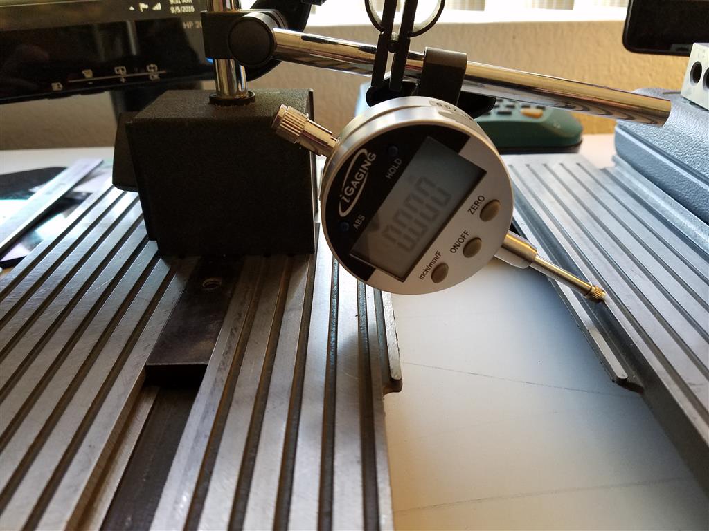

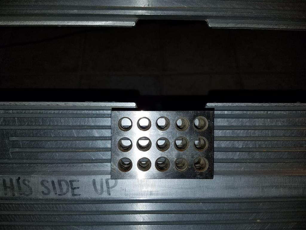

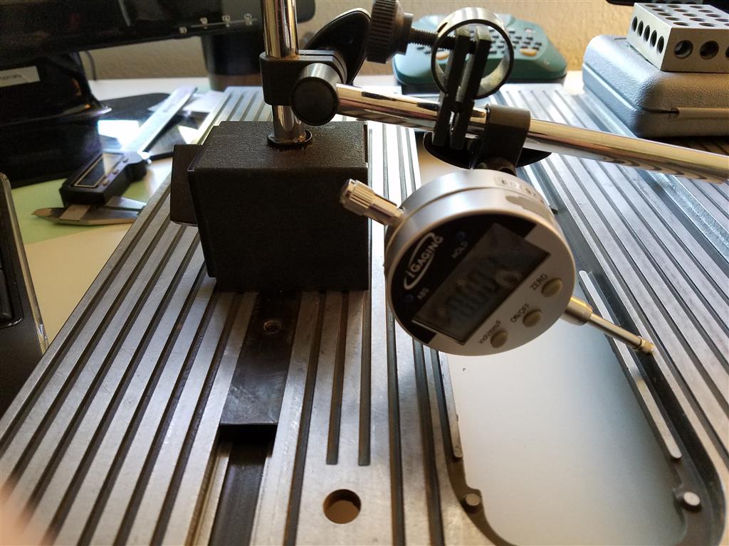

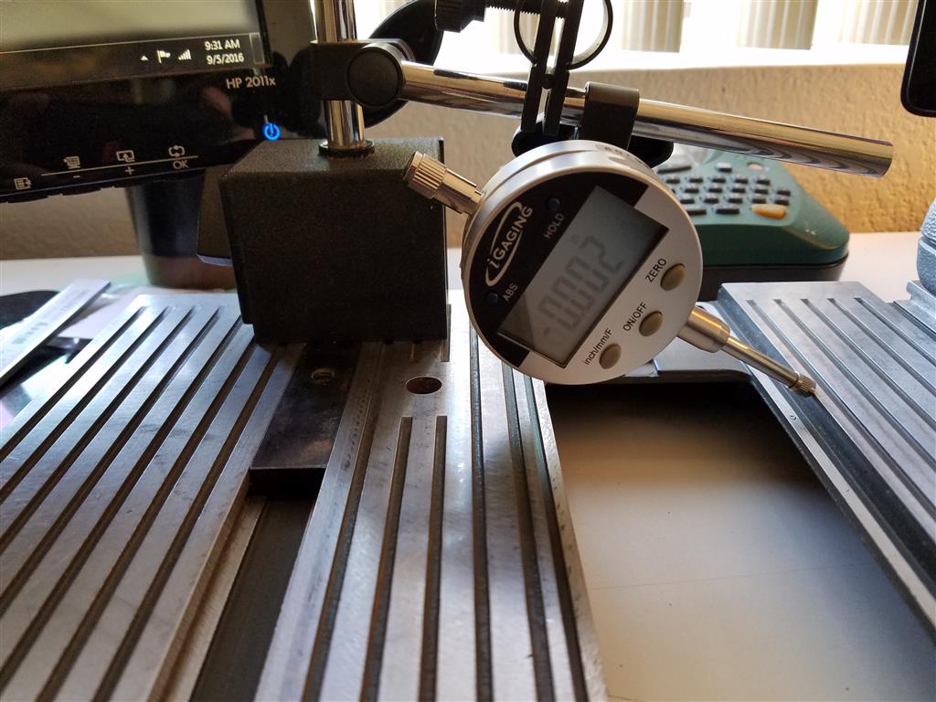

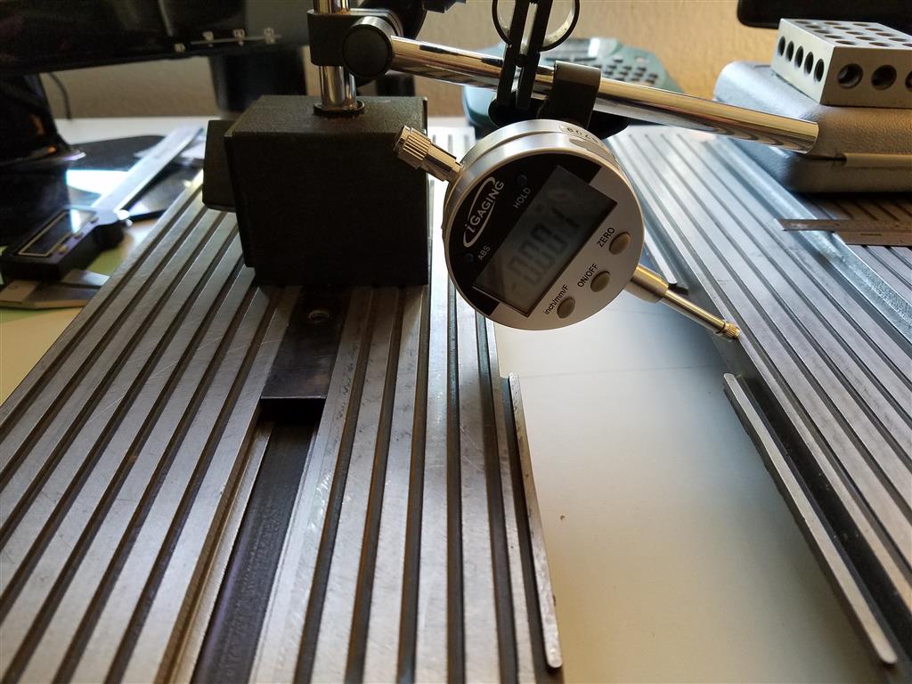

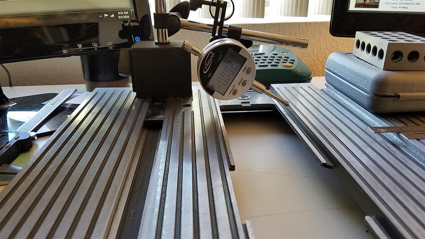

This photo proves nothing because you are not here to see and feel but this is how I have concluded that the Mark V miter slots are parallel to the cast (not milled) edges of the table insert cut out in a Mark V Main Table.
The setup block measures 2" by 3" +-.001.
Photo angle could be better but this is what I have. You just have to trust!
FWIW I have used crocus cloth to smooth the edges of the slots and inserts on all of my tables. Even those that were milled were not without imperfections. I have done the same with the left and right edges on two of my Main Tables and the one extension table to which I occasionally attache a miter track.
That aluminum bar in the miter track was "milled" (using the conical disk sander) to fit snugly in the miter track. I use this a lot to establish a reference edge. It is marked "This Side Up" for good reason. The other edges (top and bottom) are the sorry result of "poor technique".

Yup. I've checked them against a precision 1-2-3 block, and they are dead-nuts (i.e. better than 0.0005") on all three dimensions. They are Mitutoyo calipers from eBay, and I was very pleasantly surprised at that result. I always qualify my instruments, even if brand new.dusty wrote:Use your calipers and measure a precision setup block ten times. Did you consistently get the same numbers (+-.000)? I doubt it.
You actually just seconded the point I was trying to make. Table-insert pocket parallelness to the miter slots should not be assumed -- it should be checked. But it's up to you to decide what tolerance is "good enough".

And so I did just that. This is a tool that for some reason I hardly ever use but no more. I really like this.BuckeyeDennis wrote:Yup. I've checked them against a precision 1-2-3 block, and they are dead-nuts (i.e. better than 0.0005") on all three dimensions. They are Mitutoyo calipers from eBay, and I was very pleasantly surprised at that result. I always qualify my instruments, even if brand new.dusty wrote:Use your calipers and measure a precision setup block ten times. Did you consistently get the same numbers (+-.000)? I doubt it.
As for the Table-Insert pocket being parallel to the miter track - well, this is a sample of one and a small sample at that but it was enough to reassure me.
Tolerance level, there is none. Do whatever feels good. For me that will continue to be .005" when working with the Shopsmith.
