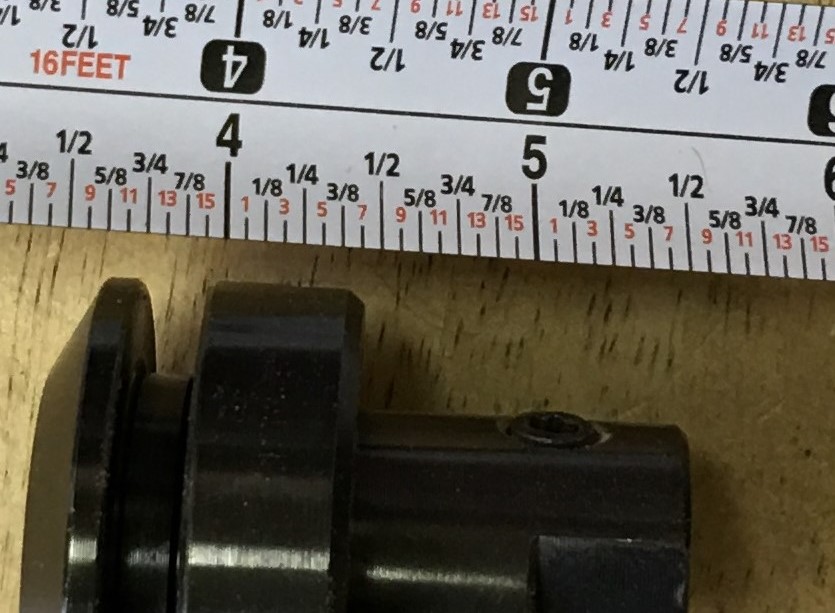

I looked at the picture I posted on page 4 (#320) and it looks like it's 1 3/4 but I will confirm it again on Sunday.

It should be 1 3/4". I checked all of my arbors this morning. I posted this earlier but without dimensions.dynabase wrote:I looked at the picture I posted on page 4 (#320) and it looks like it's 1 3/4 but I will confirm it again on Sunday.
Michael
- Saw Blade and Arbor.png (41.71 KiB) Viewed 5220 times

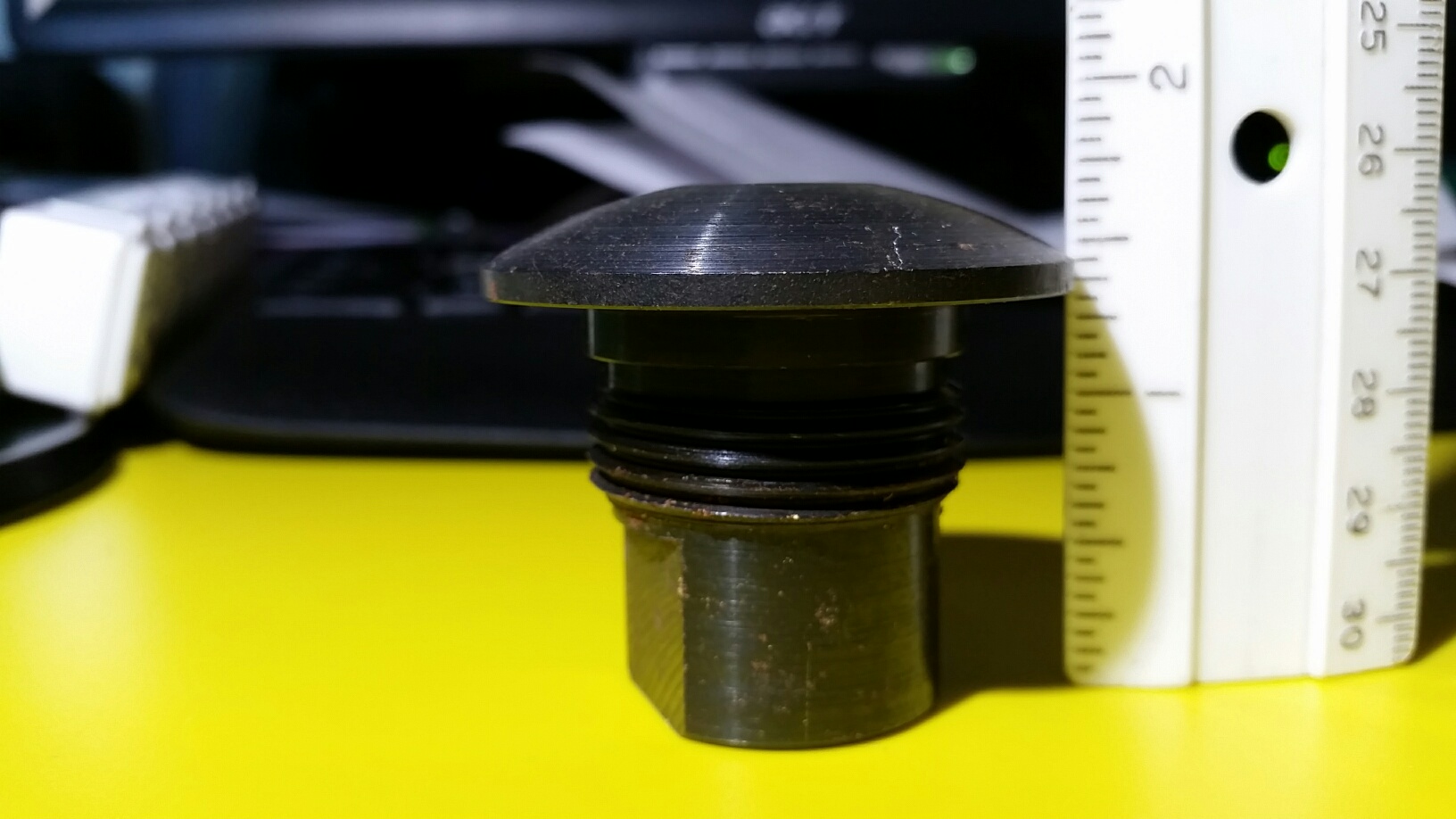

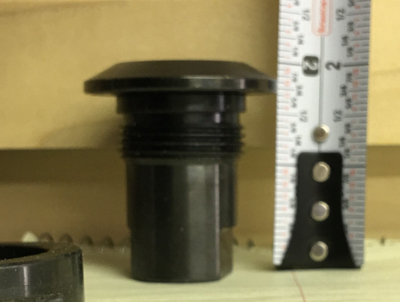

Maybe a closer look and these two images will tell us something. I know I read the measurements incorrectly.
Re: My 520 started singing today.

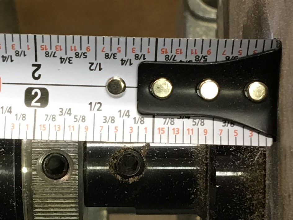

I'm sure they are telling us something but I'm not sure what. If you go back and look at my images you can see the blade to the center of the allen screw on the silver collar is 2" while in his shot it looks to be 1-13/16".dusty wrote:Arbor to Blade #1.jpg
I may have to go out and dig up one of my old 500 arbors to look at. From memory I think they are a lot shorter...... so are there other arbors from shopsmith that are only slightly shorter?

As I remembered the 500 arbor is a lot shorter. Here is a picture, looks like about 1-5/16" (sorry, I for got to actually measure so I'm using the picture to get that dimension) to the same place the other arbor measures 1-3/4". That would be 7/16" shorter.

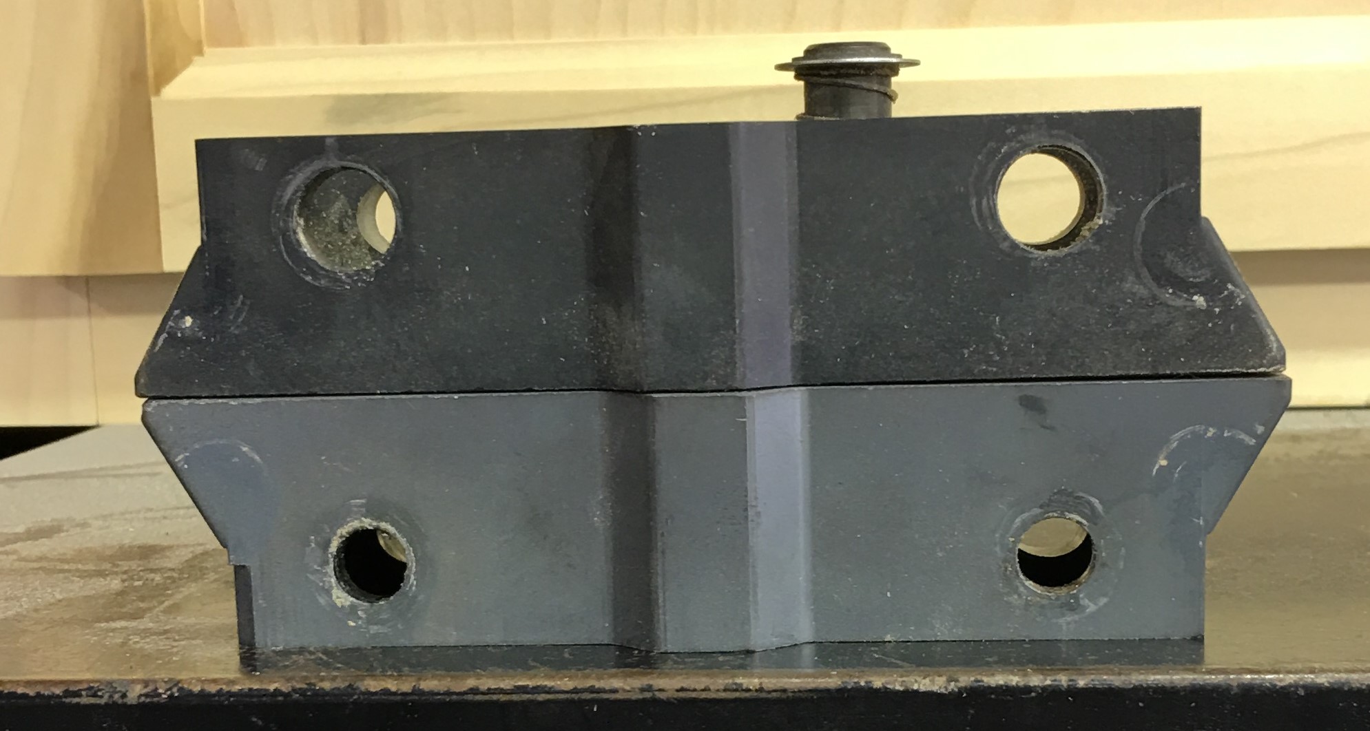

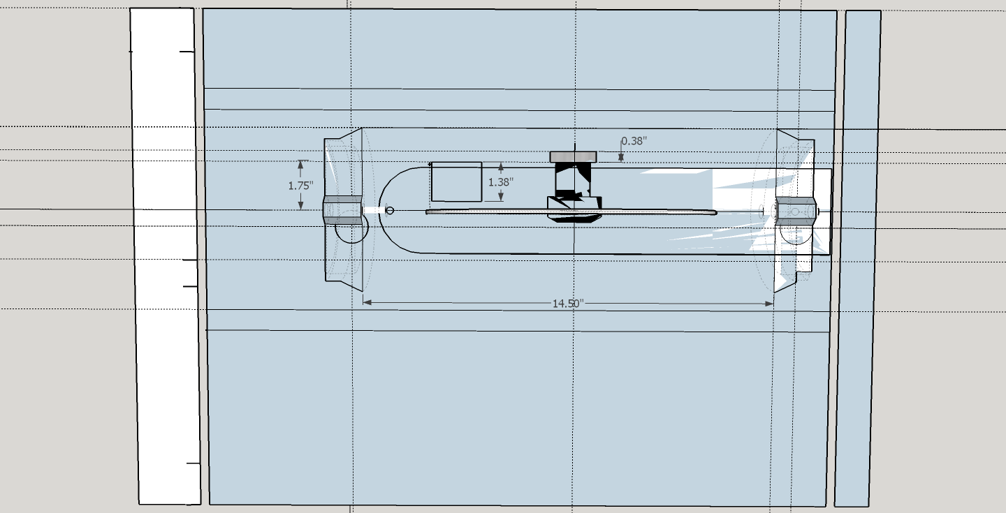

The main problem is with the trunnions. I cannot move my table at all because of the rear trunnion. I am waiting on a reply from Shopsmith support and will either get a new trunnion from them or drill this one out. Until then I don't know what else we can do. If you want me to reassemble the maintable with the old trunnions and take a picture I will be happy to do so. I think it would be better to see what we have after I get the trunnion thing resolved.
With the new trunnion I will be able to adjust the table some. The 1/4 inch difference between the two sides of the blade when measured using the miter slots should be different. If I could move the table 1/8 of an inch that might balance things out some.

- IMG_0350 (2).JPG (306.55 KiB) Viewed 5169 times
- IMG_0339 (2).JPG (180.47 KiB) Viewed 5169 times
Am I correct? The one trunion has 1/2" holes and the other has 3/8" holes (1/8" smaller). If I am correct, the larger holes will give you 1/16" more movement in any direction than you have now.
Will that extra movement alleviate your existing 1/4" error?
