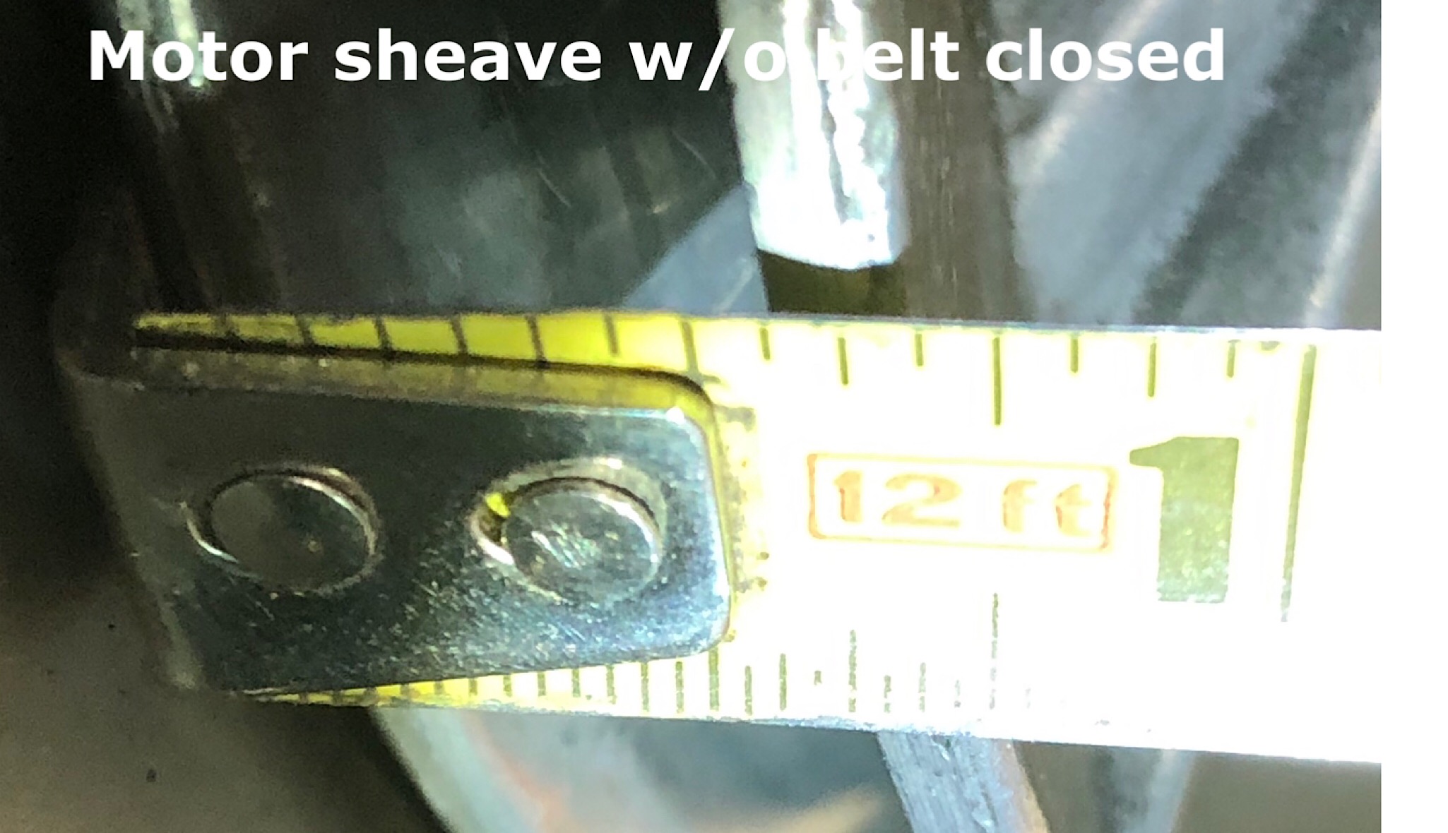

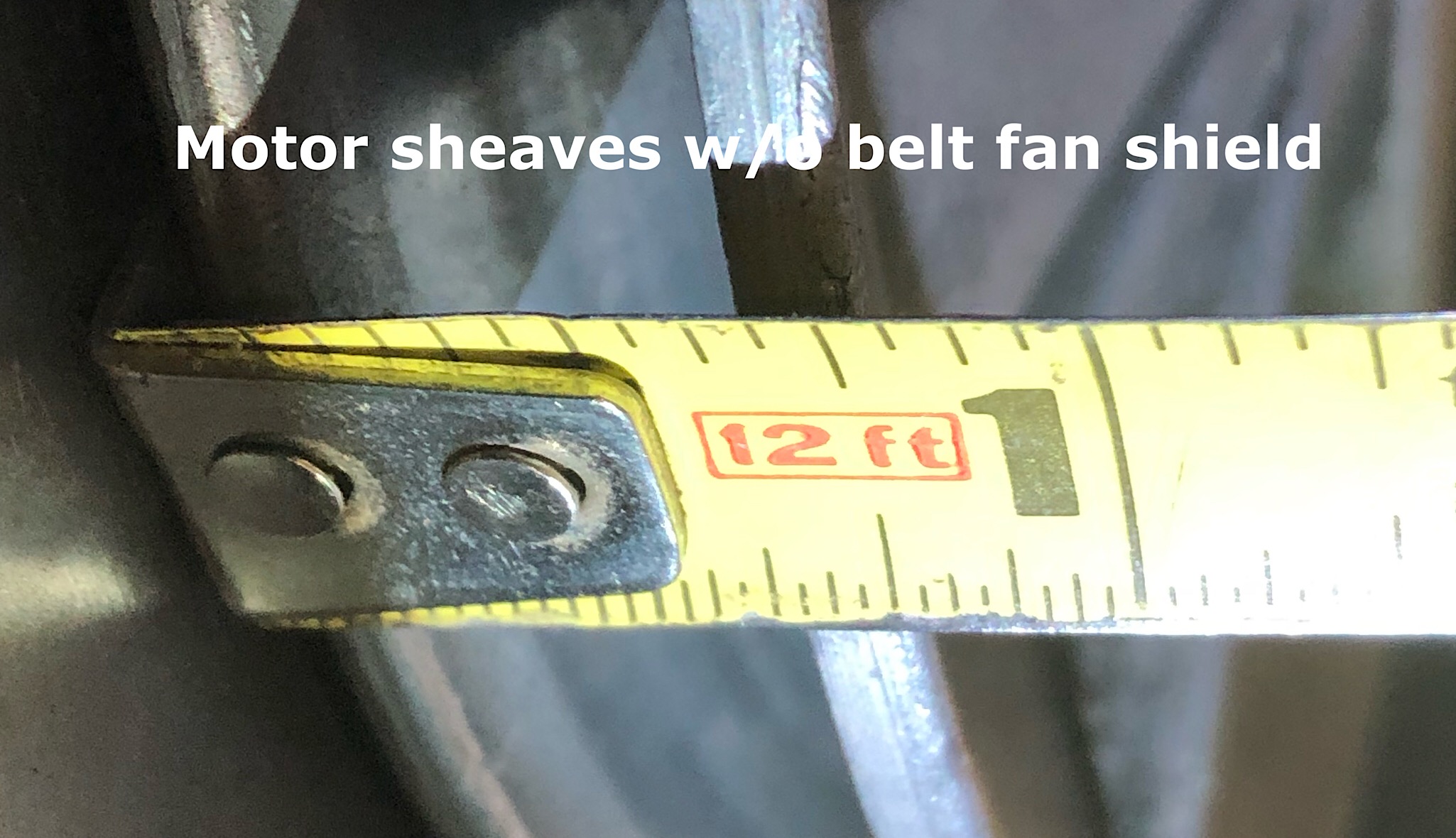

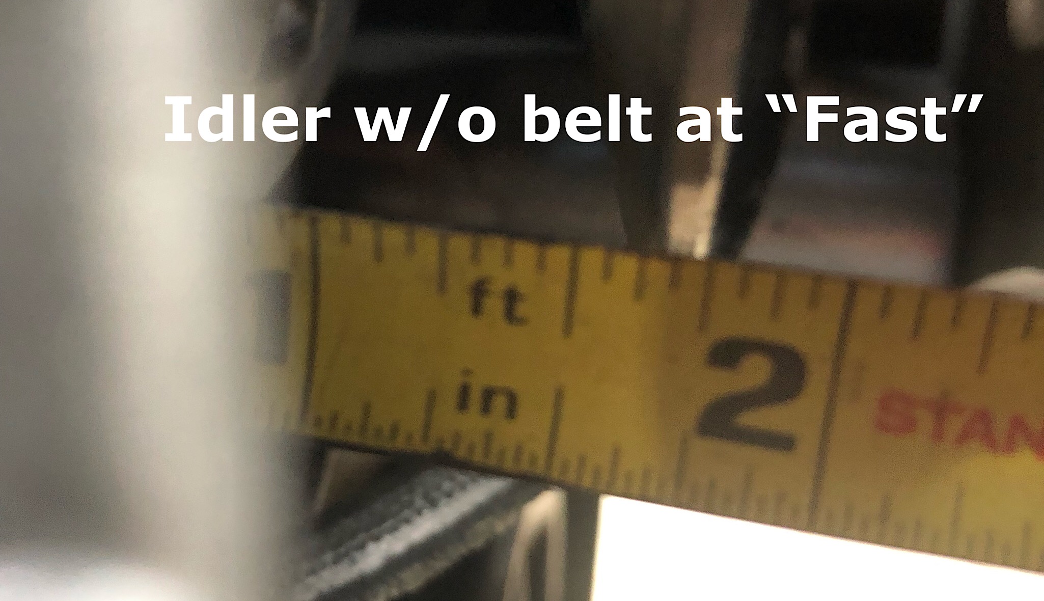

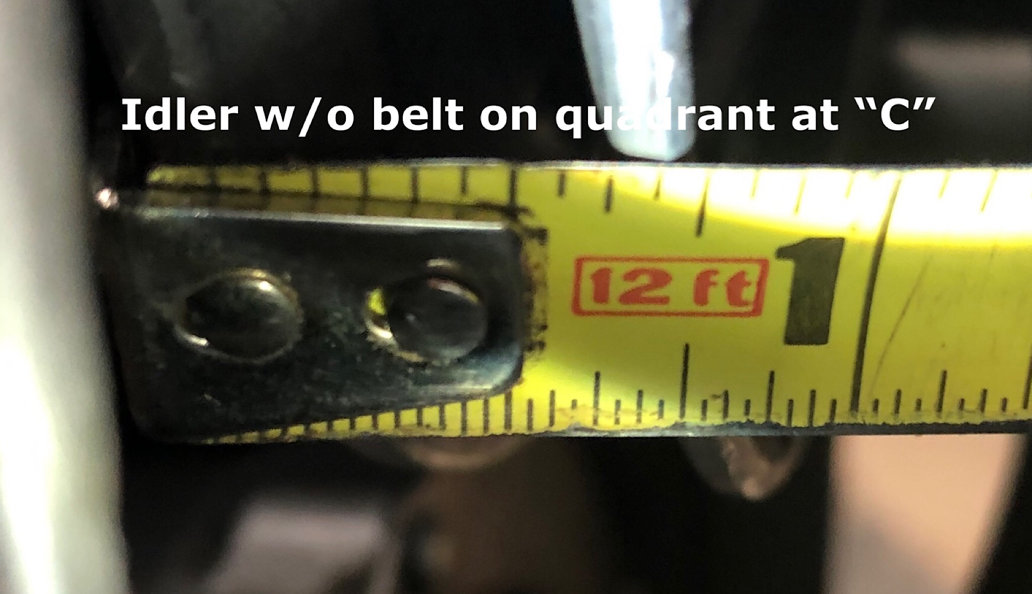

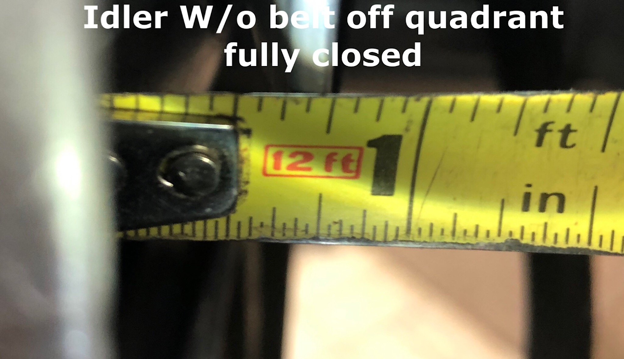

The following pics show the measurements. There are some differences between your figures and mine. I added an extra pic showing the idler sheaves closed when disconnected from the quadrant.
I couldn’t get a pic of the motor sheaves manually separated (two hands and holding the sheaves open and the tape and the camera) but the measurement was 1 1/2”.

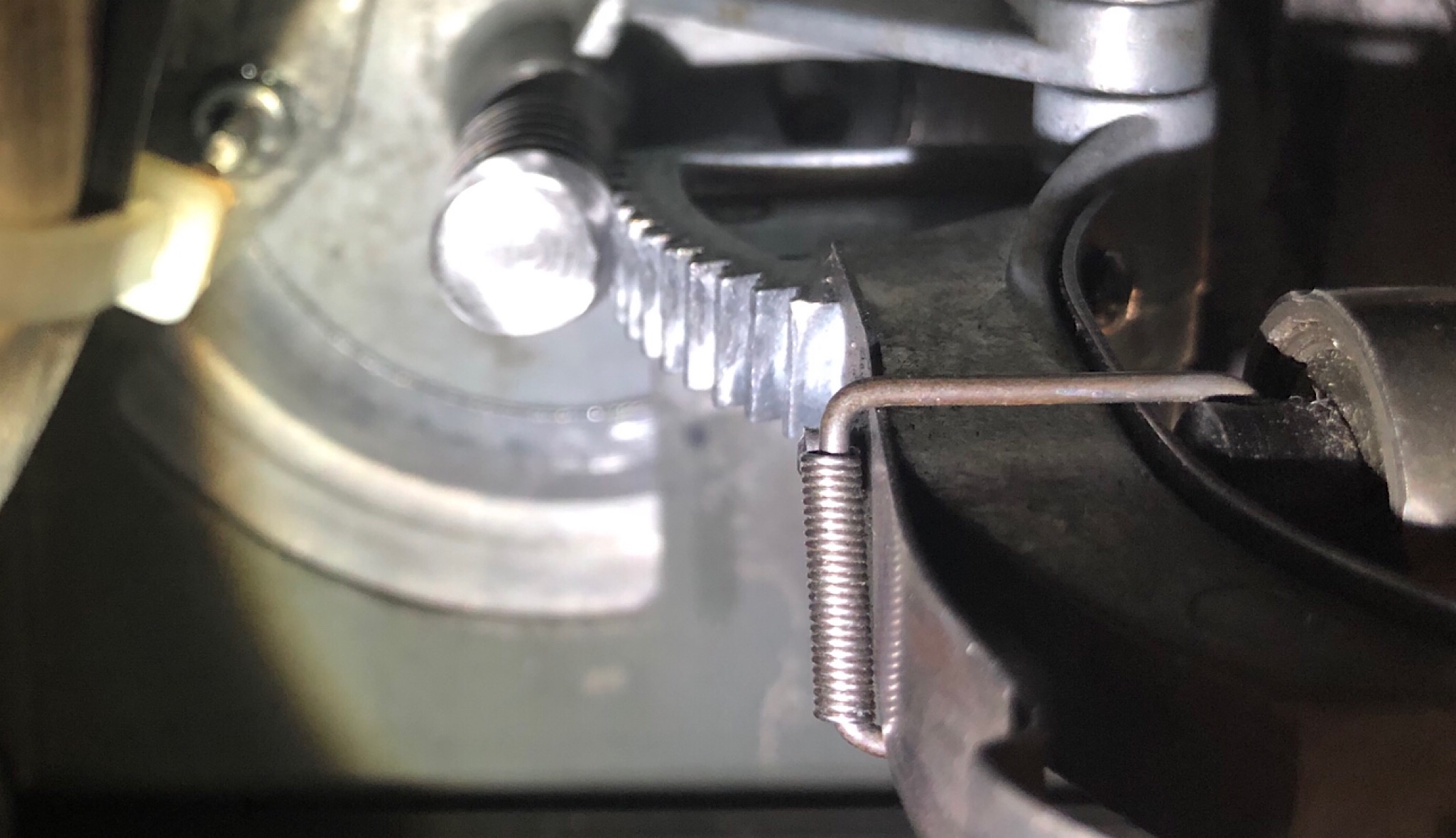

When I was moving the speed dial down toward the low end the system started to bind up at “C”. But while the dial could turn more toward “B” the idler sheaves had already closed. And the loop on the idler bearing became proud of the quadrant spring. This pic shows the quadrant at “C” with the idler loop just resting on the spring. There is virtually no tension here and when the dial is turned toward “B” the loop becomes free. I can move it with my finger nail.

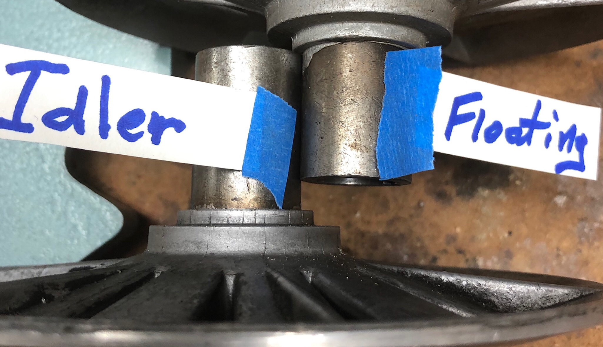

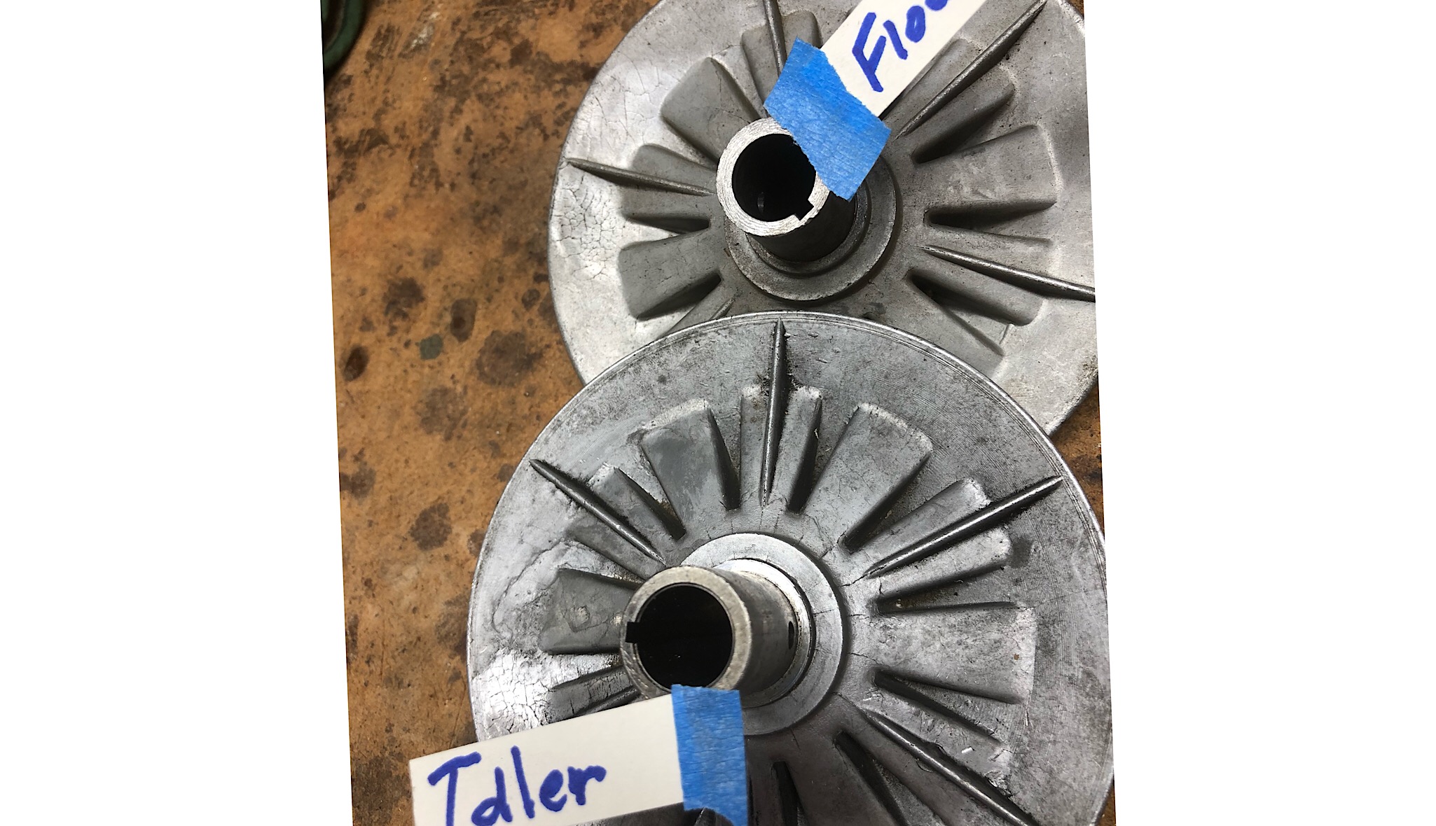

You have an 'idler' sheave installed on the motor shaft instead of a 'floating' sheave.
The 'hub' is about 1/4" shorter on the floating sheave. With the extra 1/4" on the incorrect floating sheave the range of motion is restricted to 1/4" less(grounds out prematurely at "C").
The correct floating sheave hub is about 1" in length from the aluminum casting projection.

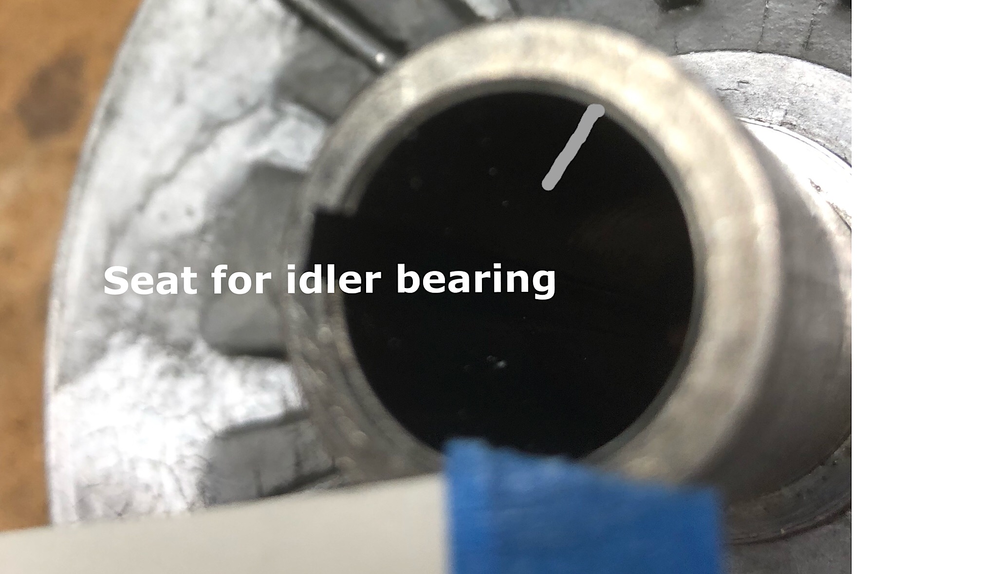

Another difference in the floating/control sheaves is the control sheave has the inset for the button bearing whereas the floating sheave hub is smooth across the end.

Well, the good, the bad and the ugly. JPG is spot on. For whatever reason I had an “idler” sheave on the motor shaft. To add visuals to his observation I have these pics.

An engineering note - When I bought the floating sheave at Shopsmith (I live 20 minutes away) one of their engineers told me that back in the day, when they upgraded their motors and changed from the nut on the end of the motor shaft to the clip, they made two other changes. They increased the shaft diameter by .003” and they increased the length of the stub on the floating sheave by 3/8”. So, an older floating sheave will not fit on the newer shaft and a newer sheave will have a sloppy fit on the older shaft and stop earlier.

Only suggestion I have is to shorten the floating sheave(actually I would shorten the control sheave that is in the pix above[NO BEARING]).
